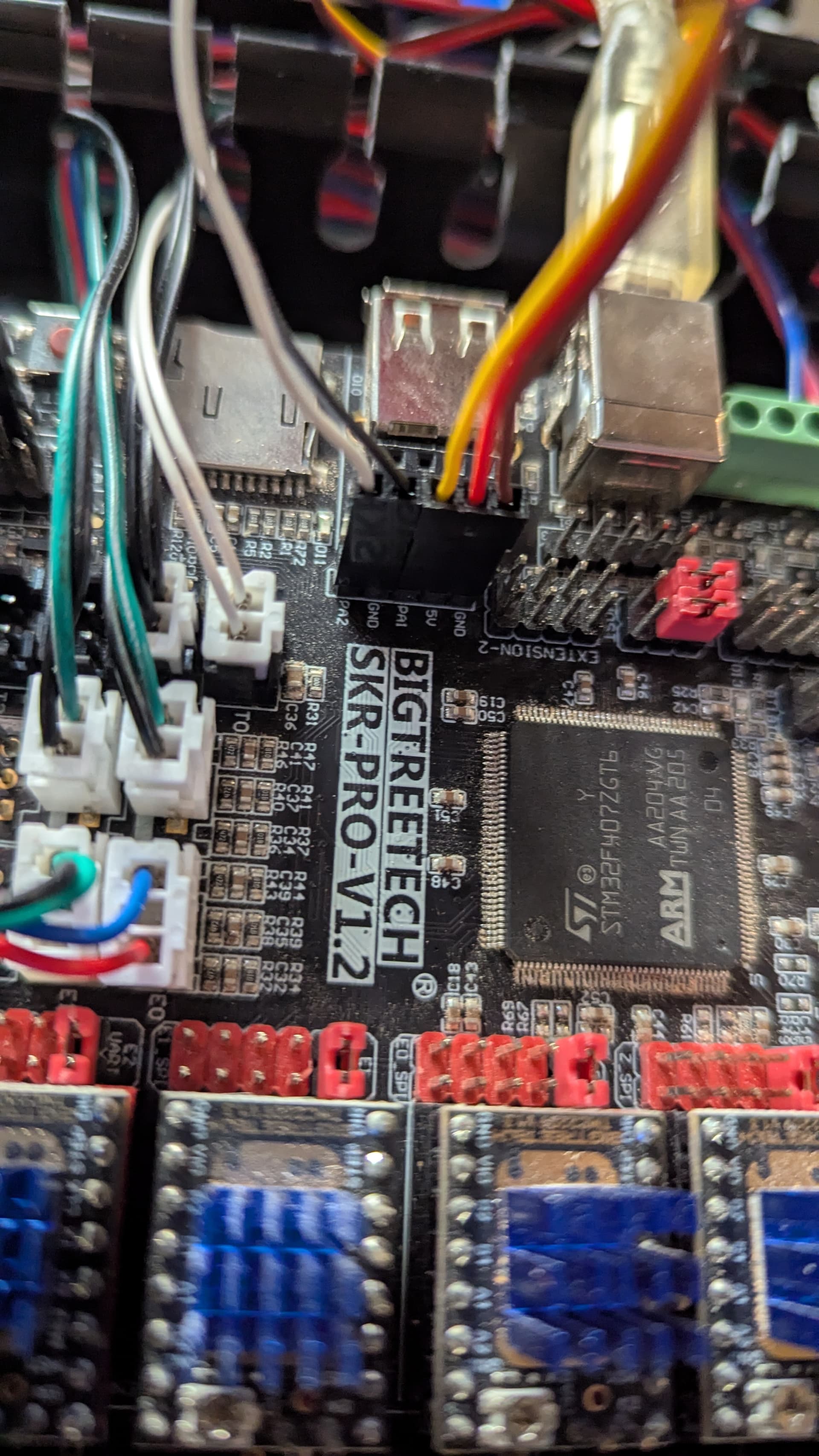

Are you using the bltouch header on the 1.2? I just put a btt microprobe on my new v5 and it works on that header just fine.
White black, yellow. Red,brown. With header labels. I run klipper so the pin labels on the board made it pretty easy to set up.

FYI: without your drive voltage hooked up (12 or 24V), If you power the board with just USB like sometimes we I do to check the firmware version or verify end stops, it will not work on the SKR. The SKR will boot cycle with red light flashing if the BTT microprobe servo is connected. the USB cannot power the servo that pushes the pin in and out for initialization. I thought the board was toast and then that the probe was bad, but it was just browning out because USB can’t push enough amperage to initialize the probe. Not to worry… it is a feature.
