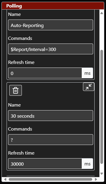

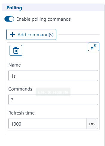

What do you have the polling commands set to? I can see where if you’re sending “?” commands too frequently that could maybe cause issues.
This is what I’m using (auto-reporting every 300 ms with a 30 second manual check just in case):

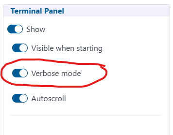

And make sure you don’t have logging set to debug or verbose. That will send way more messages than you need
Where is this located? On UI2 it was on the main screen, but I am not sure where it is in UI3. I looked for it a little the other day, but did not see it.
Settings → ESP3D Interface
Here it is
Could this be an issue?
Could be. Not sure exactly what it does, but if you aren’t currently diagnosing a problem, anything verbose is probably unnecessary.
When it starts to lag, you can also click the little arrow at the top right of the Terminal panel and Clear the terminal.
I don’t think the terminal does any kind of rolling off the back end, so if it’s running for a while, they are likely just piling up
I think Verbose mode for the Terminal is just echoing all the commands that are already being sent.
1 second interval for polling should be ok. You could try auto reporting instead to see if that makes a difference. This means that FluidNC outputs updates when there is something to update at a set max rate as those things happen. Otherwise, you’re interrupting it. At least that’s my understanding.
