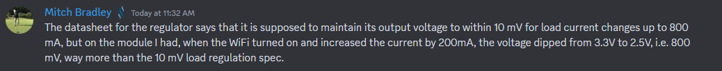

If it looks like you are getting 3.3V on the pin, I remember seeing Mitch tell someone that he had to solder a small capacitor between 3.3V and GND on his to stabilize the voltage.
If there’s no voltage on that pin, then maybe the regulator got fried?
I did find the reference from when Mitch was helping someone with a brownout detector problem…

This is the most likely reason. 3V3 stability is really important for the ESP-32.
This is the test, though to really see the problem may need a scope not a DMM. For a scope, you set it to trigger when the 3V3 drops below a a threshold, say 3.0V and watch what it does. With a DMM you have to get a little lucky to see the voltage drop.
The screenshots note this, anytime there’s a significant inrush you can get a brownout if the 3V3 regulator can’t keep up with the inrush. Mitch fixed the one discussed below with a cap, but that may have been a bad (crappy or improperly substituted part) or broken cap or cold solder, etc.

Thanks for posting. I tried a 47 micro F and I was still getting the brownout. I then used the next size I had on hand, 100 micro F between the 3.3v and GND pins and my brownout error went away. This was just a quick test with the ESP connected via USB only. I haven’t tried it in the jackpot with the cap yet. I hope to later this afternoon. I do believe I have 3.9.1 installed and will verify when I try it in the jackpot.

Never mind. I soldered the 100 micro F cap between the 3.3v and GND pins, retried it on the computer USB and opened up fluidterm - still had the brownout message. Sorry. I too was hoping I could save my ESP as a spare.
