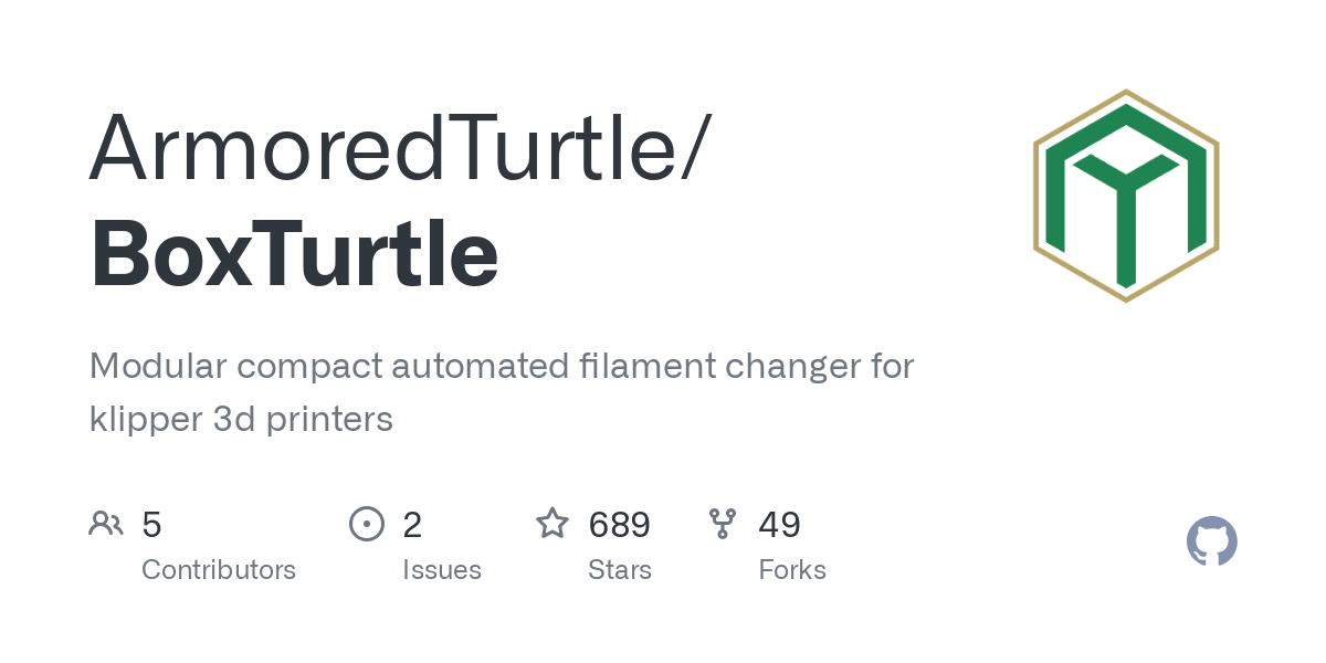

At that point I ran across the ArmoredTurtle/BoxTurtle project. It has 4 lanes in the base configuration, but each lane is fully independent with its own drive (and no selector) and powered respoolers. It is one of the more expensive (4 lane) options for a few reasons, but I reasoned many would be mitigated by only populating 2-lanes and re-purposing a controller.
It turns out that the components for lanes 3&4 are inconsequential and I’ll probably end up with the recommended special-built controller anyway, so I am knee-deep into a 4-lane build.
Impressions so far:
  • I started skeptical, and printed some of the parts to make sure I was going to have adequate quality / tolerance for the build and was very impressed with the the part design. The files are per-orientated and have supports modeled in where necessary. They are well thought out and remove easily.
  • The assembly instructions are fantastic.
  • The Github repository for the 3D printed parts is a bit hard to navigate, but they have an amazing “configurator” tool that walks you through some questions and then creates a zip file with all the necessary .STL files and no extra “optional” stuff to confuse you.
  • Part names are clear, indicating the color (for a base/accent color build) and quantity of instances required.

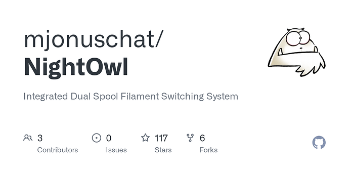

Running down that rabbit-hole, I stumbled across the NightOwl which is as close to what I originally set out to build as I could imagine.
If I wasn’t so far down the path I would probably do the NightOwl, but now I’ll probably finish the BoxTurtle first and build that too for a comparison. My MP3DP-V2 is still working fine and had a Klipper conversion anyway…

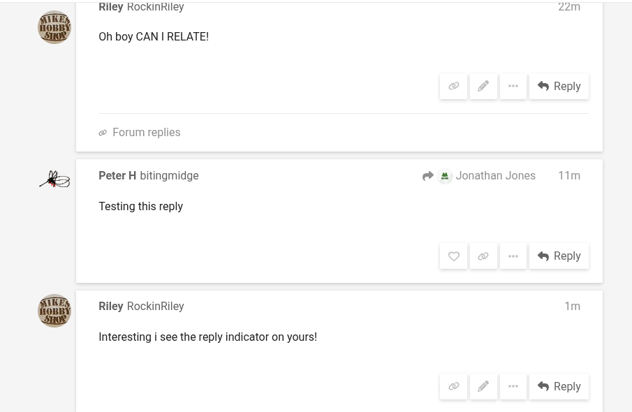

Oh boy CAN I RELATE!
Testing this reply
Interesting i see the reply indicator on yours!
because
