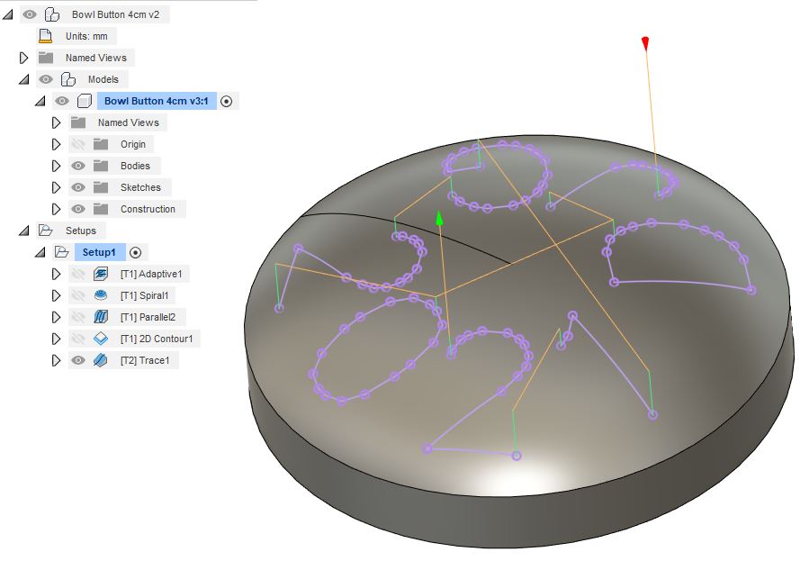

I then switched from Fusion 360 Design mode to Manufacturing mode. Here I did a setup that did three things: (1) it defined my stock to be 10mm x 10mm larger then my model, (2) it put the origin on the top of the stock in the far left/front corner, and (3) it let me tell F360 to considered my model when it was generating 3D toolpaths.

Finally I told F360 to do a Trace milling operation. A trace operation follows a path in 3D so it was perfect to engrave the text on the surface of the dome. To define the operation I selected the 7 paths that made up the text (remember I exploded the text into paths) and told it to offset the tool by -0.75mm axially so that it cut 0.75mm into the dome.

All in all it was a fun little project that taught me the power of F360’s 3D milling operations and tested the Flyfisher604 PP’s ability to scale feedrates . When I reviewed the GCode generated by the PP I could clearly see the feedrates scaled many times to keep Z within its defined limits. During the cut I saw no issues. All around I’m happy with the results and the tools.
