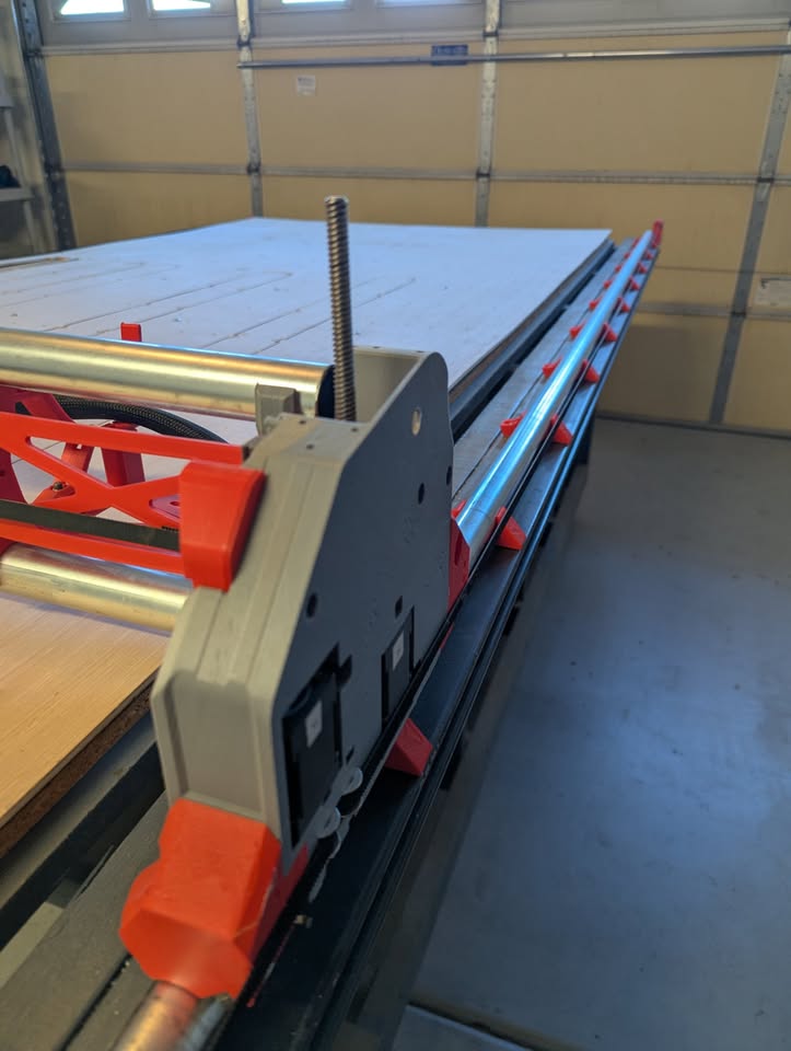

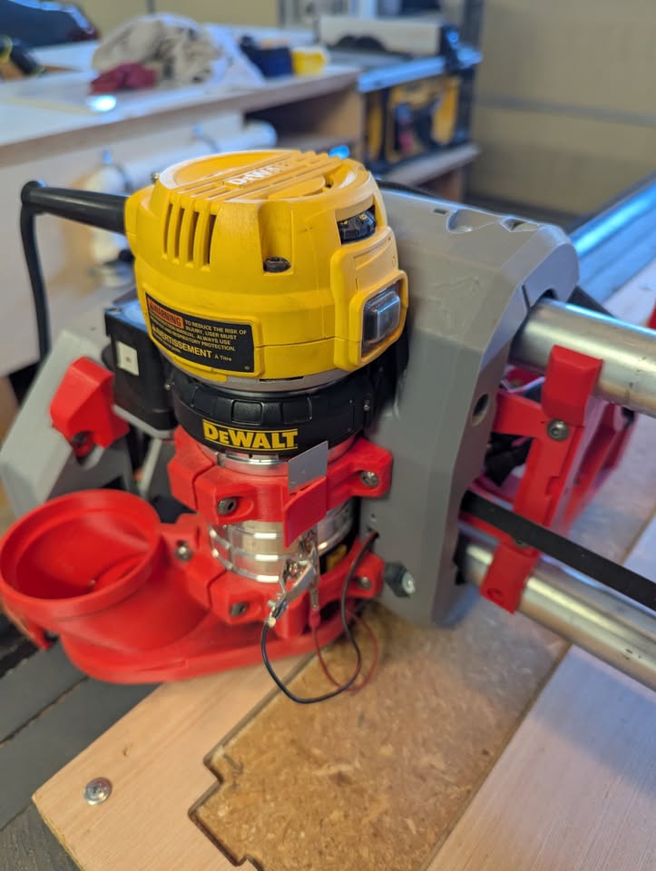

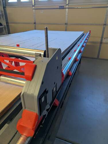

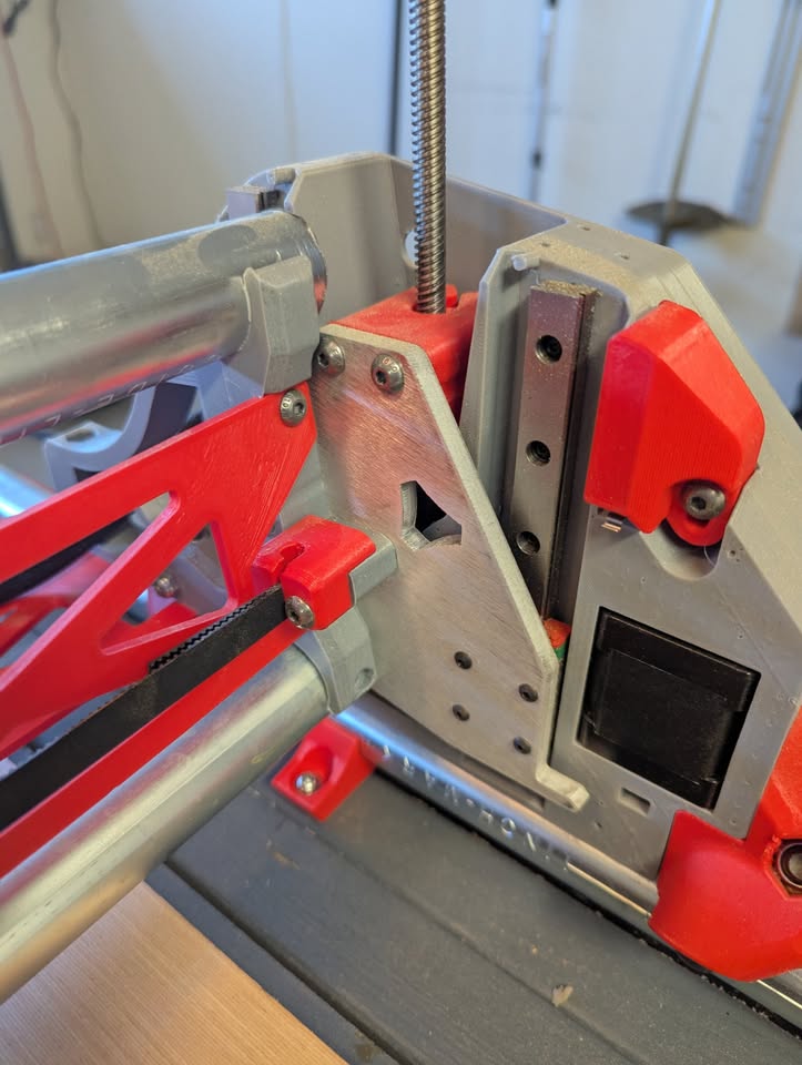

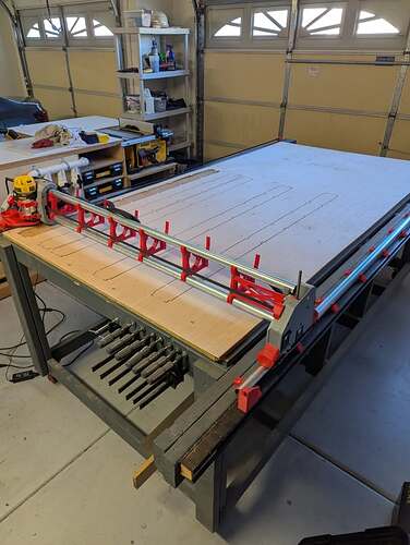

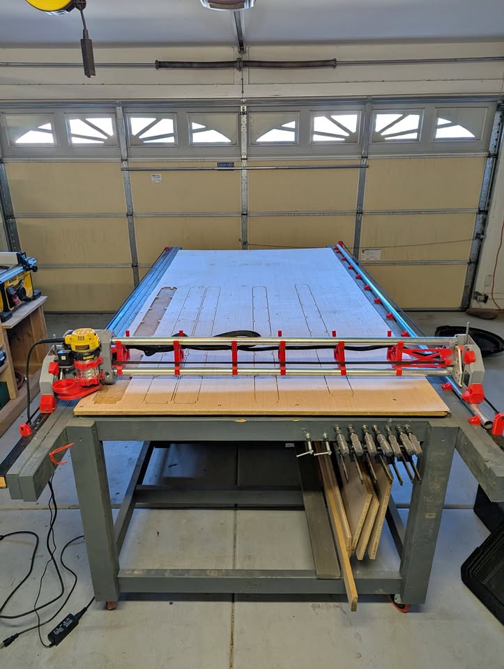

Here’s some pictures of it:
it seems the original owner started to make the struts but ran into an issue and stopped there.
Machine Details
  • Model: LowRider v4
  • Working area: ~4’×8’
  • Controller: Original Jackpot (fully wired and functional)
  • Motion: Belt-driven X/Y, leadscrew Z
  • Router: DeWalt trim router
  • Frame: Steel EMT Conduit + printed LR4 parts
  • Table: Dedicated CNC table included
Any ideas on how I should proceed?

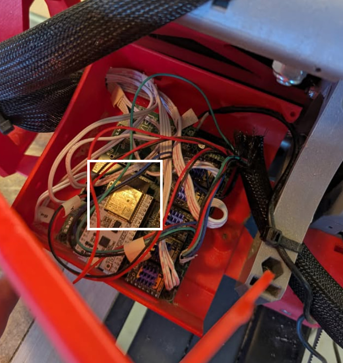

That is defined in the yaml configuration file on the Jackpot board.

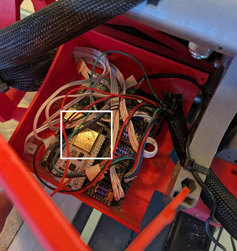

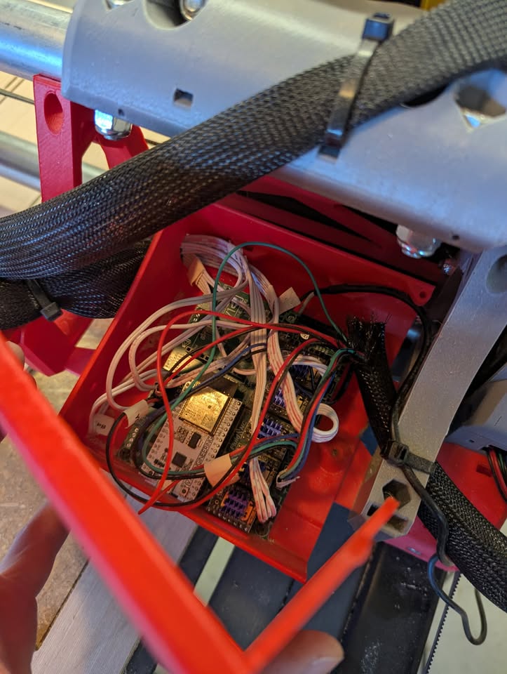

One recommendation would be to clean up the wiring around the board. If at all possible have the wires routed around the outside of the board and not over the ESP board since I’ve seen it suggested here in the past. It will help with the WiFi signal.

The part I’m not sure about here is how long your strut plates need to be. Normally, you use the values that came out of the calculator but we don’t seem to know the exact values used. It sounds like you can measure it but I’ll leave that to someone else.
This is a Jackpot controller. I’ll note that you’ll want to cleanup the wiring so that there are no wires over the area in the rectangle. Otherwise, you can run into wireless signal issues.

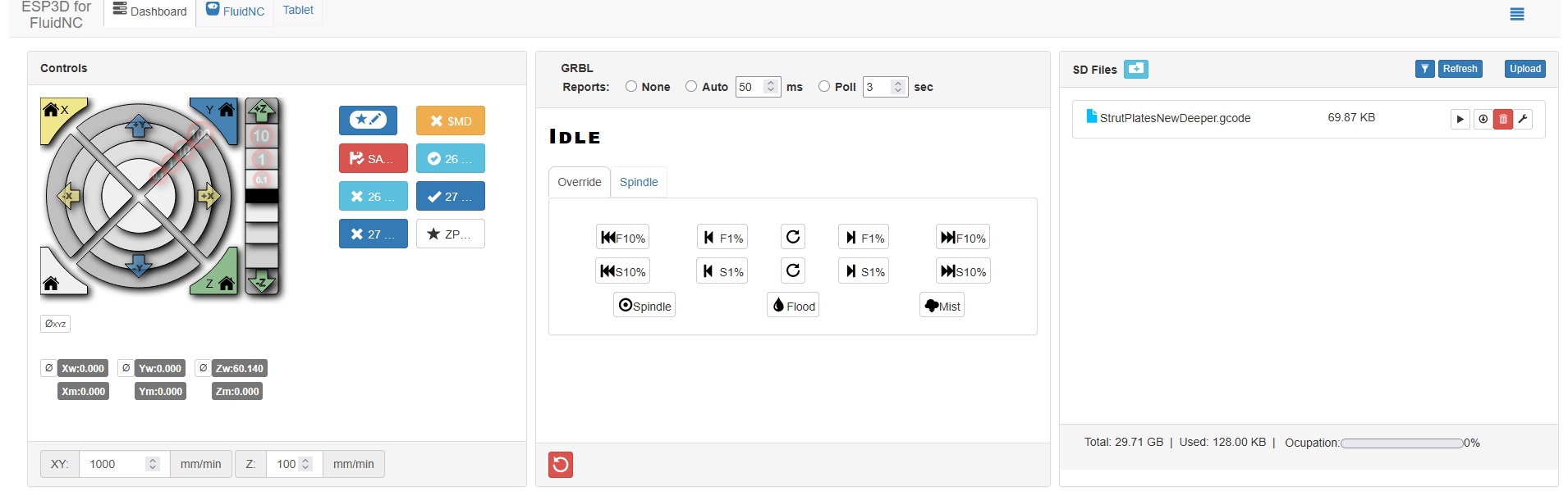

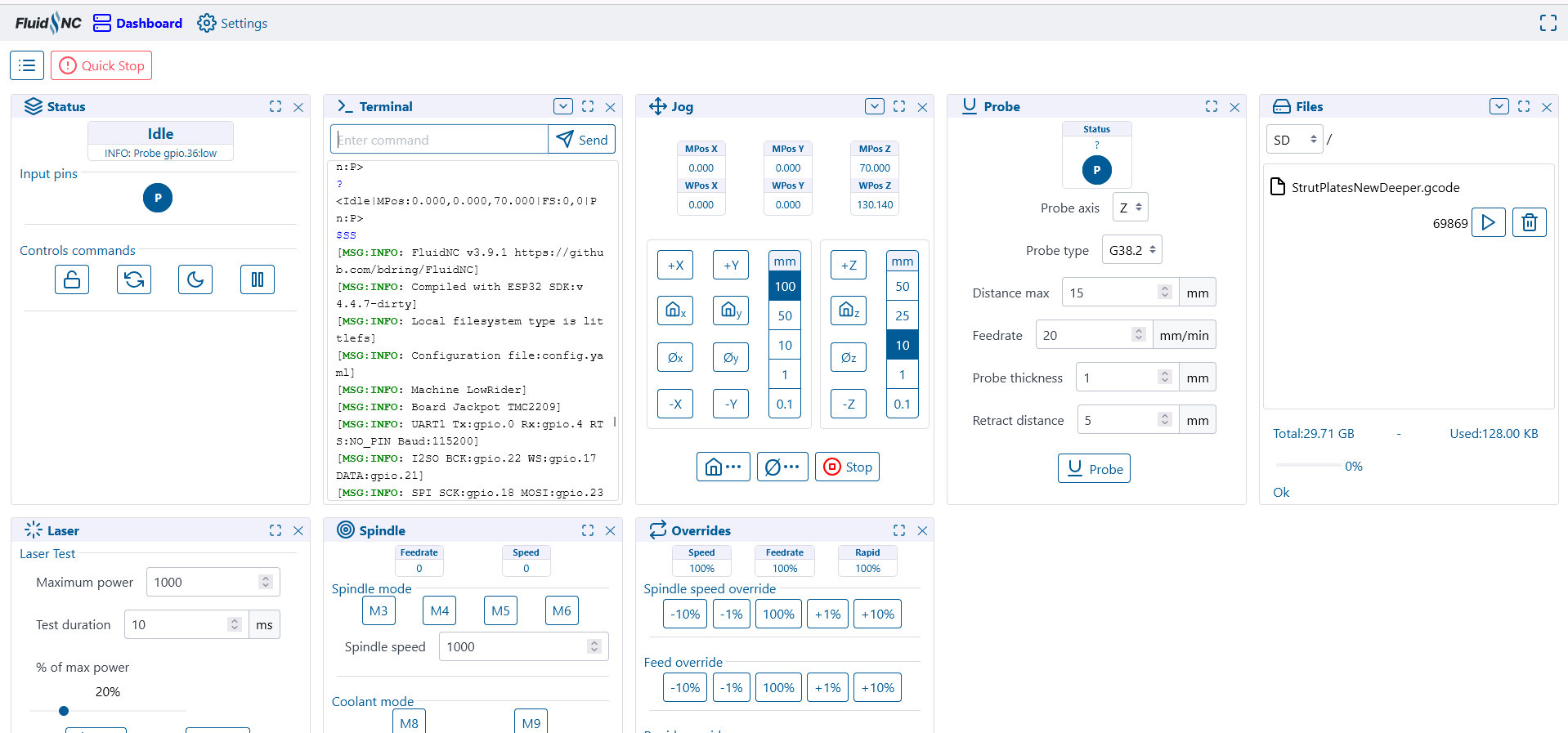

How are you moving things around? Typically, you would use the FluidNC WebUI. Can you post a screenshot?
This is absolutely true, you need to know the extent of your machine and not run outside of it!
I’m using the FluidNC WebUI to move things around very slowly. Here’s a screenshot:

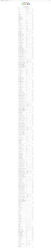

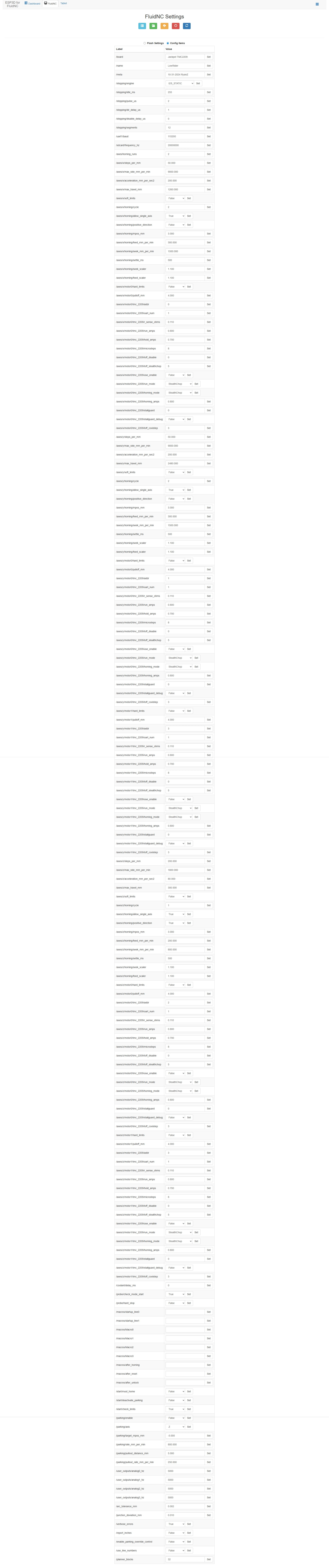

Here’s a copy of the “Config Items” within FluidNC if that helps at all:
I’ll get on cleaning up the wires for sure!

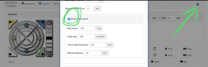

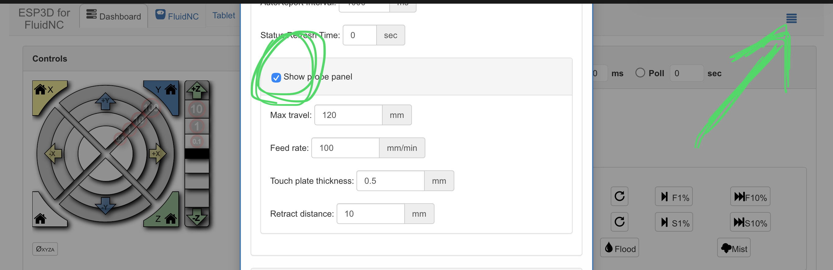

You are using WebUI v2. I know it has an option in there but I haven’t used v2 in a long time. You can do it in WebUI v3 as well but I never use it since I always just include it in the gcode.
You could consider updating the WebUI. We should also see what version of FluidNC is installed. You can get those details by running $SS in the terminal.
Here’s the link to download the newest version of WebUI V3:
Click the menu, preferences, Show Probe panel.

Thank you for this! I looked at this before I updated to V3 of the Web and it indeed was there. I did not test it as I was upgrading to the new web interface.
I believe I updated to V3, Thank you!
