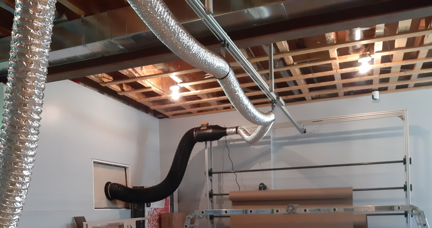

So I finally got around to building an exhaust system for my laser cutter that’s better than a pedestal fan in front of a window with a cardboard box on the back attached to some flex duct lying on the end of the laser cutter table; sometimes assisted with a central vac hose.
One of the things I didn’t like about this setup (aside from it only really working for small area jobs where the duct inlet was nearby enough) was the noise.

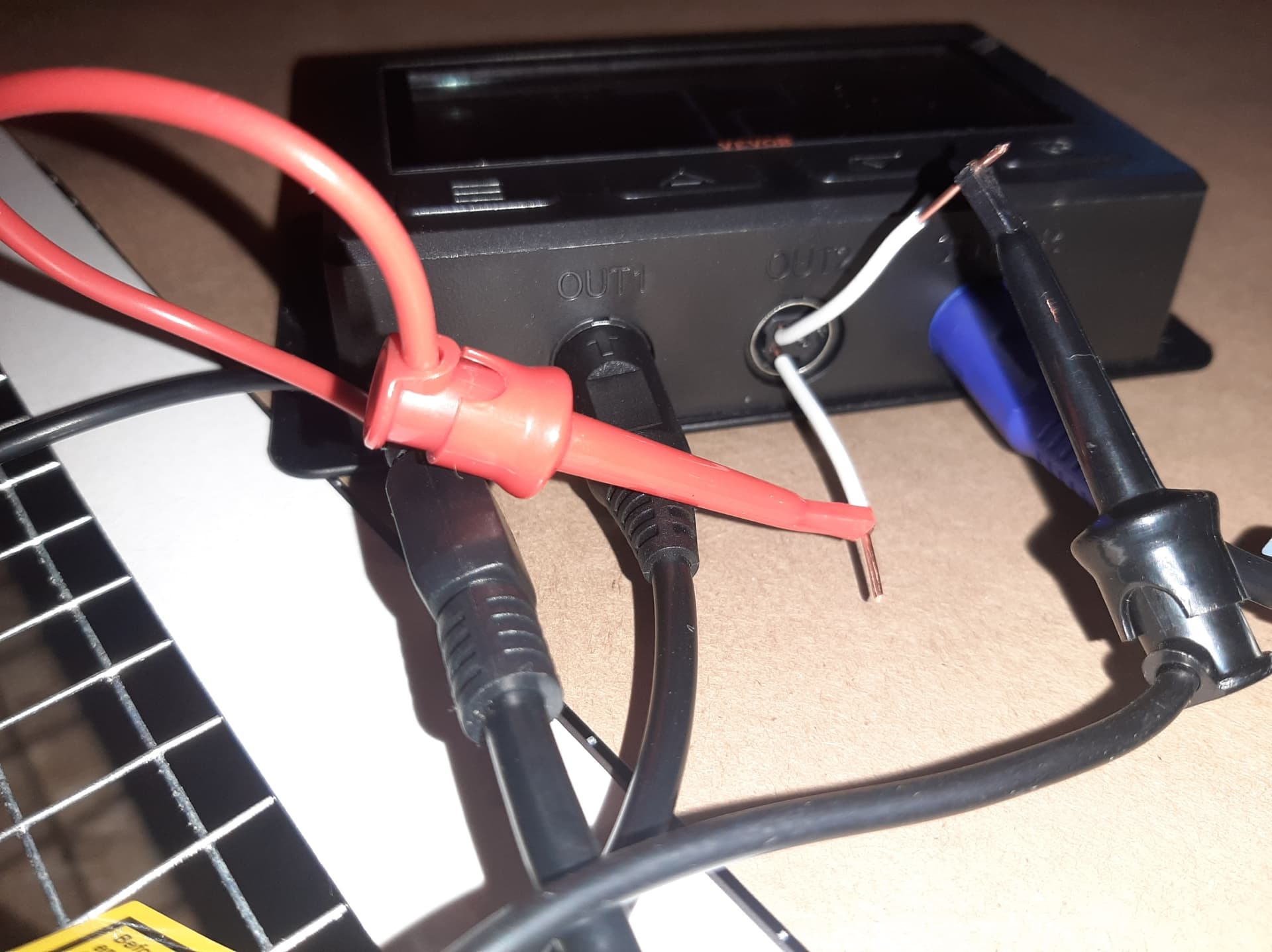

The EC version, unlike the AC version, comes with a controller to control various fan triggers like temperature (measured by a probe that connects to the controller) and speed settings. The fan connects to the controller with a male plug into a funky three pin female jack (KPJX-PM-3S-S or KPJX-PM-3S) on the controller.

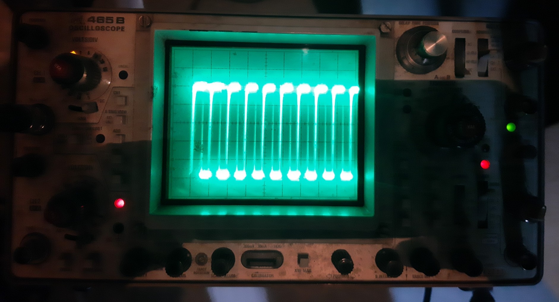

Scoping the output of the controller (conveniently using the second fan port so that the controller can be powered by the fan using the first fan port) – black ground, red signal:
…the controller outputs a ~20 kHz 5 VDC PWM signal to control the fan (50% fan speed shown, 1V/div, 50μs/div):
Excellent. Not only is the fan already pretty decently quiet (especially with the exhaust ducted to outside), we can control it with G code to start and stop with the job, which I wouldn’t do manually if I had to walk 40 feet back and then forth around the laser cutter table.
