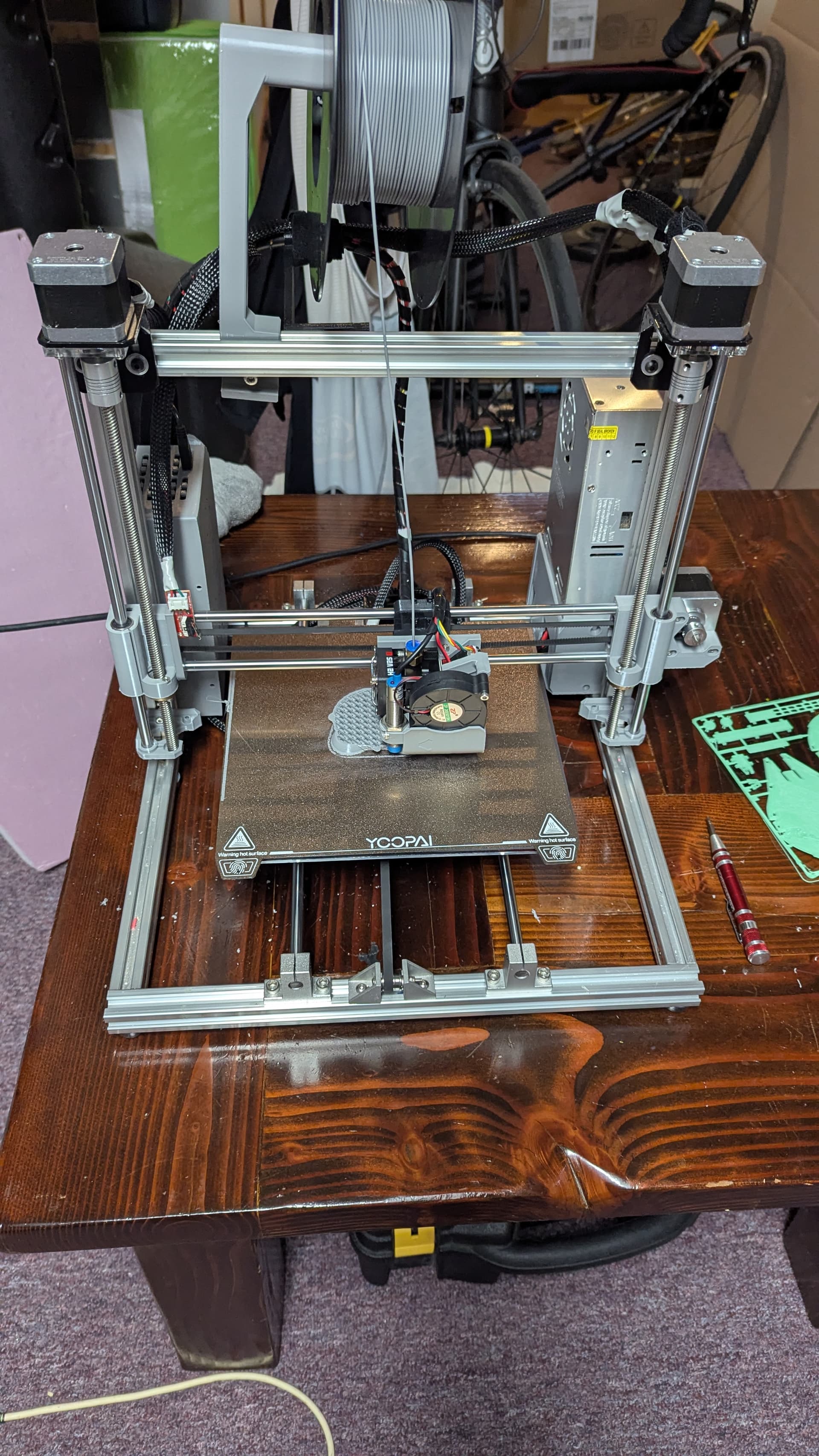

I bought an ender magnetic bed and new 8 mm z lead screws for it and found x axis stls that dont need the 5mm rod, remixed the h2v2s mount from the v5 for it and put an eddy current sensor on it and a new webcam from work appreciation points. All grey parts on it were printed on the neptune I picked up as a mechanic special recently while everything was belly up.
I have been trying to get a kindle fire in kiosk mode to run klipper screen for it, but still no joy so it runs off my phone from the web page and accepts prints directly from orca. It prints kinda slow, but she’s a “clean one owner” now. Kinda cool.
4 printers now… My family thinks i have a problem.
