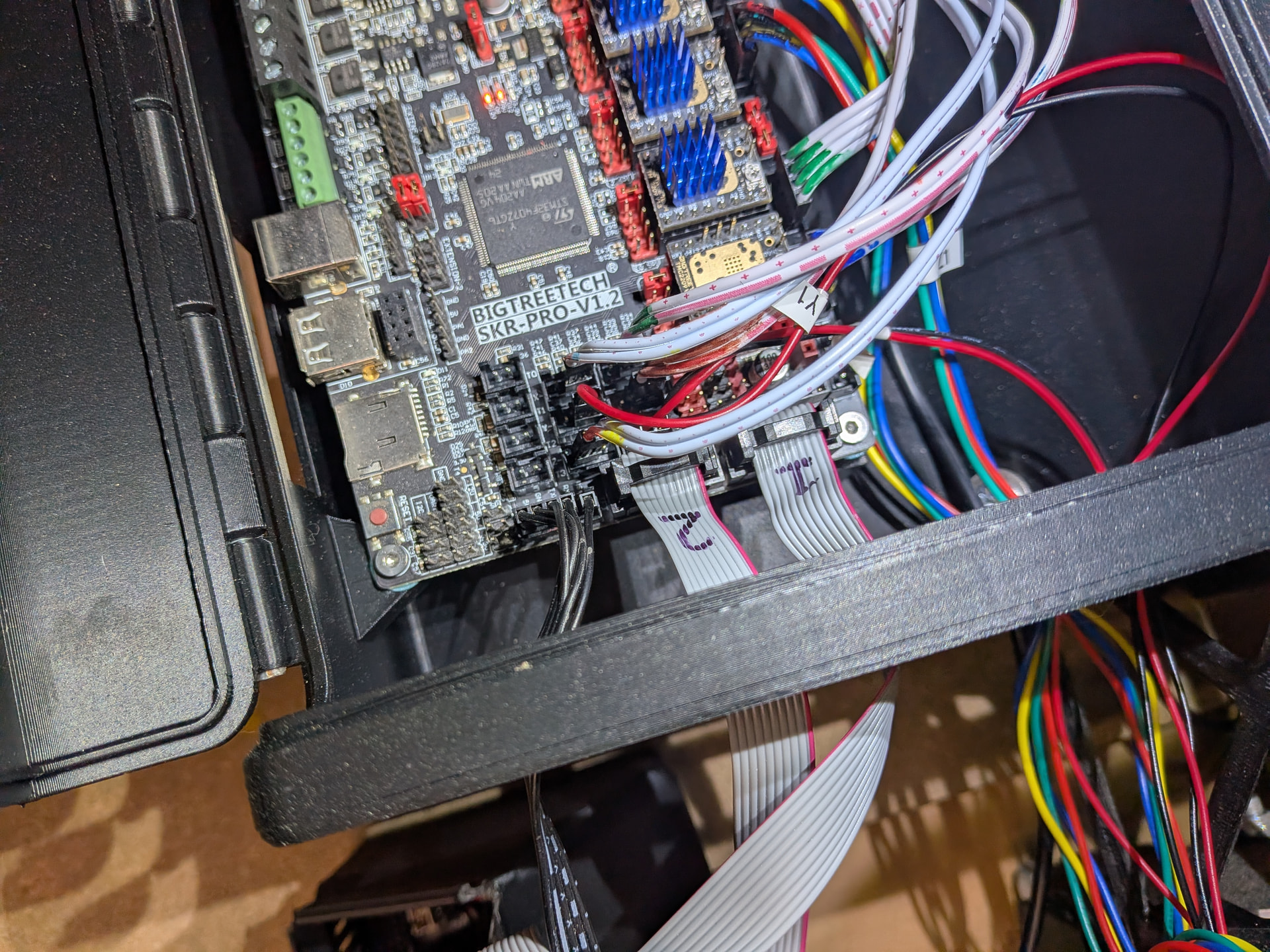

Blank screen
I’ve disassembled my TFT and SKR to put into a new case. When I’ve reconnected everything the lights on the board and the back of the screen come on, but there’s no picture. I’ve double checked the connections and all looks okay. Does anyone have any ideas? Much appreciated!

Try disconnecting the grey cables from the back of the display and then power cycling.
Does the display show a logo when powered up? Then what happens?
Can you hold in the button and change the display to TFT mode?
Power cycle and repeat the observations.
Hey Jim, thanks for the suggestions, I’ll try that and see what happens :+1:
