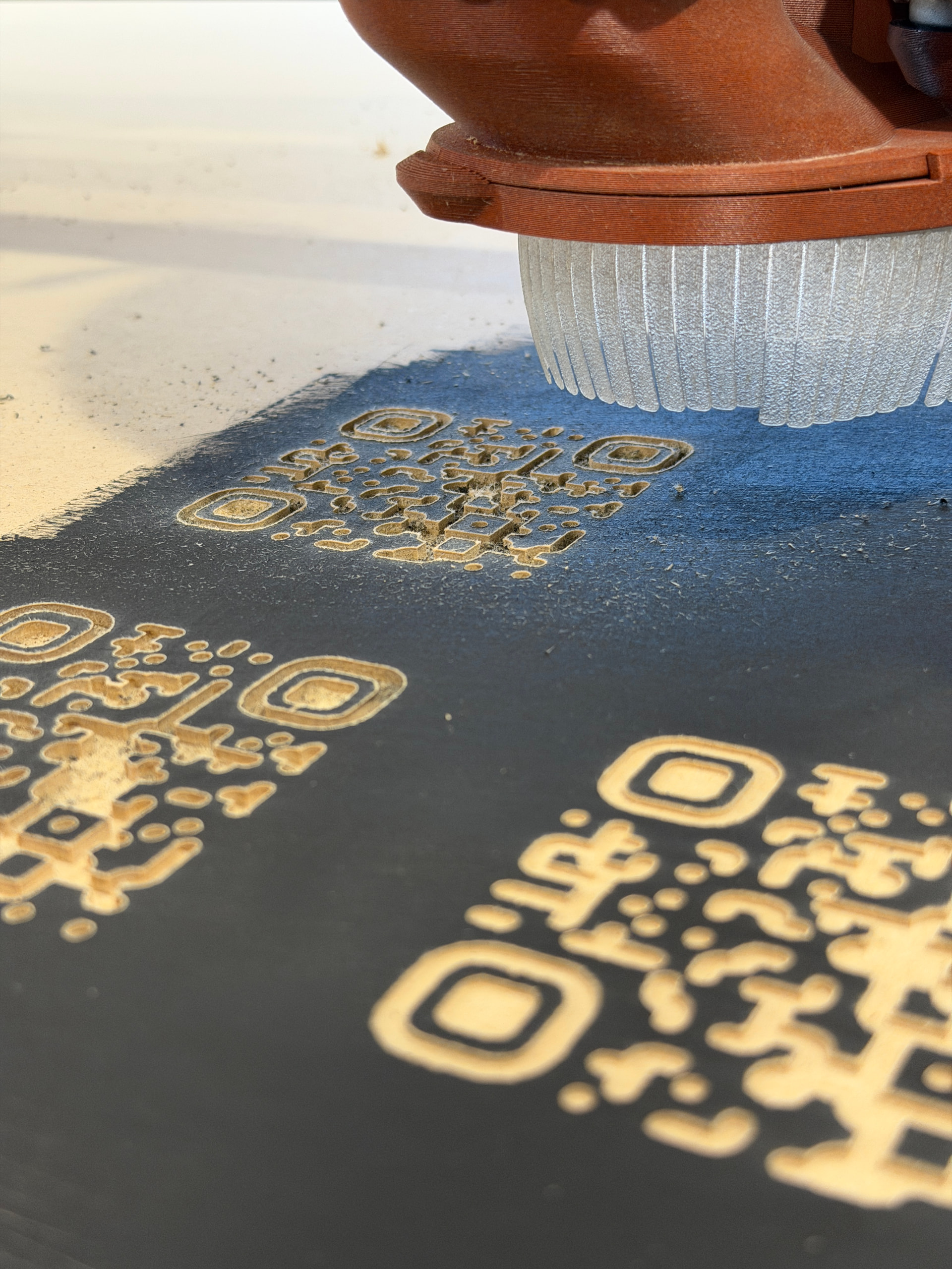

Currently the 3mm spiral carbide bit tends to tear the MDF tests upward.
My objective is to prefinish some wood (say, airbrushing TransFast dyes on Maple) and then CNC a QR code out of it.
What would be a good bit for this? I’m OK with paying for high quality stuff. (bonus: feed/speed tips to avoid burning the wood)
Above: Maple I’d like to dye & carve a QRCode & logo into
Above: MDF tests w/ black gesso. The cleaner ones were lightly sanded to remove fuzzies.
You should use a down cut bit if you dont want the skin peels
