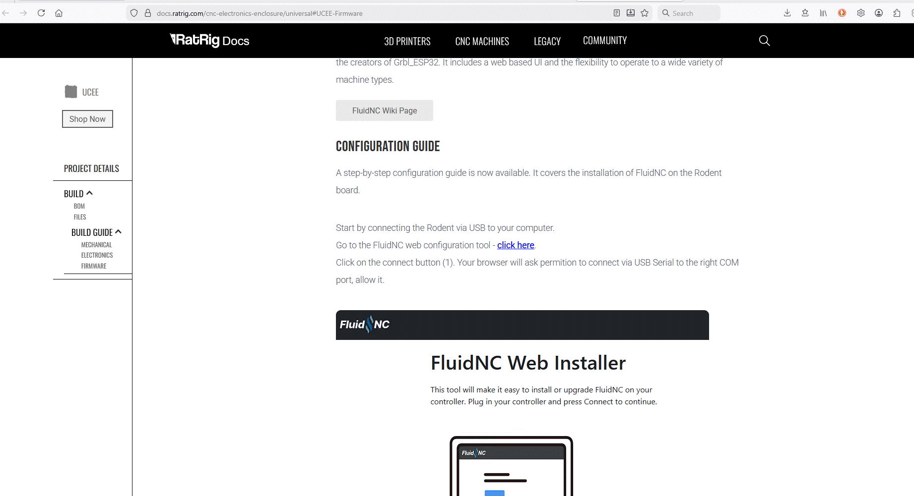

Hello, I’m new to CNC and don’t really understand firmware, codes, etc. Can someone help me get my Ratrig Stronghold One up and running .
I bought it from an authorized dealer, andThe manager told me that I was just assembling it and it was working, but as it turned out, it still needed to be flashed and calibrated. There is very little information about it on the Internet, so I ask for help on the forums, their Discord thread is not very active on this topic, I am ready to pay someone to set everything up for me remotely .

Thank you for responding so quickly. This is the first forum where I received an answer so quickly. I didn’t create a new thread because I was looking for information about my controller and decided to ask in this thread. But if needed, I’ll create a new thread.
There is a fairly detailed instruction guide on the Rat Rig website. Select the FluidNC option for your Rodent controller
Link:
Screenshot:
