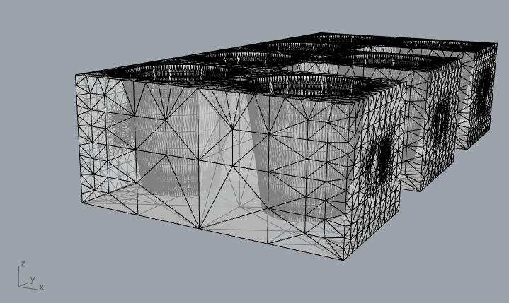

I have made an STL with one hole.

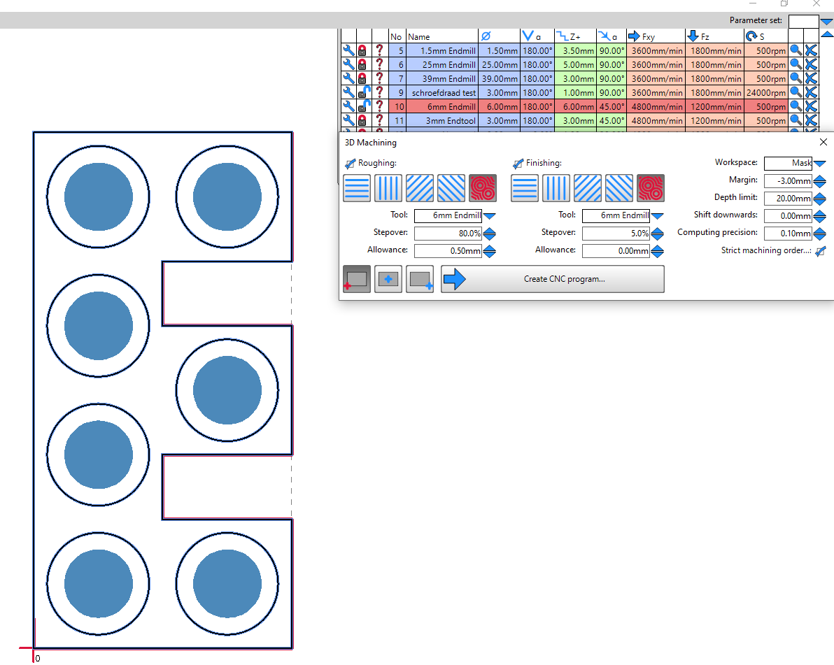

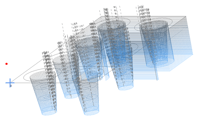

I do want to do the same in V12,070A, but there is a weard thing happening.
I used this mask
afbeelding
this stl (ghosted view)
these settings
and this happens. see the rectangeler shape
I suppose there is a failure in the program

I tried out both linear and waterline and waterline is by far the best result. Both take about the same time, but the finish of waterline is pretty good while linear is missing some detail.
I don’t think Mask is the issue. I tried all sorts of masks and could not get Estlcam to make paths for anything but the unmasked areas. I don’t know squat about STL’s, but where did that straight walled hole (upper right) come from? Have you tired masking all but the good holes (bottom left)?

I can send you the stl and the mask so you can try yourself
I find it strange that a part of the mask has the vertical walls
