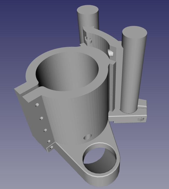

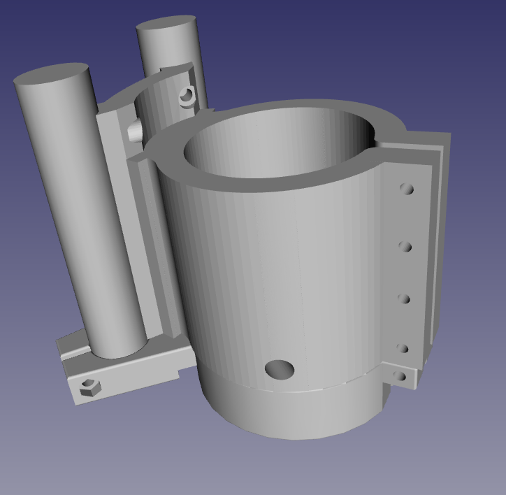

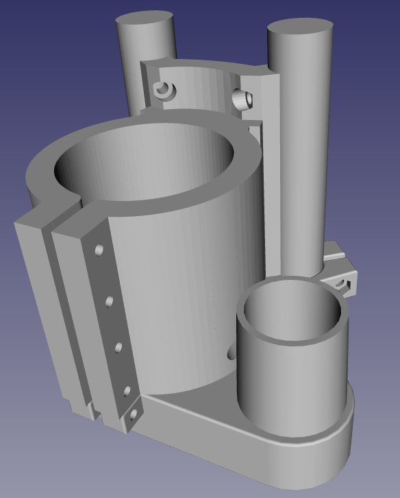

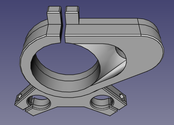

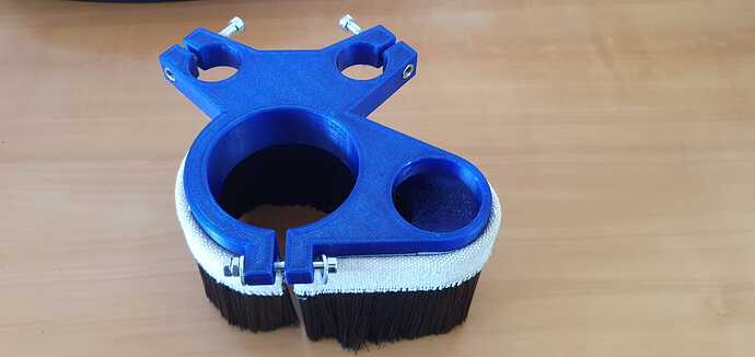

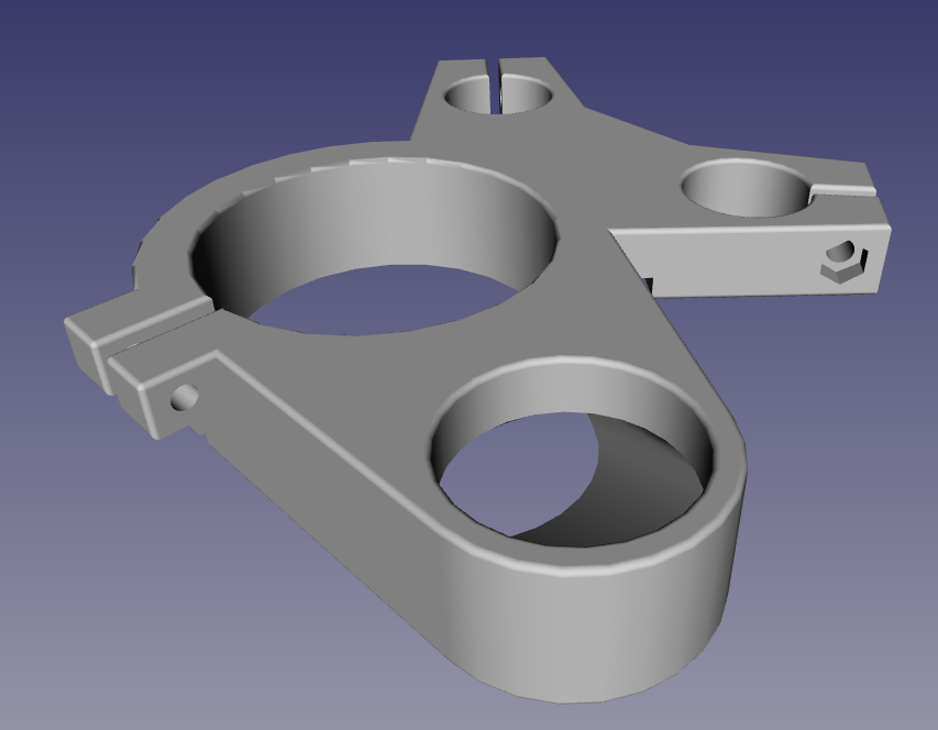

I have created a new dust collector last week because my garage - incl. my motorbikes - are really (!) “powdered”, based on the last 2 months working with wood.

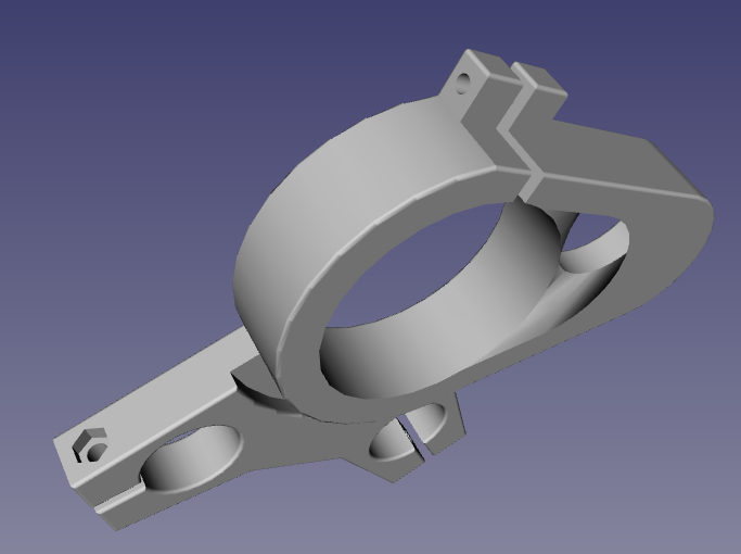

So based on my Makita router holder
and my Z-axis-stabilizer

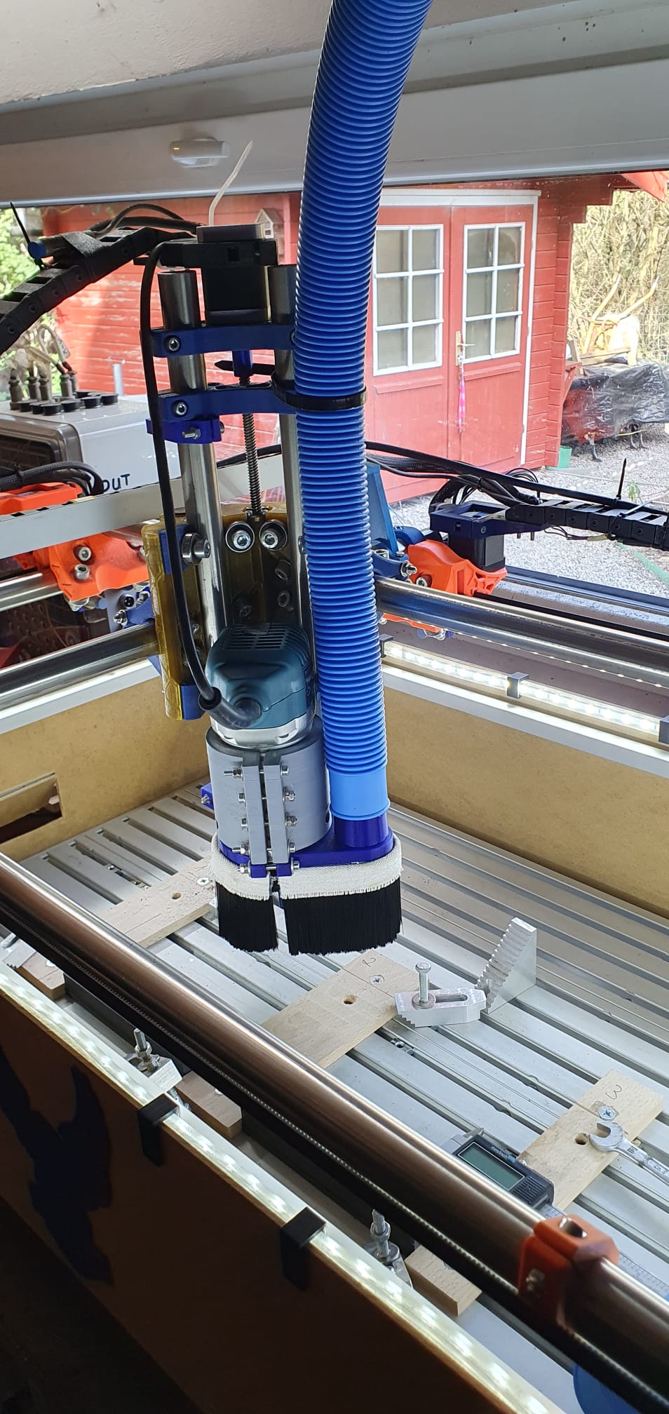

I have added a dust collector.
To be honest, I haven’t tested it because it’s quite new. I will install it within the next days.
The “hole” for the dust tube I have created to be used with adapters, so you can easily add whatever adapter you want.
I will add an adapter for a Kärcher vacuum cleaner which has a 17,5 mm tube.
Don’t know, if that fits your requirements.

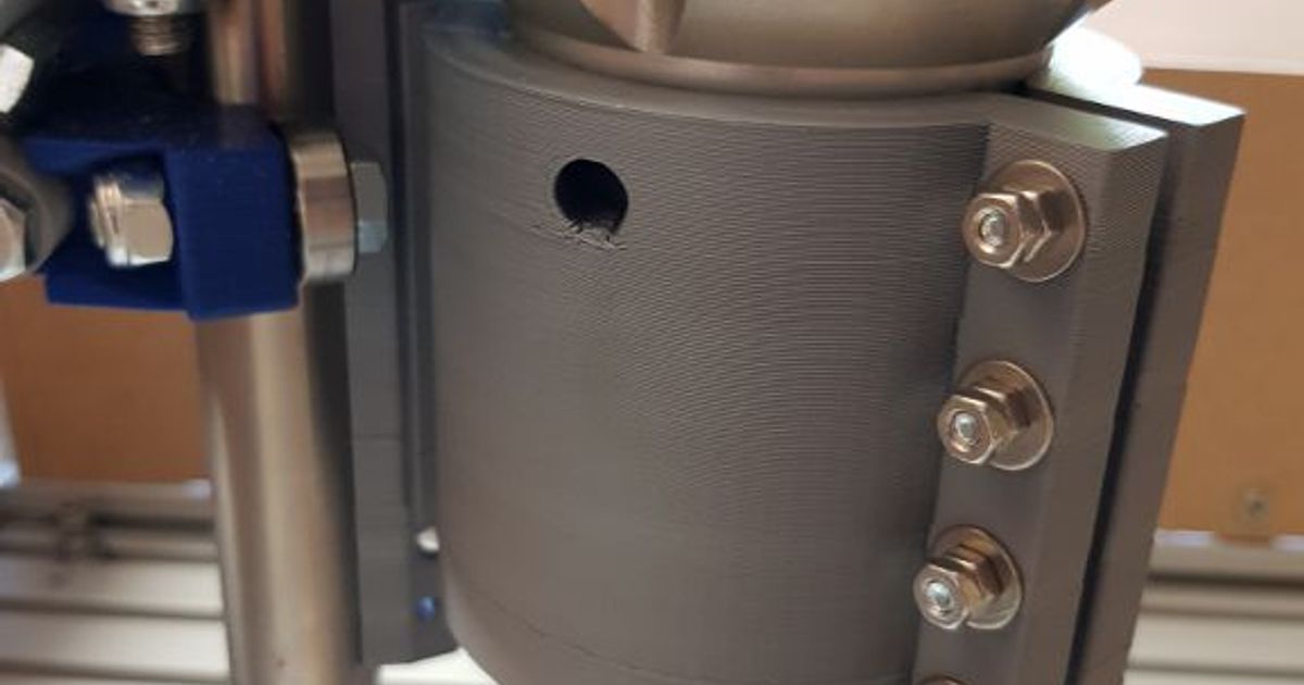

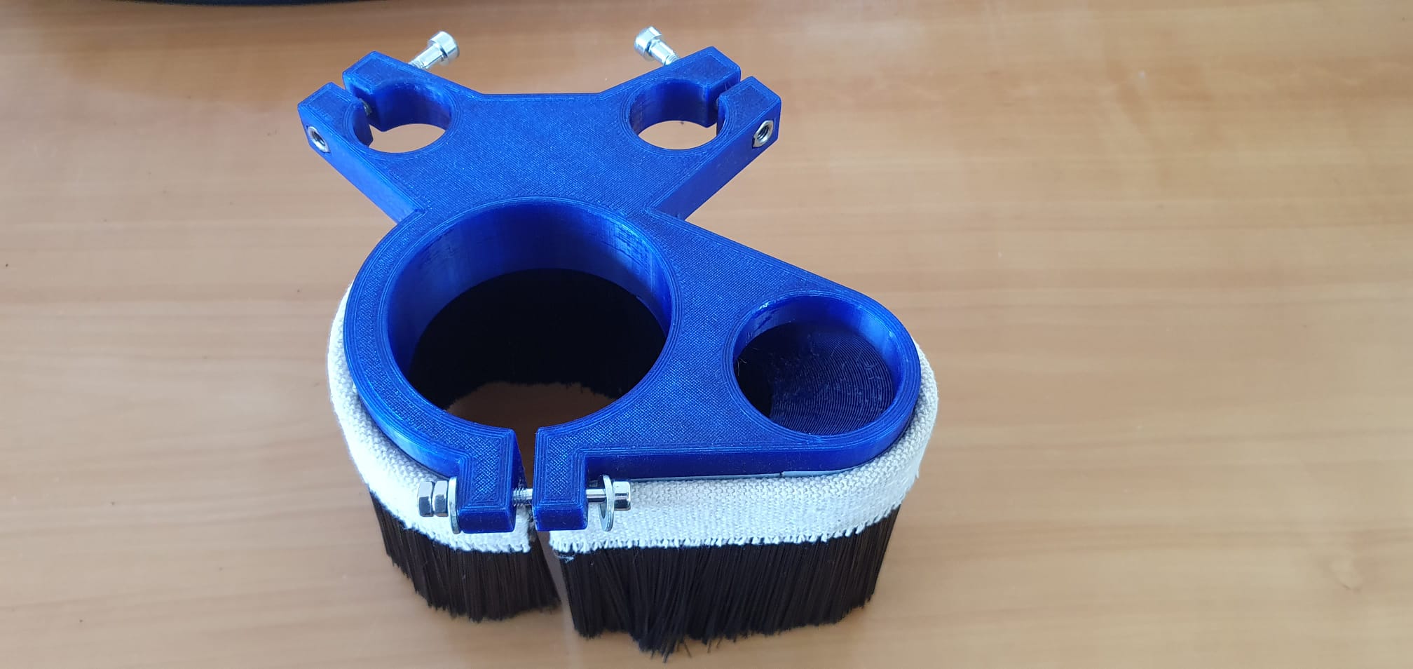

Some additional infos for the dust collector above.
I have tested the dust collector in the last weeks, intensively!
You can see, that I have added a transparent protection. It is a part of a transparent table blanket (plastic). I like to use that so I can see better the driller “running” over/through the working object.

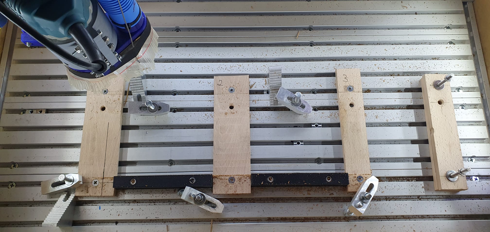

Here the result of the efficiency of the collector. This is the incurred dust based on a 5 hours (breakless) 3D-milling job (wood - european oak).
Works :joy: :joy: (99,99 % of the dust is in the vacuum system)

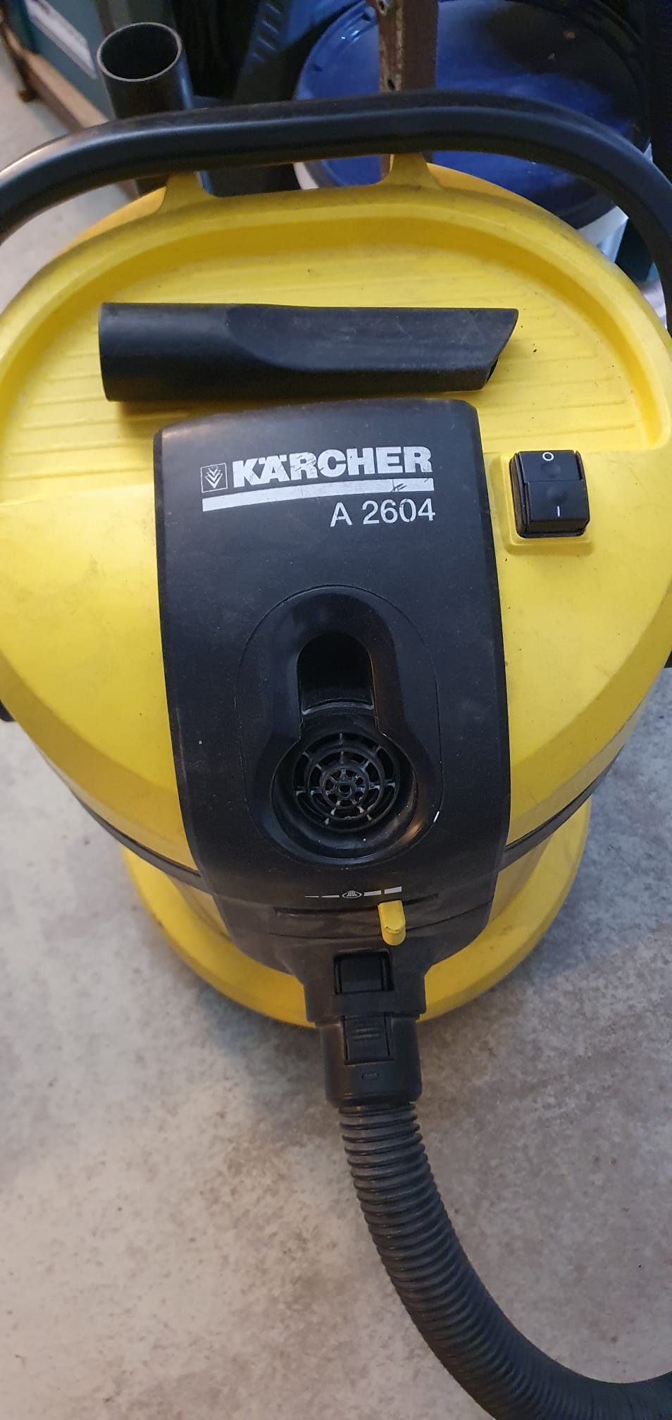

What kind of vacuum is connected on the other end of that pipe?
Do you know what kind of air flow you have on pipe at the shoe entrance?
I’m installing my system and I don’t really know what I’m doing…

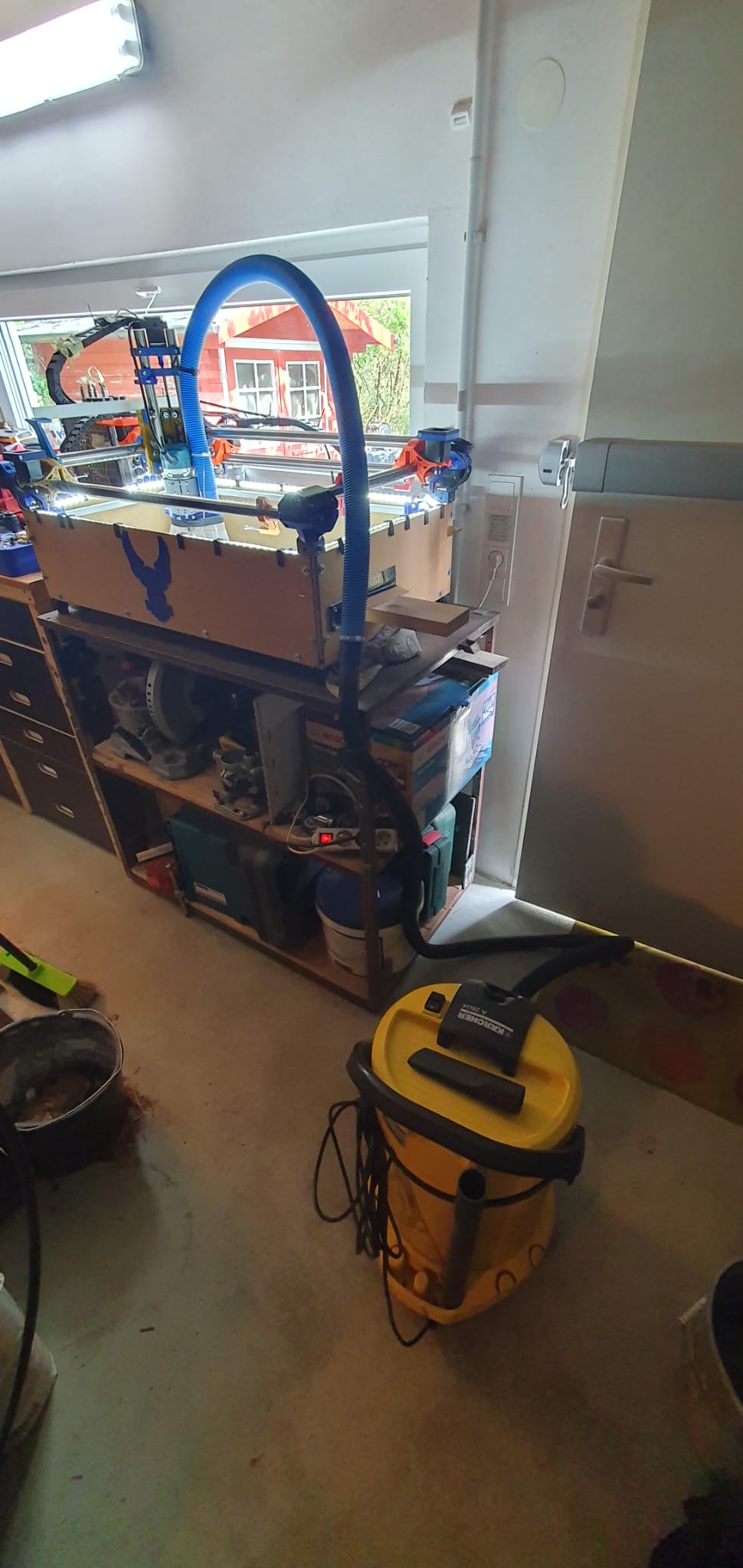

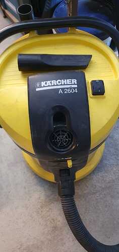

I use a “small” Kärcher (Industry Vacuum Cleaner - just 15 years old), so nothing really special.
My current “system architecture”
Professionality is around 20% :joy:
but efficiency - as mentioned - 99,99%. Negative: you can’t enter in the garage without any earmuffs (Mickey Mouse as we “call” them in Germany). The noice of the Makita plus vaccum system is tremendous.

The vacuum flow is directly focussed on the center of the driller and you can hear really a whistling sound starting the vacuum system. There is such a high vaccum within the transparent protection, that I have added a metal clamp (see the fotos above) because otherwise the protection will be sucked.

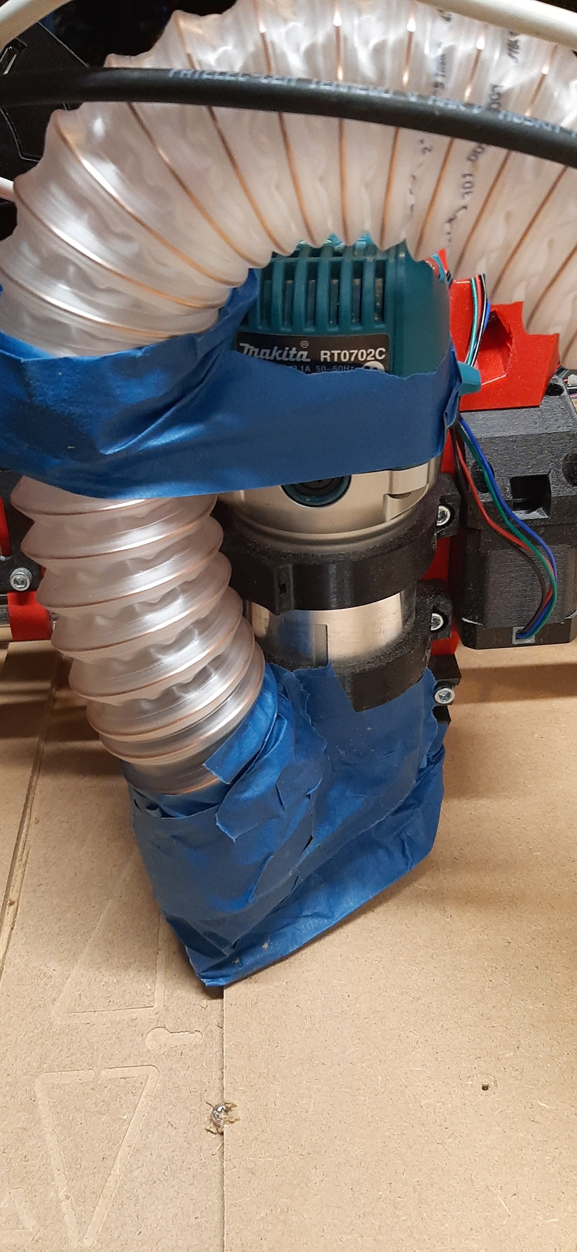

hey, it’s me live from my shop! your binary system is not really binary: look what I just did:
it’s shit, and it works!!!
Until it starts a fire. :smiley: Then it’s only shit. But lit shit. :joy:
