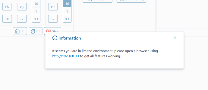

Thanks. My controller box is pre-loaded with Windows 11 Pro. I get the warning about no internet but no option for ‘use this network as is’, but I can X out the warning. My system wants to send me to msftconnecttest.com, and I get various loading messages and then the FluidNC screen. I am now navigating directly to 192.168.0.1 for the same screen to see if that gets me better stability.. I’m using firefox…

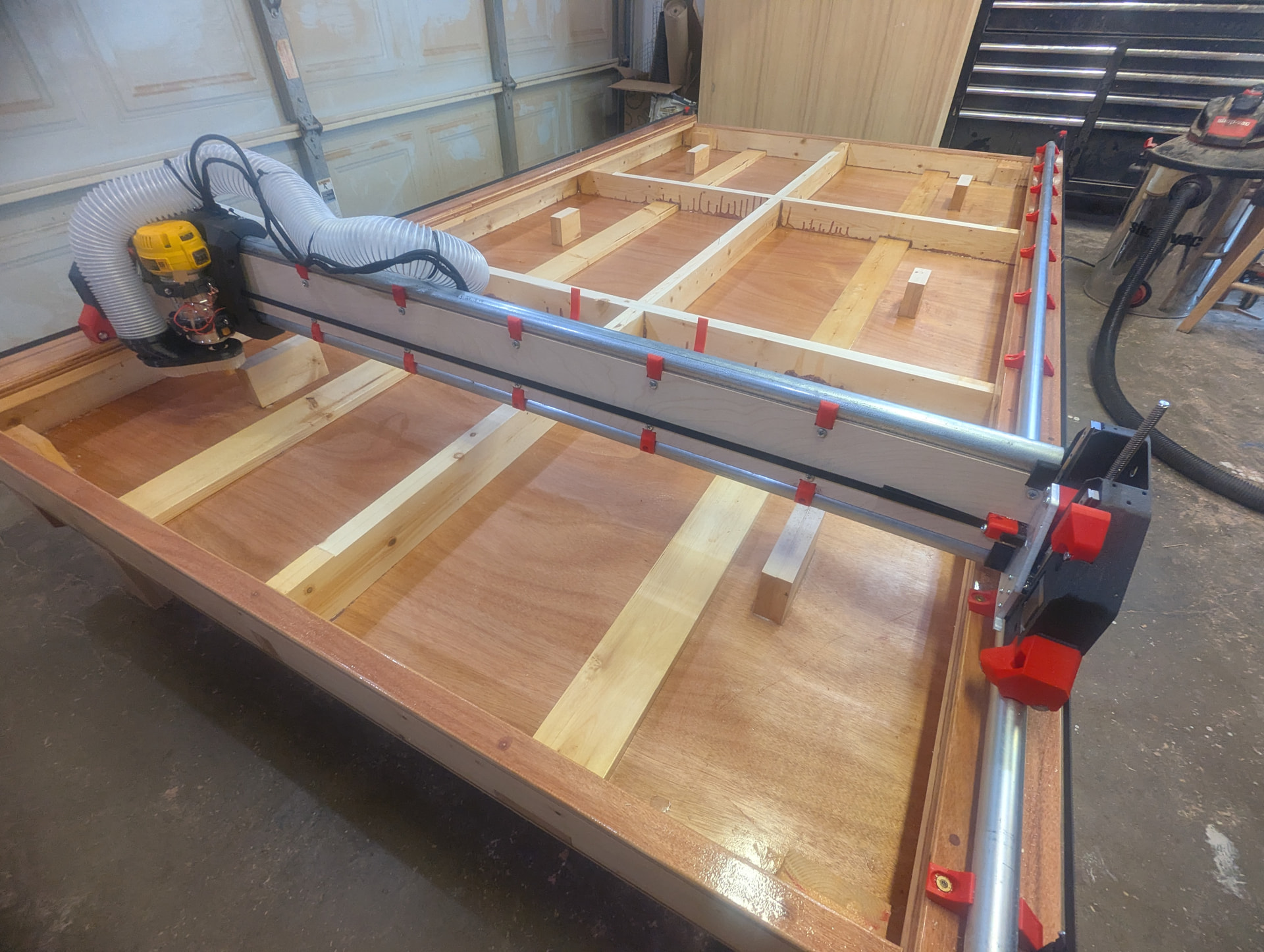

Thanks for all this help, everyone. Last night I spent a few hours manually driving the machine using UGS (FluidNC over wifi was still just too spotty for this) running on the gantry Windows box → USB into the machine, and a 3/4” wood bit in the router to level the pine ribs on my table. I’ll put a 3/8” thick 4’ x 8’ particle board on it and snug it down with some nylon machine screws for my build surface then 1/4” MDF spoilboard on top of that and get to work with Fusion360. I’m very happy with the accuracy of the machine–running for a couple hours and scrubbing all over a 4’ x 8’ surface, nothing on the Z wandered more than maybe 0.2 mm at the most, and even that was rare.
After doing that, more research, etc…. I realize I just want a simple pendant with a few bottons that’s wired into the controller and that would sort me out for most use cases, and then if I need to reconfigure or dig into settings I can log in long enough with FluidNC to do that. I’ll move the Windows box off the gantry and mount it on the wall next to my monitor and it can run Fusion360 in a utility sense and make SD cards. I can 100% see why part of the attraction of the platform is ‘just run it off your phone!’ for new users, and why in the docs it discourages that (initially at least) from a troubleshooting perspective.

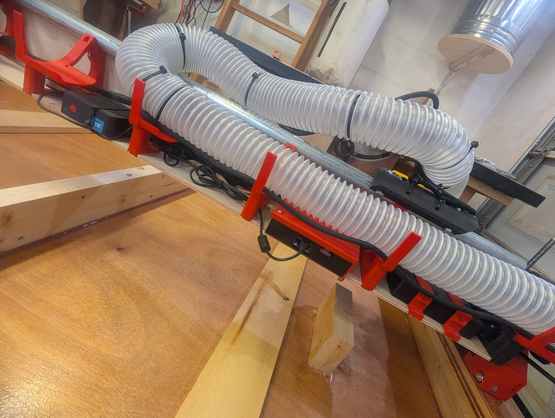

That is one idiot thing I did not yet do :slight_smile: I will send you CU of how I have the system set-up. I have a macbook in the shop right now for all this troubleshooting so when I get to it I’ll try to connect to FluidNC using it and see if it holds better. Maybe it’s the windows box. To be sure, FluidNC stays connected for at least a couple minutes at a time.
That’s the windows box there on the left. It’s got an HDMI monitor transmitter on it, and a wireless USB keyboard dongle in it. Currently it’s connected via USB to the back of the LR4 (I’m assuming based on the arrangement of the pins in the back that’s the Jackpot 1?). Running over the Jackpot is the power cable for the router and the PC. That router actually doesn’t use grounded power plug but I can add ground wires, and I haven’t grounded the dust hose. If you think that’s necessary for any reason I could do that. Since I haven’t been opening up the Jackpot and touching wires I didn’t think it was necessary. Thanks.
So this is the issue. The jackpot is not having a connection issue your device is purposely disconnecting you. Let’s figure this out before you spend any money or edit the firmware for a pendant of any kind.
What sort of device are you trying to connect with and what browser?
Laptop, or computer with wifi, what is your browser?

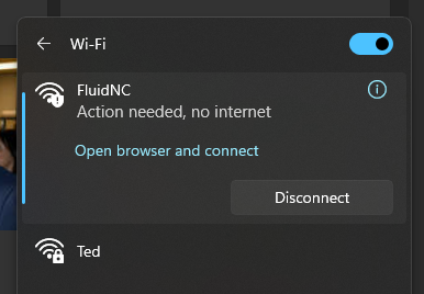

When I connect a windows 11 computer to the fluidnc wifi I get this.
My defualt browser, firefox, will then pop up this warning at teh top of the screen,

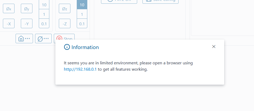

If you click on that button you will get the fluidnc page with the pop up that looks like this
From there if you click on that 192.168.0.1 link you should stay connected.
