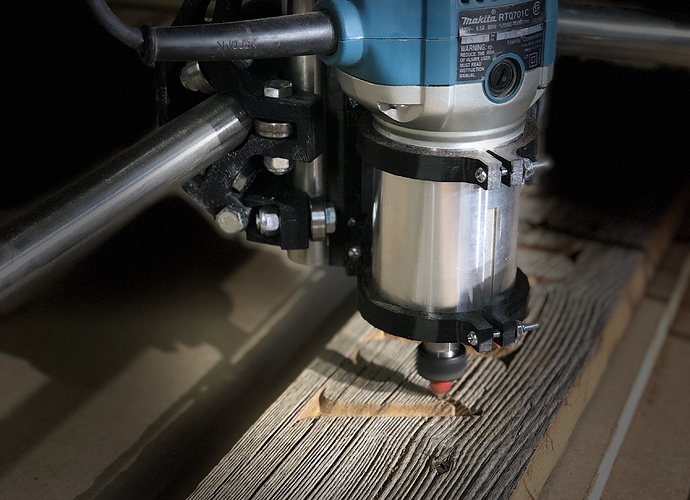

Here are some progress pics. Still need to finish the table and wiring, but this thing is a blast now that it’s working. Can’t stop cutting stuff!

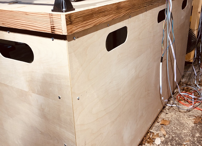

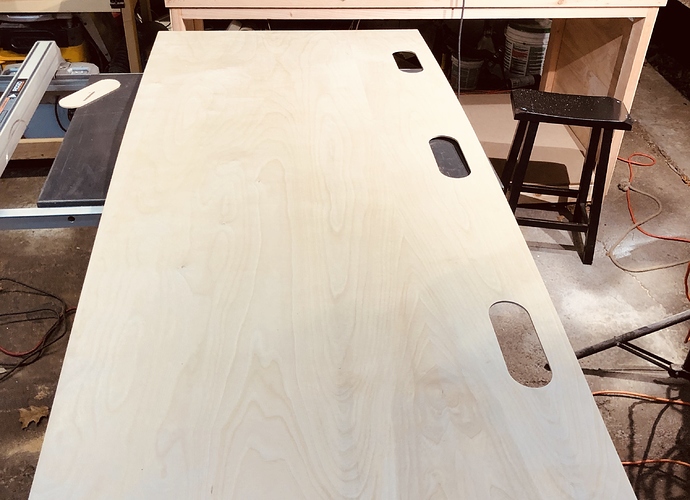

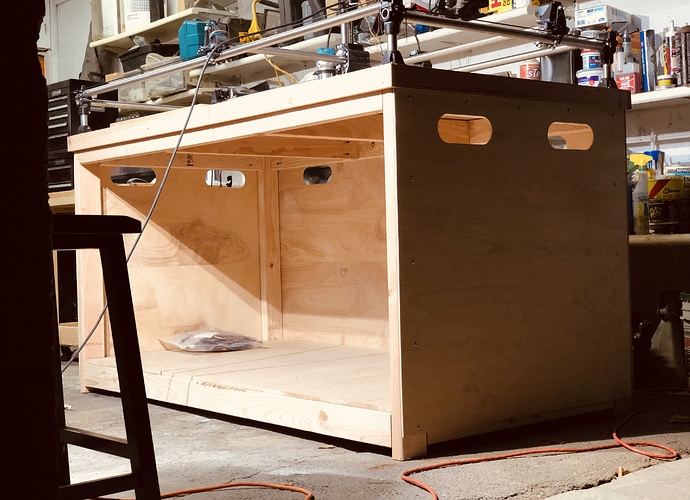

Got the cabinet braced up. Made up an excuse to cut some curved panels for the front. Extremely solid. Now to finish the wiring and other random items.

The build looks great.
