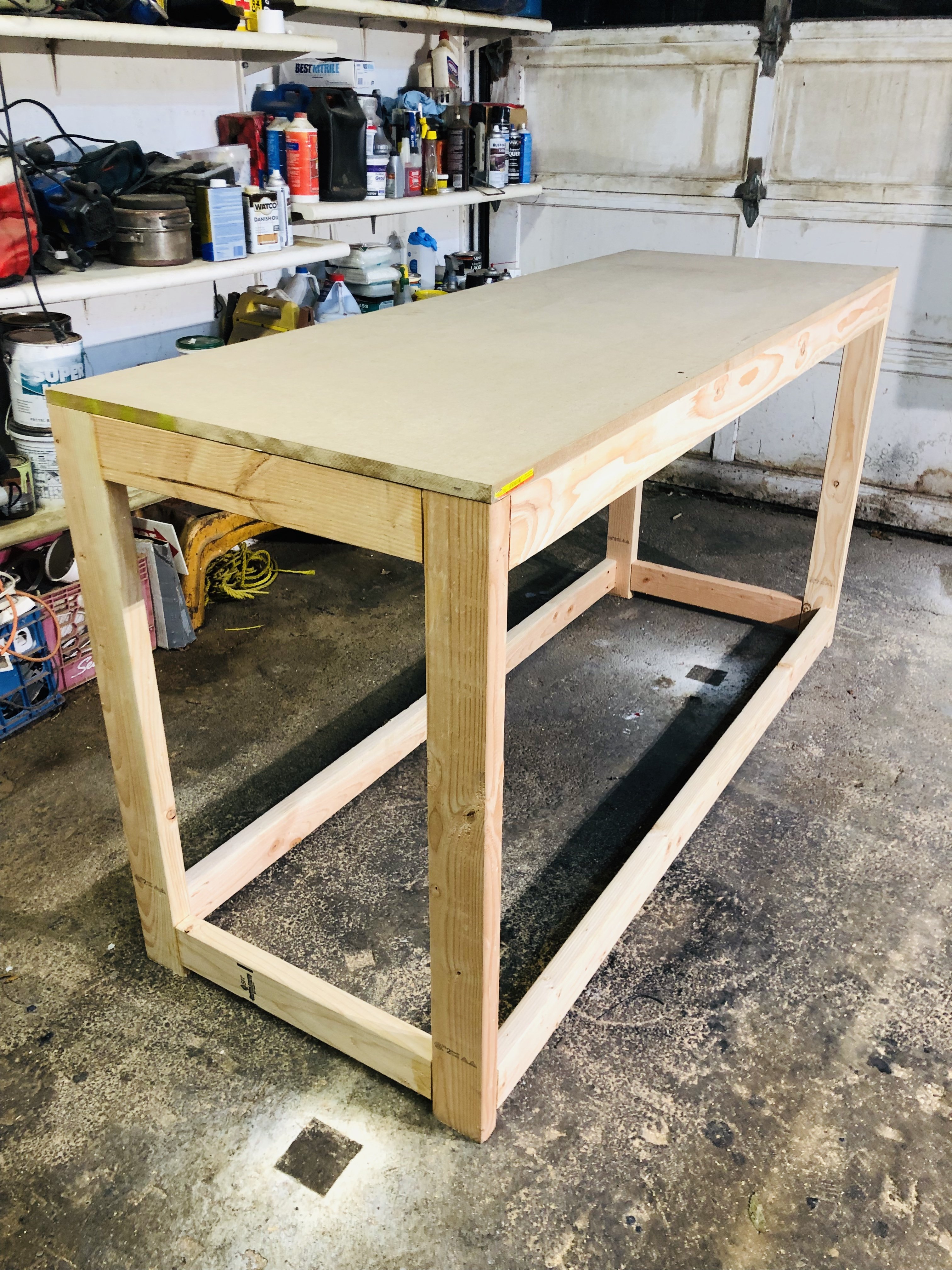

Due to being tight on time and budget, I’m going for a dead simple table. I built it this past Saturday, and somehow ended up making the legs a bit too long so I had to chop them just below the lower supports, but actually, I think I like the height since I’m 6’4"; and the low supports now create a huge area under the table to be used for storage. So it worked out. On Sunday I disassembled the old build and discarded the printed parts because many of them had cracked, probably from being a bit too tight, and being in a cold garage for two years. I’m hoping this doesn’t happen again so I’m going to go a little easier on the tightening.

Hey Ben, just throwing this out there, add some diagonal braces to the legs. My mpcnc can wobble my table and it’s built on top of kitchen cabinets! I also had to add some to my beefy lowrider table.

It wouldn’t hurt, but definitely on X(assuming it’s the long side). They don’t have to be giant X’s or anything, just cut a 2X4 with 45’s on the ends, maybe a foot, foot and a half long. Stick them up in the top corners and call it good. You could also use a piece of plywood along the back, also doesn’t have to go the full height, same foot, to a foot and a half. Basically just to keep the legs from racking.
