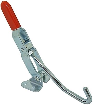

You could design a 2-piece end block, perhaps with a dovetail for alignment/retention, and hold it together with a draw latch like this: Amazon.com
But maybe that is a little too easy to release. Will have to think about that…
Yup or just use a zip tie. I honestly have not ever seen a downside, so many people are so against them and I have no idea why. A few cents…
The point of the two piece lock was to be able to easily let off the tension on the belts so you could remove the gantry from the table and reinstall without having to worry about having to adjust tension again each time. I’ve got nothing against zip ties…
Ohhhhh
Wonder if something like this would work?
