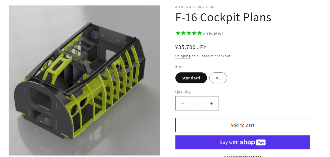

What to make?
Good question.

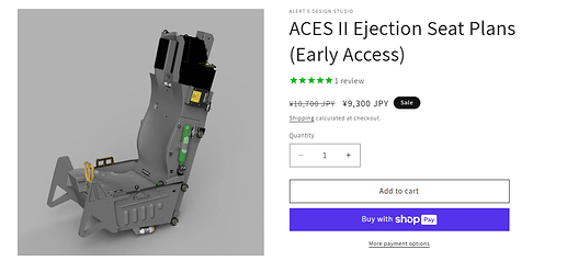

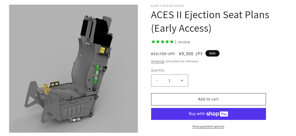

I like fighter jet combat flight simulators, and I’m thinking of making a 1/1 scale cockpit frame and ejection seat for an F-16C.
I have DXF data and 3D data for the data, and I plan to use lauan plywood as the main material.
As for the ejection seat, I’d like to make it out of a 4 x 8 foot 3 mm aluminum plate, if possible.
Also, I want to achieve the highest possible accuracy, so I would like to achieve an accuracy of at least ±0.5mm.
0.4mm or 0.3mm is fine.
I have a Maslow 4.1 CNC, but I can’t put a 12 x 8 foot frame in my room, so I need a Lowrider CNC that I can machine myself.
Looks like a cool project. The LR4 will do the plywood and aluminium pieces easily. I don’t see anything there that needs such specific precision, though?
While it may not be a problem if it’s within 0.5mm on the outside of the frame, I am concerned that the position of the screw holes on the internal frame for attaching the panel may become misaligned.
Typically the tolerance for screw holes depends somewhat on the size of the screw. If this is being assembled with M3 screws etc. then usual allowance for misalignment would be in the ~0.5mm range.
You do not need 0.05mm for this, you’d likely be fine with 0.5mm and the LR4 will easily do better than that.
