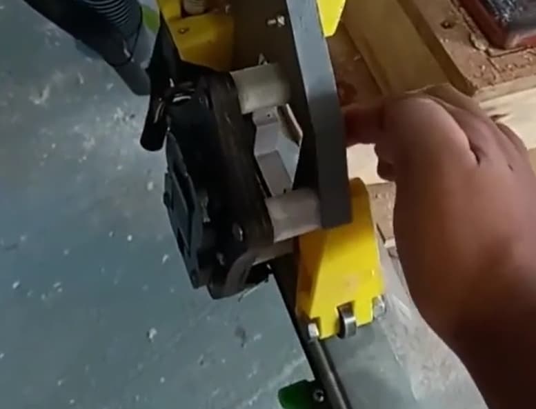

Hey guys so i have a weird problem on my lowrider 3
my left stepper motor skips steps when cutting For example when cutting the slightest resistants it gets it skips steps
I tried moving the y axies and holding back the stepper motor with my hands and the Right Side was very hard to stop as for the Left Side it as i held it it skipped steps can anyone help?

when the machine is in idel it is difficult to move(push) the y motor but when it is active the motor can be stop easily
Try swapping your Y stepper cables at the control board
If the weakness follows the swap you know the motor isn’t the problem.

Just to be clear, you swapped the stepper wires at the control board, and the issue stayed on the same side? If so, you’ve eliminated the stepper driver as the source of your issue. That still leaves the stepper motor, the wiring, and a mechanical issue.
  • Check the grub screws on the connector between the stepper motor and the pulley.
  • Swap stepper motors between the Y1 and Y2 (likely not an easy job).
If there is no mechanical fault, and the problem stays on the same side when swapping the stepper motor from Y1 to Y2, then it is likely a wiring issue. If it moves to the other side, then it is a stepper motor issue.
Personally, I suspect it is a wiring issue. It is rare for a stepper motor to go bad.
i swap the stepper wires same issue, i checked the grub screw its good, lol not looking forward to swapping the motors ill do it tomorrow and ill see what happens
Long shot, but maybe try swapping driver before the stepper. Driver swap will be easier than swapping stepper
nice thinking ill try thiss

So, holding position is easy, but left stepper skips when trying to move, hmm… Wondering if/what’s causing too much drag/resistance? Noticed hidden belts in Superstrut, looks like you checked tension already (first post). When stepper power is off, does it feel like the same pressure is needed to push and pull the gantry along the Y axis? If belt tension isn’t the problem, am wondering if debris/dust on idlers, pulleys, or belt are an issue? Hopefully idlers move freely, are well lubed. Already done close inspection of belt with flash light, do belt teeth look clean and undamaged? Guessing you’re using Belt from V1E with fiberglass core (i.e. not steel)?

right so I check the same pressure is needed on both sides to move (it moves freely)
I checked the wiring I swapped the drivers same issue

back with great news hope someone can learn from my mess up
i didnt remove the 4 red tabs i was supposed to
