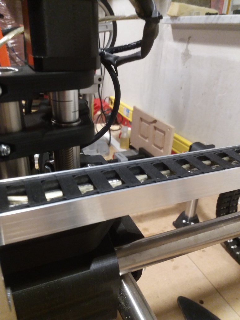

What board and drivers are you using (step rate)? Was the axis holding a spindle at the time of measurement (it should)? 0.04mm both up and down, and consistently? Pictures of your Z axis coupler area would be cool so I can make sure it looks good. What happens if you directly tell it 0.025mm steps or 0.03mm not just 0.01mm sequentially. After you have cleared the backlash zone does it correctly step at 0.01mm, what about other increments 0.017mm? Or from zero to 4.01mm? I am not confident in the one method of testing. A longer range is probably a good test as well and would show the same thing but bypass potential firmware/software/driver settings.

The heavy spindle compresses the aluminum decoupler completely.
[attachment file=99333]
Sorry for the bad quality, my lense has a crack and the cam refuses to focus correctly.
The Z-axis runs smooth. Without motor holding it, it slides all the way down (btw. is ther a good approach to prevent this / hold the spindle in place without motor engaged?)
any further information / photos desired?
Alex
I don’t think this is intended in the design. The lead screw is supposed to be butted up against the motor shaft (inside the coupler), so axial compression is supported by the motor bearings. And the bottom side of the coupler is supposed to ride on the bearing which sits in the plastic part, so tension on the lead screw is supported through the coupler and bearing.
Not sure if it would make a difference in your experiments, but that’s my understanding of the intended design.
Correct. I have a cutaway view of this in the assembly instructions. The shaft and screw should touch. The stepper bearings are rated high enough to support a router.
Ok, got it. I will correct this.
