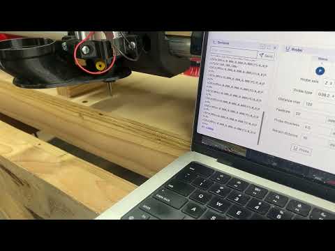

AutoSpin T1 is rad!
LR4 AutoSpin T1 video
(IDK how to embed videos here, short clip on youtube)
Just got it up and running for the first time and it’s so cool! Couldn’t find any info on the YAML code to make it function on a Jackpot 3 board, so fed Claude with all the info I could find and it spat out exactly what I needed.
Just in case anyone else wants to run one, add this to your config.yaml file, reboot, then M3 S10000 is the 10k RPM, S30000 is 30k, and M5 turns it off. Spiffy!
PWM:
pwm_hz: 4000
output_pin: gpio.2
enable_pin: NO_PIN
direction_pin: NO_PIN
disable_with_s0: true
s0_with_disable: true
spinup_ms: 2000
spindown_ms: 2000
tool_num: 0
speed_map: 0=0% 10000=32% 30000=95%
