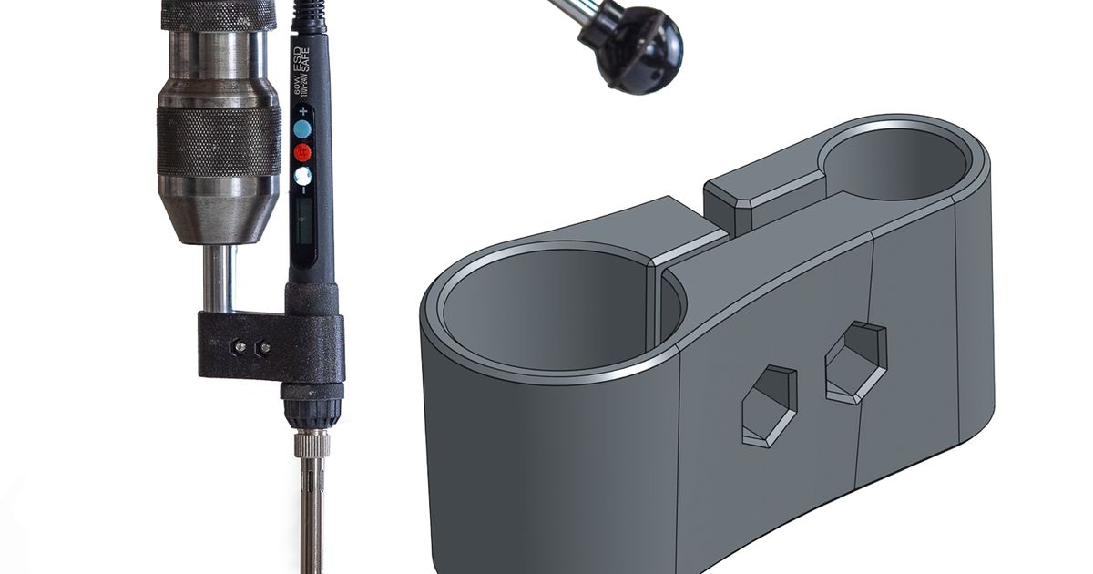

I’ve just done another batch of 100 inserts with my very cheap iron and drill press adapter. It’s a joy to see how smoothly that goes- depth is set by the press and the part is held precisely by a negative print of the part. I use a 1.2mm deep recess to place the inserts in, but one in three still falls a litt askew.
My cheap adapters do a good job of straightening them, but I wouldn’t like to trust a machine. I am following this thread with interest!

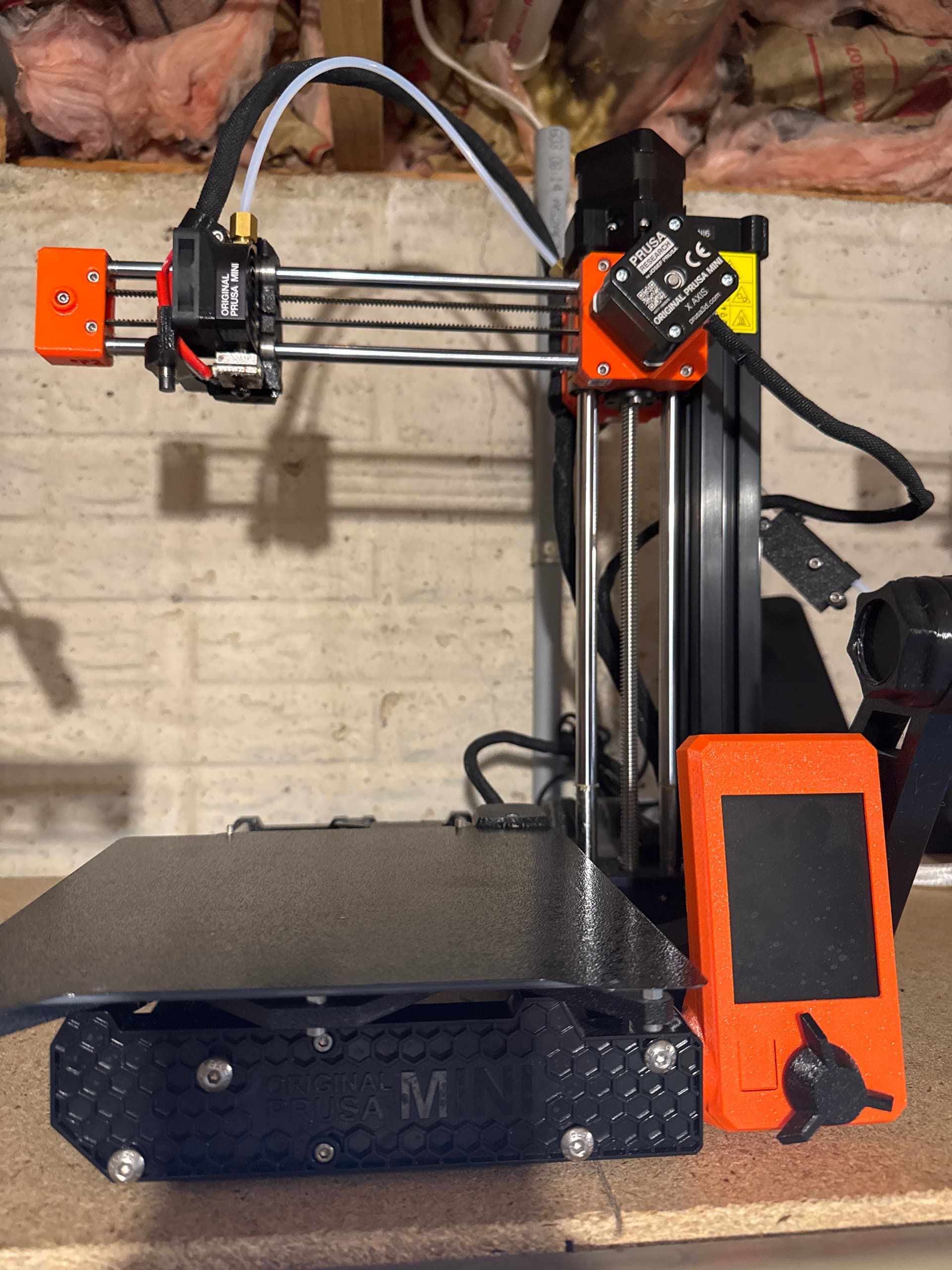

I have also been looking at some old prusa minis that I am about ready to decommission and it dawned on me that the hot end already has a heater and it might be a good platform?

I don’t have a very powerful soldering iron, but the inserts heat up almost instantaneously. I’ve found that temperature regulation is the most reliable way of regulating pressure, and before I made the press I used a bolt head to level them.

I wanted to share my first version of the machine and welcome any input!
Prusa Mini threaded insert edition v1
