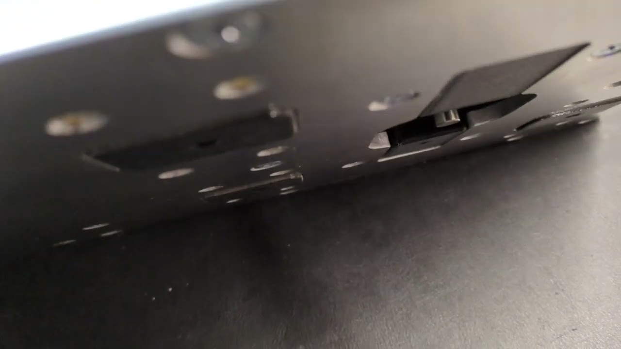

My Compass CNC can now measure the Z axis itself :slight_smile:
It is still possible to set Z yourself and confirm with the encoder, but if L+R is held down on the same screen, it automatically moves to the material and uses StallGuard to detect when the tool touches the material. I wouldn’t do this with sensitive milling cutters.
The right button or the encoder can be used to set the 0 position, or the right button can be used to return to manual zeroing.
So far, it works very well with the dummy router bit.
I need to test it with real material.
