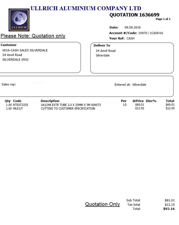

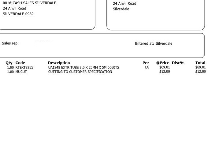

Hi Guys I’ve been searching around for a while and contacted Ullrich Aluminum and I was wondering if I could use Aluminum tubing for the tubes.
Also I would like your thoughts on the quote provided.
I have sent the measurements I have wanted (default from the calculator) and this is what he provided
This is the link to the site :http://www.ullrich-aluminium.co.nz/extrusions/extruded-round-tube
product code is : UA1248
Thanks
They say aluminium is too soft for the pressure applied by the bearings housed in the plastic parts.
I’ve used $10 Bunnings 1" OD 1m galvanised tubing. The zinc peels after running in the machine, but after a vacuum it appears to work OK and is slightly cheaper than the quote you got.
