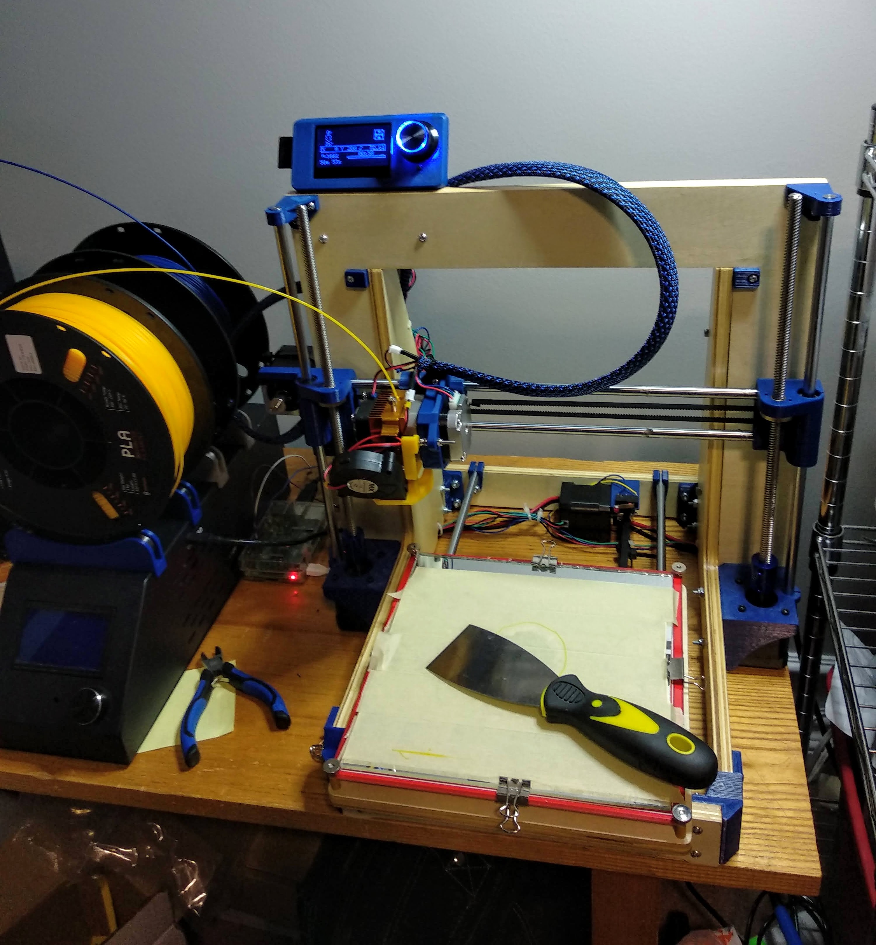

Almost finished my MP3DP v2 build. Just waiting on a thermistor for the heated bed, but otherwise complete. In the meantime, it’s printing PLA well on masking tape on a cold bed.
I used a SKR Pro 1.4 with TMC2209 and a FYSETC mini 12864 display. A few photos starting with the frame cuts on the MPCNC:
Assembled:
The first four prints off the printer:
The first print just stopped - I think it may have been a bad connection or related to the power supply. The second print of the calibration cube finished. Third print is the first iteration of a mounting bracket for the SKR board. Fourth print was a test of vase mode.

I initially started with Marlin-bugfix-2.0.x and then made necessary changes. I compared to firmware in the V1 firmware for MP3DP_Ramps_16T to find key code changes needed for the printer. I also followed a couple YouTube videos to get the key code changes needed for the SKR board: https://www.youtube.com/watch?v=oHMZ0ocTYvM and https://www.youtube.com/watch?v=-Gdk0wHg51w
The most difficult part was getting the display to work properly. I did need to flip around the notched connectors on the Fystec Mini 12864 panel; and I eventually found the needed code changes for Marline online. This page was the most helpful: https://wiki.fysetc.com/Manual_for_Mini_panel_on_SKR/
After running with Marlin for a while, I wanted to migrate to klipper as I got used to some of the features after getting klipper working on MonoPrice Maker Select v2 (Wanhao i3 Duplicator clone). I have been running klipper since.
If you have any specific questions, I would be happy to try to help. I can also post code, though I am quite unfamiliar with github, but perhaps it is time to learn.

I posted my Marlin files and my klipper config file to GitHub in case it may be of use to others: https://github.com/Kuhlio/MP3DP_Firmware

Hi @keeze
I opted to heat up the solder on the diag pin and quickly pull it up with pliers. I didn’t pull it all the way out, just up so it doesn’t insert. Really quick and easy, and my thinking is that is that I can move the pin back in place in the future if I wish.
