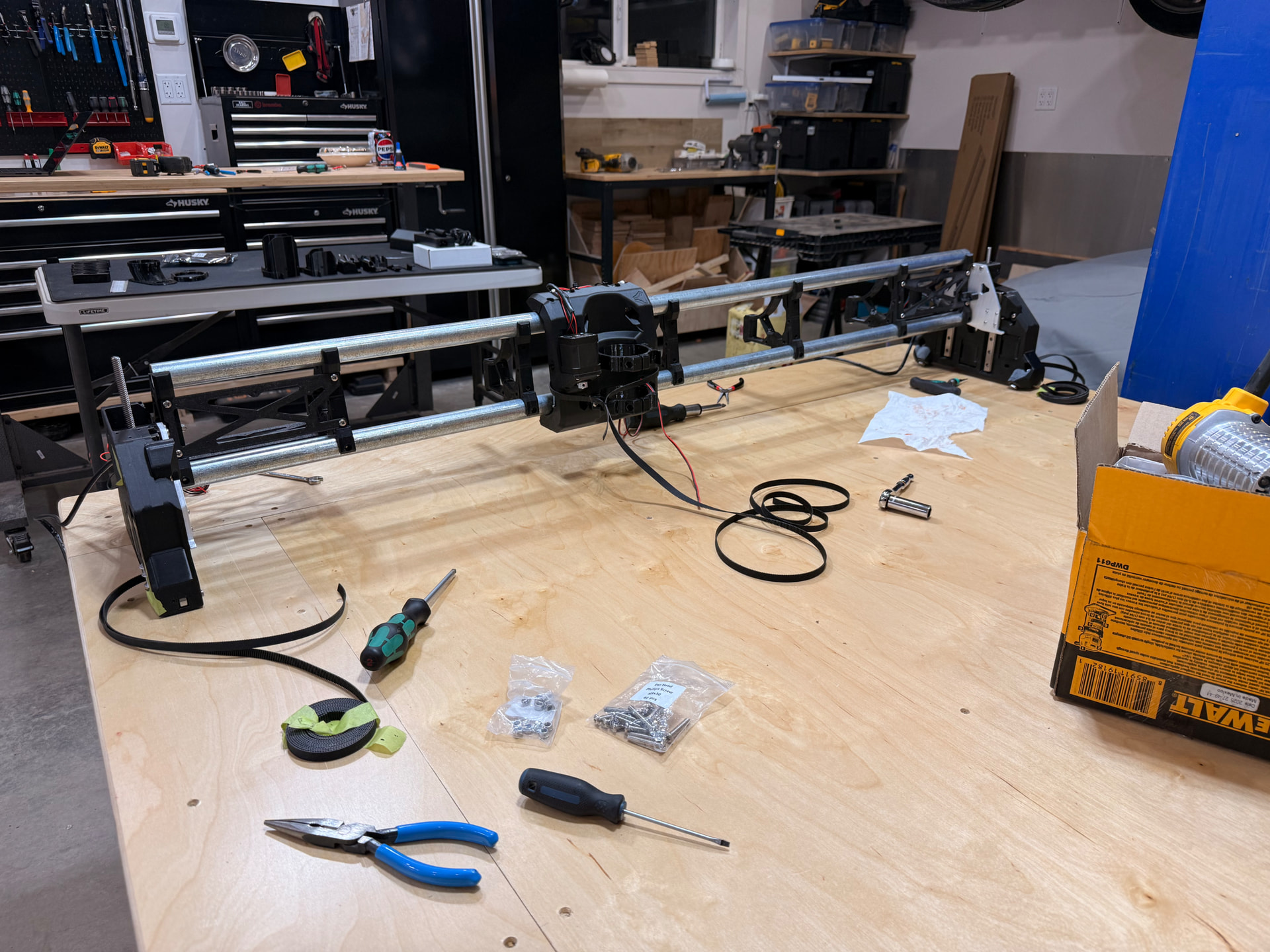

I’ve made lots of progress with my first build. I’m wondering if I’m getting binding on the (I think it’s the max) side of the assembly that rides along the Y rail.
On that side, the lead screw is more difficult to turn and the Z Stub doesn’t lower easily when I push it down. On the other hand, the opposite side lowers almost on its own, without being pushed at all.
Are both Z Stubs supposed to freely move and lower on their own without being pushed? If so, I’d appreciate some tips on what to do to get it moving freely.
What I’ve tried so far without luck:
  1. Loosen all rail screws, move the Z Stub up and down a few times, tightened the rail screws.
  2. Loosened the lead screw set screws and endured the lead screw is fully seated into the coupler, tightened the set screws
As I was packing up in the garage for the night, I realized I was shipped 4 Z Stubs, two of each type, and I used the ones with the slots on both sides of the assembly. So I’m planning on switching the ZStub on the max side to the other type the next time I’m in the garages working on it. Could the fact I used the wrong ZStub be causing this issue?
Can you post pictures of the Z stub assemblies from each side of your build?
Be sure you don’t have the M5 screw installed that goes through the stubs, it’s not needed and is the most common reason for binding.
Also be sure the Z stubs aren’t twisted in their mounts.

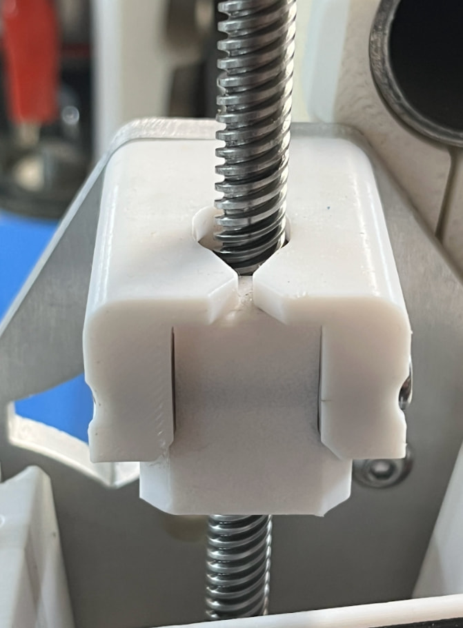

Picture courtesey of @azab2c (First picture a search turned up for me)
If you take pictures, do it of the other side, much easier to see what’s going on :slight_smile:

Usually… An unpowered, fully assembled, lubed, gantry will slowly fall under it’s own weight when the Core+Router are parked on that side.
Maybe :person_shrugging:. Z-Stub for Xmax side (EMT Rail) is solid, unlike the Z-Stub for Xmin side which has a slot for the bolt secured belt.
Before Z-Stubs are attached… the sub-assembly of {YZ plates} + {Linear Rails} + {Alu XZ Plates} should be able to slide nice and freely, with absolutely no binding or resistance. XZ should glide down like a guillotine… So, watch out for what’s left of your fingers.
Below’s a 2mins vid how to check and fix if Z-nut and Z-stub are binding with each other. This info’s for people self printing parts. Since, kits from Ryan are coming off his nicely tuned/maintained printers. Am sharing in-case helps you/others…
Vaguely recall there info/tips somewhere about moving gantry low as possible before snugging up things (so that there’s minimal flexing/resistance on the connections between leadscrew, coupler and stepper shaft).
Well lit focused close up pictures might help if you’re still struggling.
If I was the one that shipped it, I apologize. I noticed after the third or so that I had some parts on two printer plates… Should not change anything though.
The most important things are, as mentioned before, to take the screw out (see above) and, even more important in my eyes, that the stub isn’t twisted. Loosen the two screws that connect the stub to the alu plate and rotate it a little bit so that the hole of the stub and the leadscrew are perpendicular.

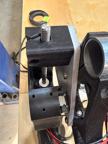

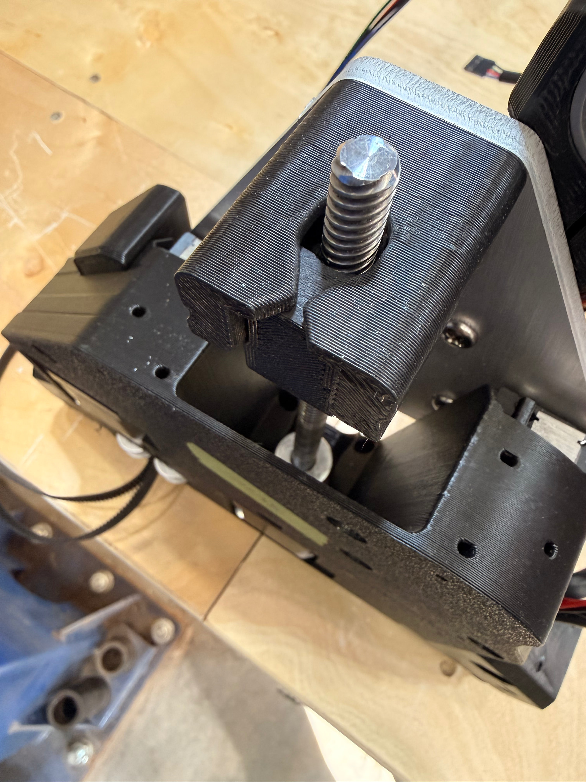

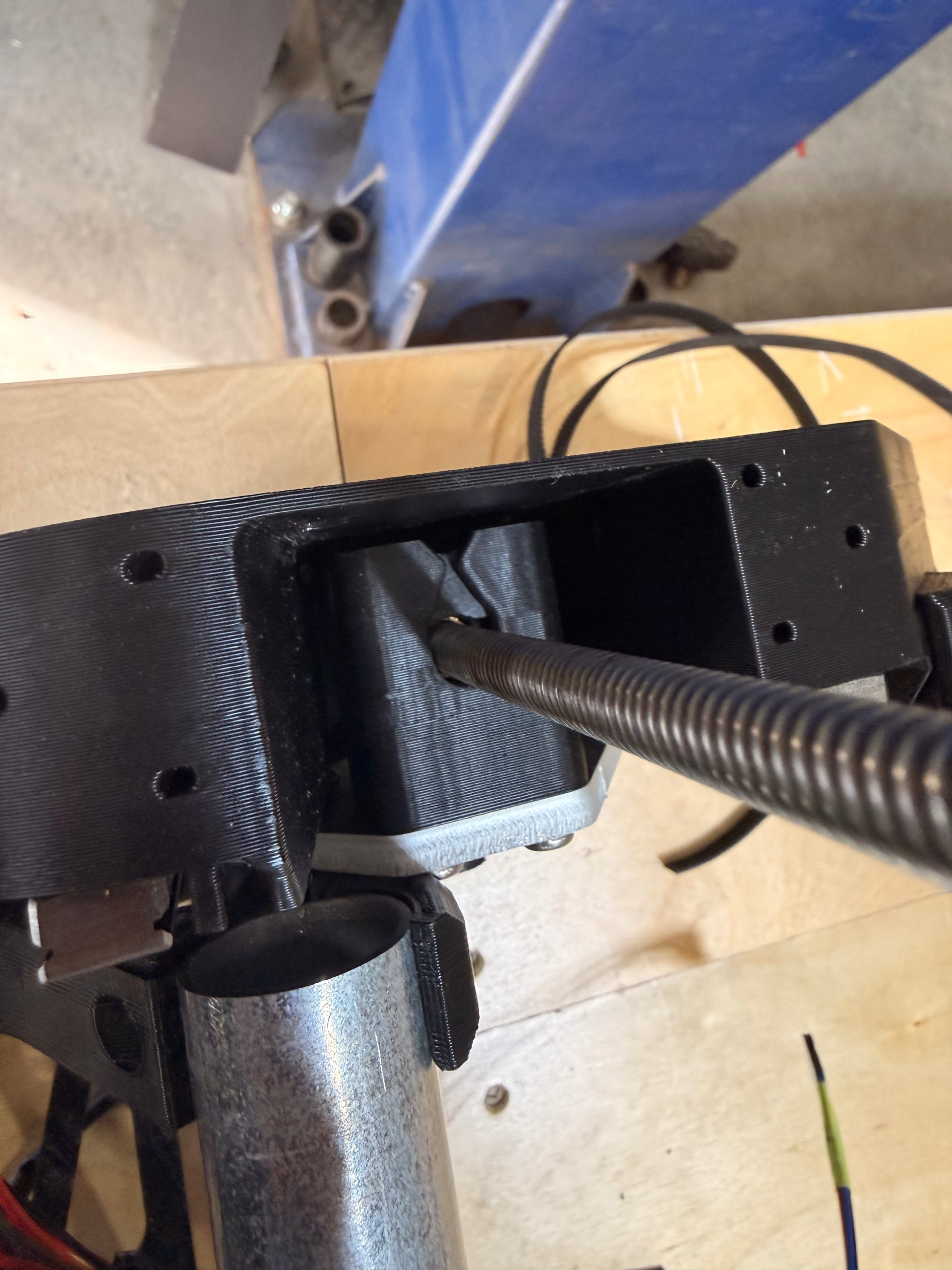

I really appreciate your time with this! Here are some photos
I will try this. Hope this is my issue. Look at lead screw how it is so leaning toward the Ymax side while sitting in the Zmax stub. Hoping this is causing my Z1 binding issue because now I think I know how to solve.

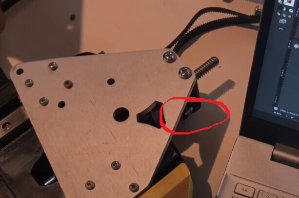

He did not call it out explicitly but I can see that @rsabboud is having the same issue by looking at his pics. Z screw is shifted laterally toward one Y side or the other.
Your stub is twisted. Look how it’s not lining up with the aluminium plate. That’s pretty crucial. :slightly_smiling_face:

I am still getting some binding on Z1 screw. I can get it to work by increasing motor current from 0.8A to 1.0A, but I’d rather not this be my fix since it feels like a band-aid.
  • I fixed the twisted stub, it’s straight as an arrow now
  • I made sure there was around 2-3mm of space between the motor shaft and z-screw when connecting via coupler
  • I loosened the linear rails and moved Z up and down and then retightened to make sure they are parallel with each other.
  • Screws are lubed up well
Next step is to just replace the dang z-screw and nut with new ones. Even though I see no damage on the screw or nut, maybe I damaged them somehow.

Is binding happening more when gantry is raised, or, when gantry is low as possible? If binding is happening more at specific height(s), that may provide a clue on cause(s).

It pretty consistently binds when about 0.75” (19mm) from the limit switch.

If you power down the machine and rotate that Z axis screw by hand, does it bind in a specific spot or area?

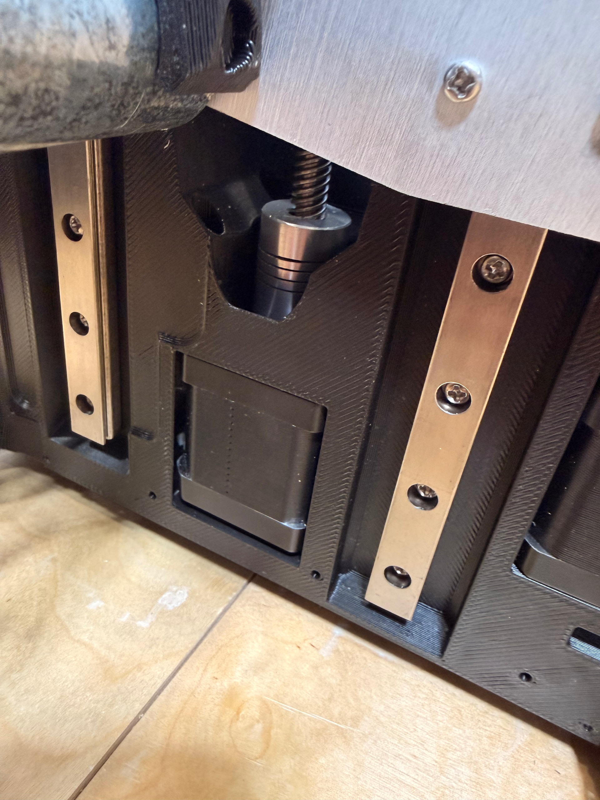

Can you post a picture of the stepper shaft, coupler, and leadscrew?
The problem won’t go away, at best you overcome it for a while until it gets worse.
My advice is to find and fix the real issue.
