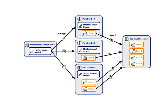

Assembly first OnShape method
This is sick.
It seems to make a ton of sense designing things like the ZenXY, MP3DP, or even the Low Rider. You start with making “blobs” for each component to define the outer bounds of each part to make sure everything fits. Then when you design the parts and make a final assembly, everything can be in the right place to begin with.
Ok that’s cool! CAD is something I very much want to get better at. But I just don’t use it enough to really get there like I would like. I do not have a mind for “designing” things like so many here do. But I still try lol.
One thing I wish they talked about a little more in the beginning was how they decided the size of the “blobs”. Do they need to be real close to the size of what you are wanting to end up with or as long as your close that’s all that matters? Stuff like that. And maybe they did and I just missed it.
It is super tough. Each project is kinda different. If a master part or sketch will work you should always use it. Sub assemblies really help things. I am still trying to work out the best way to use onshape.
In that video in particular he gets to one point and says “disregard the standard planes”. That means you have to make all new ones in relation to your part…that is a bummer. I prefer sub assemblies instead. I can’t see myself doing it the way they show, the blobs do not seem helpful to me at all. If that were me I would make each drum, with standard planes, make a drum sub assembly and use that in a master blob assembly maybe. That does force a little back and forth but seems more useful.
I am going to into the docs they reference a bit more but I am definitely not doing things the ideal way.
For my stuff it is harder as each thing has several references to the next thing.
The MP3DP I did in onshape was horrible to work with, I made it all in one document. The LR is better, I made it in separate docs, the next things will be a little better still.
His previous video he went through a bunch of design criteria for this machine, and considerations for different configurations.
In this design method, you make the space allocation in the first drawing to make sure everything has enough room. But if there is a problem you discover later, everything is dependent. So you can go back to the main drawing and change the size of those blobs. Then you have to fix any downstream problems that creates.
It seems like this stage of design is focused on finding as many problems as you can as early as you can. Those problems will be there. The earlier you find them, the “cheaper” they are to fix. He says in the beginning something about “fighting the problems instead of fighting the software”. That’s exactly why we learn new techniques like this. Finding a way to lubricate the software, so we can focus our energy on fixing problems in the design.

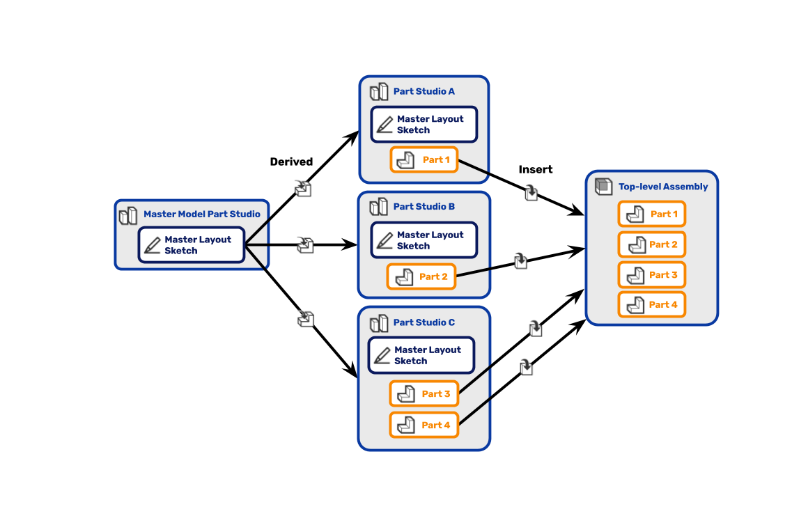

They call the first sketch “Space Claim”. So the purpose seems to be to assign different volumes to each sub assembly or part (I mean those as common terms, not onshape terms). The benefit is that you can more easily focus on that part, or how it fits into the whole machine, and not have to work on all the parts and all their connections at once.
For something like the ZXY, I would imagine things like the corners being blobs, and having some mating interface decided in the first drawing (like the belt paths). Once you start modeling things in more detail, you might find that you need to allocate more space or flip something around in the Space Claim to make it work. In the individual Part Studios, you may need to import more than one blob to get critical dimensions figured out. You would then assemble everything at the end to make sure things work.
Where I think this method gets really tough is where you have blobs that really nest together. If you really have coupled parts, then you need to draw them at the same time. Something like the MP3DPv5 might be tricky because something like the print head is so tightly dependent on cables, rails, belts, etc.
Yeah but I use the standard planes a lot. So for a part that comes in at an angle I would have to define a new set of at least three planes. I would rather build the part as normal, and angle it later.
I guess I build things as they are going to be built, so I tend to think of things in standard machining / printing planes.
I am very interested to see if this helps him with the new design. That machine is extremely complex with a lot of artsy flowing lines and angles. It is a super hard thing to do in CAD, He almost needs to be in Blender.
I think that’s only because he made some arbitrary and weird alignment decisions with the drums. And everything stays relative to the original origin. So you can still use those planes, or import multiple blobs, and use the origin to align parts in the final assembly.
The alternative is to make a super detailed design of a drum oriented to an arbitrary origin on the drum, then assemble a ton of detailed objects together to make a final assembly, only to find out they don’t fit and you have 500 objects in your file and no way for that dependency to connect back upstream.
For me, this is how it works in my head. The master sketch can set all the variables and tolerances, not just an actual sketch. Then each parts studio has its own relevant master sketch.
So for the LR the master might be a router, work plane, as I progress I would go back in and add like the X belt position. So maybe I already do it that way I just don’t bother with the primitive shapes…I should try that. Primitive belt shape instead of a sketch point reference. That would help with the Zen or MP3DP when I refence both sides of a belt and can get lost otherwise.
I think that’s what they are doing. He’s emphasizing that the master sketch is a “blob” or “Space Claim”, but that’s not well defined by that flow diagram.
To me, you are defining how the objects interact or line up in the first Part Studio. The “information” that document holds is that high level design. It doesn’t focus on GT6 vs GT9 or nema17 vs nem23. It doesn’t know what orientation parts are printed at.
It only enforces relationships like, there are three Z axis actuators. They are allocated this space to fit into. The motors will be in the front left/right corners. The frame is outside the mechanical parts…
Then in the individual Part Studios, you draw the pulleys and the leadscrews and how they mount to the frame.
At some point, you realize you have a problem with one of the endstops and you need more space. So you go back to the first drawing and add in that new constraint. Maybe you have to give up another constraint to make it fit. Most of the downstream parts are fine. But now you can solve the issue in the endstop part.
Assemble everything in the end and you can check fit, assembly, motion, etc.
