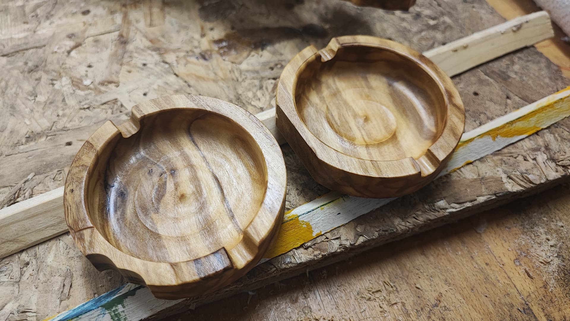

I still had olive scraps from the map of Paxos and my friend is one of the two people in Germany that still smokes, so I tried to make ashtrays.
You can see the markings of my bowl-cutter endmill. It’s 19mm diameter and has rounded edges. The right one was 75% stepover, the left one 50%. I really like how it looks, though it should have been smooth… :stuck_out_tongue:
In total I used five different endmills (so four toolchanges): 16mm planing endmill for the wood to be exactly flat (that’s needed for the 2mm roundover later, I didn’t do that for the right one and you can see the ugly ridges at the top of it), then the 19mm bowl cutter, then 6mm ballnose for the cigarette holders, then an 6mm 1-flute for cutting it out and a 2mm roundover for the edges. The bottom was done with a handheld tool, like a caveman would. :stuck_out_tongue:

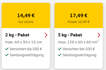

It’s insured with tracking for a maximum of 17,49€. :slight_smile:
