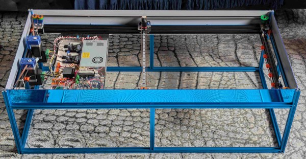

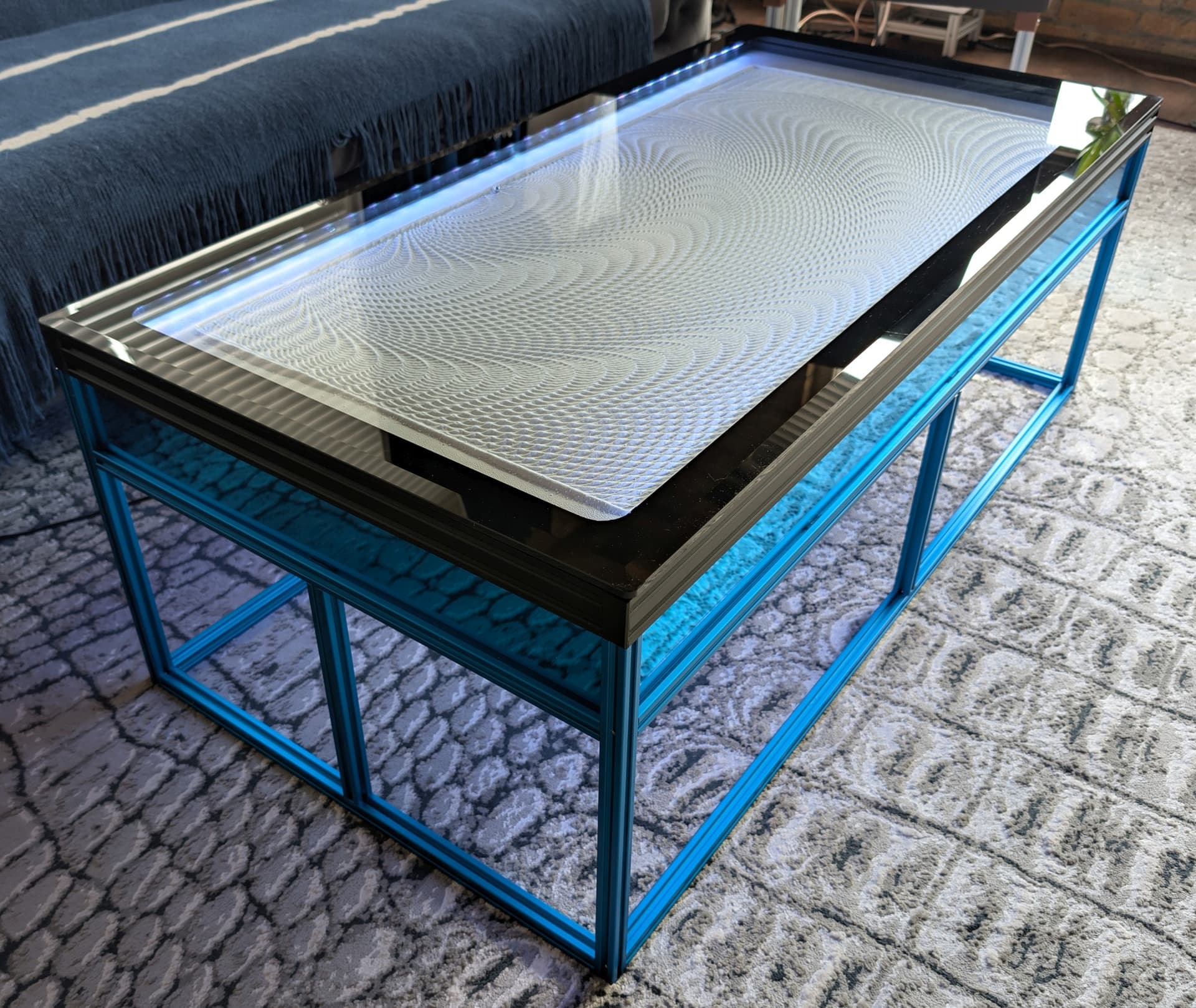

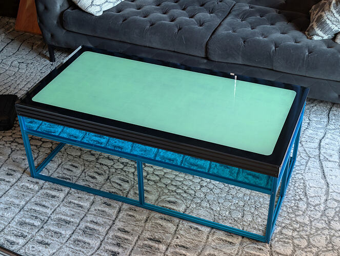

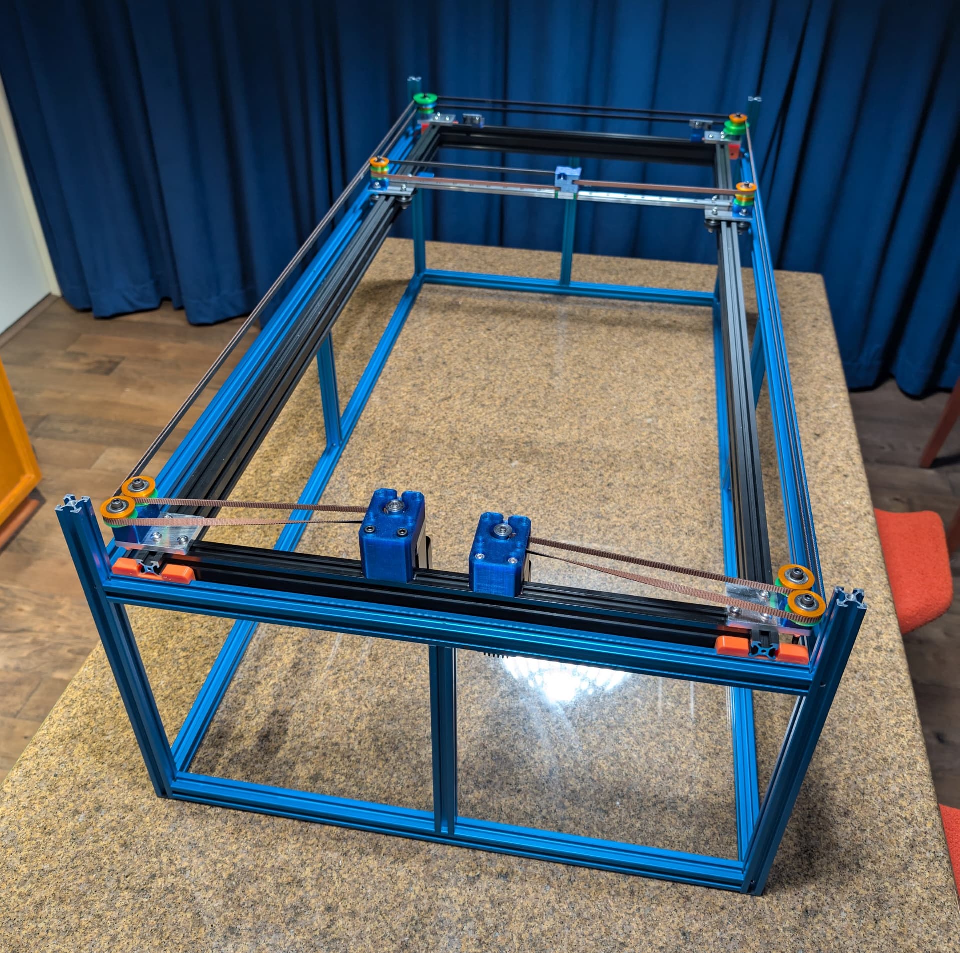

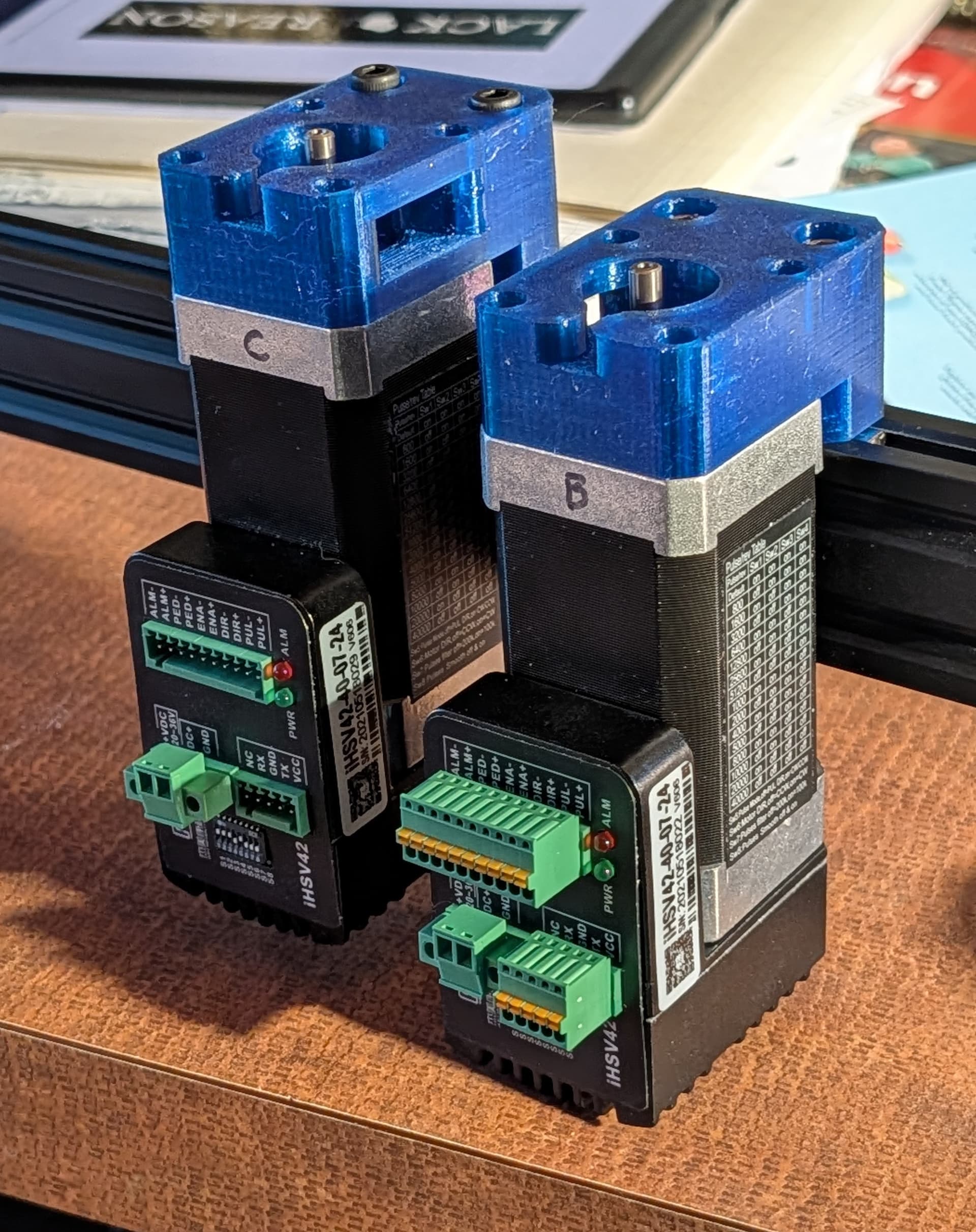

I built a new table to replace Arrakis 2.0, making some changes to the design that I hope will be improvements. The new table uses a 24 x 48” glass top - chosen for slightly smaller size than Arrakis 2.0, and lower replacement cost (I broke the glass on Arrakis 2.0 and it cost $330 to replace it). Arrakis 3.0 can fit through doorways without having to turn it on its side.
The mechanism is built on a 2040 v-slot frame that drops into a 2020 t-slot support frame that is slightly smaller than the glass top. The Y axis motion uses wheeled carriages that run in the v-slot, with a 12 mm linear guide used for the X axis. I used the same iHSV servomotors and Duet2 WiFi controller I used in Arrakis 2.0 because I had them handy. The mechanism is a stacked belt coreXY type using 3D printed concave pulleys that prevent squeaky noises. The pulleys use stacked F625 bearings. I used optical endstops. Drawing area is 465 x 1005 mm. All the electronics mount on an aluminum plate screwed to the bottom of the mechanism frame.
The sandbox is also made from 2040 v-slot with a white fake leather cloth covered 3/16” thick G10 fiberglass board fit into the lower slots, and LED strips fit into the upper slots. I painted a black frame on the underside of the glass top that just sits on top of the sandbox. The sandbox screws down onto four posts at the corners of the support frame. I added more LED strips (with a power switch) to the underside of the mechanism frame to light the floor with the same colors used on the top of the table.
The sides of the mechanism will be hidden by some 1/8” mirrored blue acrylic pieces that will fit into the slots in the 2020 t-slot support frame. I am planning to cut and install them tomorrow.

mechanism frame drops into the blue support frame.
motors and 3D printed mounts

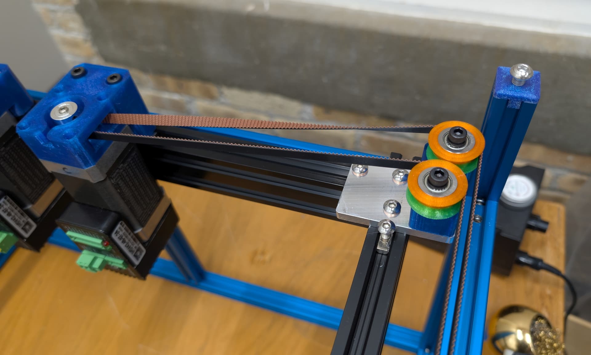

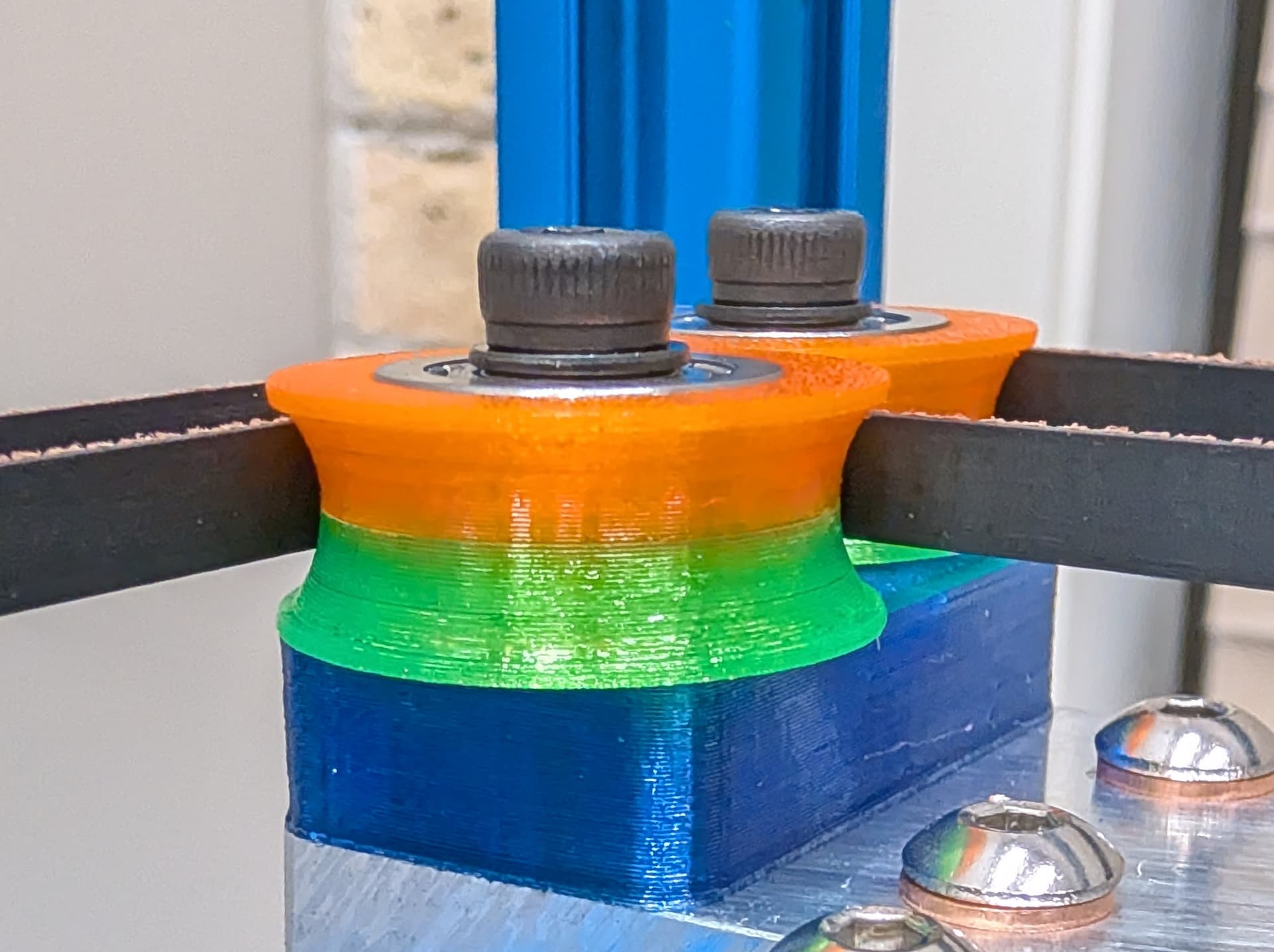

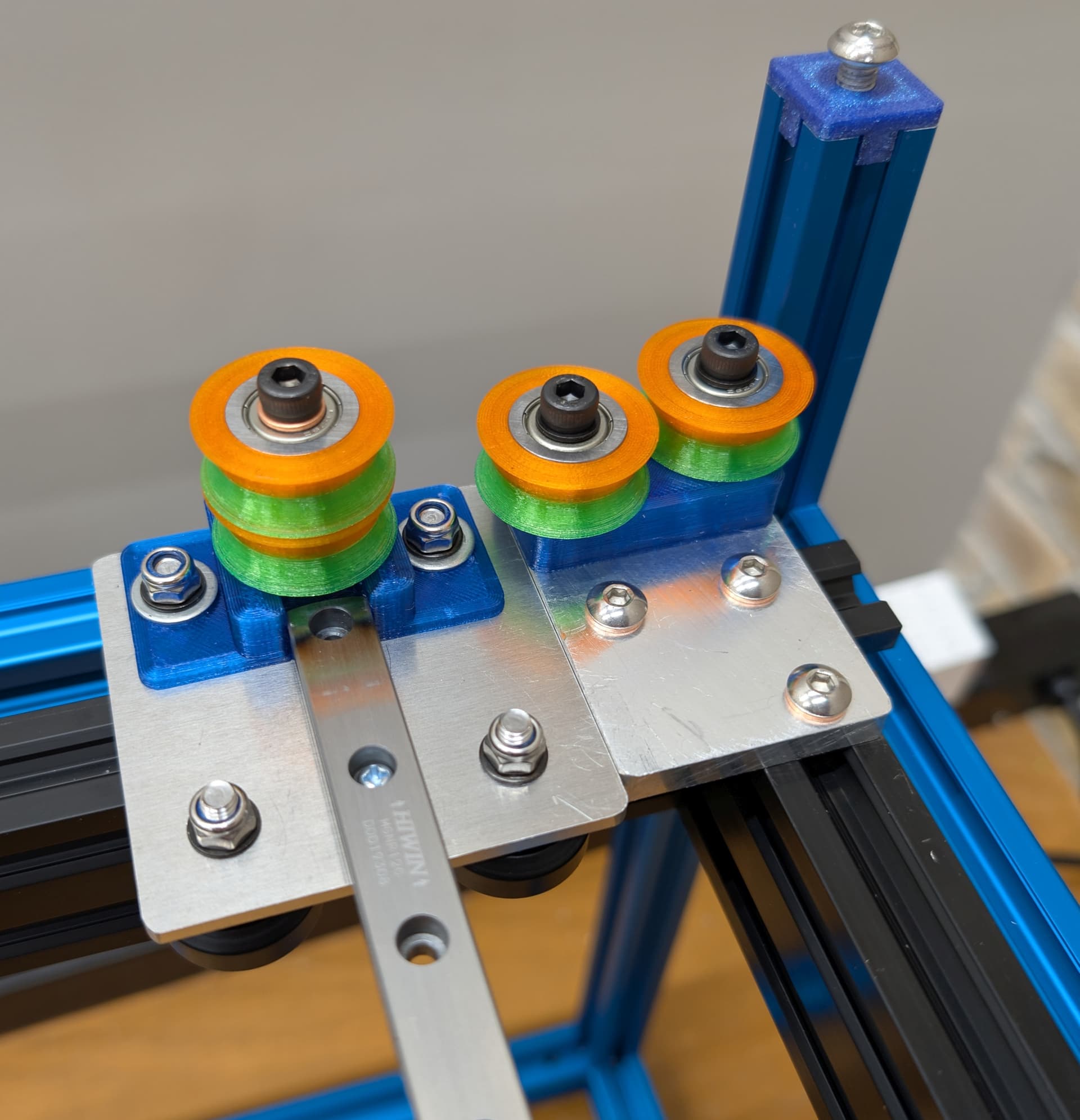

Y axis carriage and corner pulleys

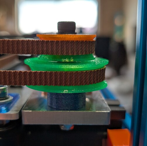

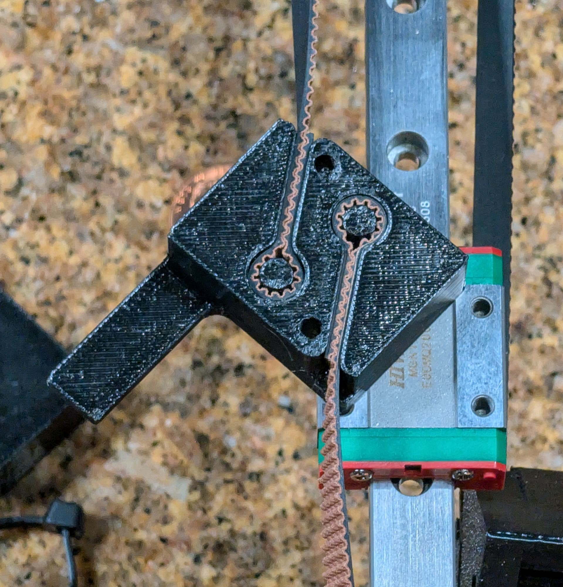

twisted belt so that belt teeth only contact the drive pulley

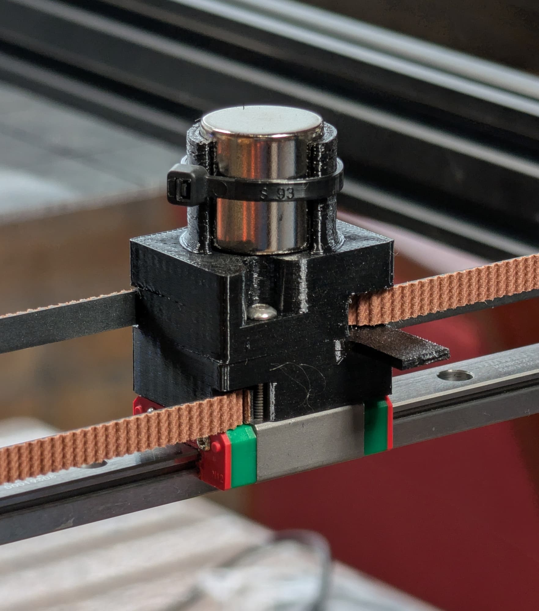

magnet carriage

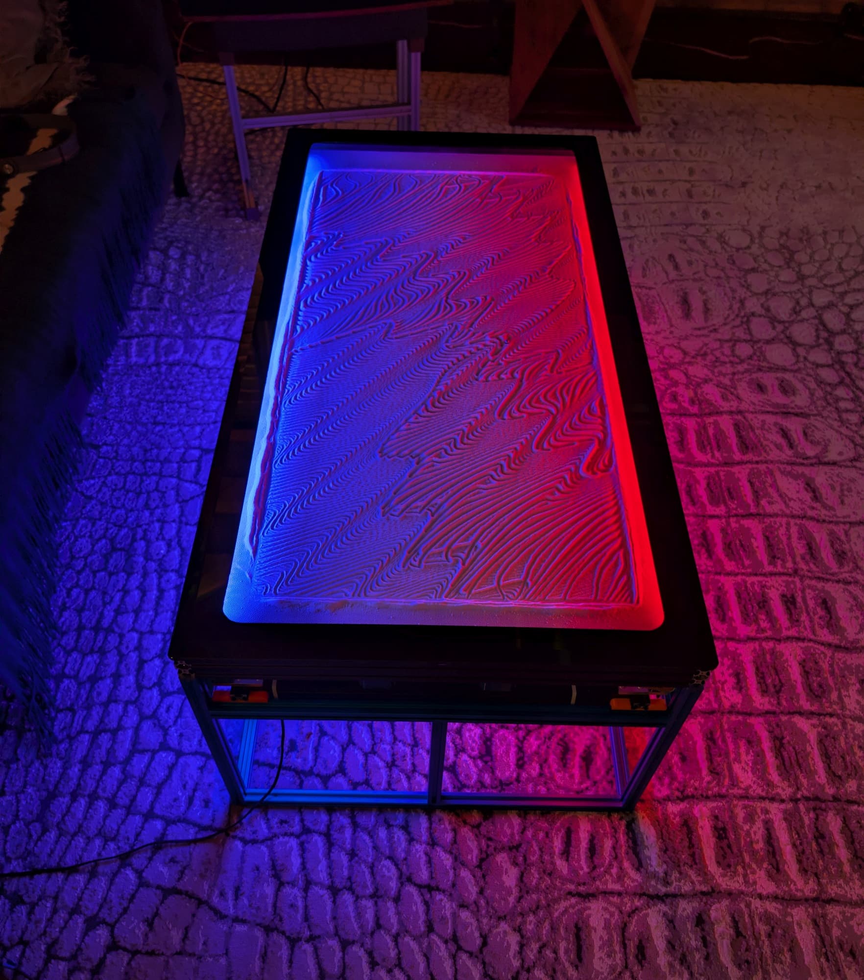

floor lights off
floor lights on

All the printed parts are PETG. The magnet carriage has been through 3 or 4 design revisions and reprints. Initially I used some blue PETG and discovered that it was transparent to the optical endstops, so I switched to black. Then I had a problem with the belts coming out of the clamp, until I redesigned it so that the ends of the belts fold back on themselves.
The pulleys are printed so the F625 bearings press fit into them, and there’s a washer between the two halves to ensure that when the pulleys are mounted the pressure applied by the bolt doesn’t side load the bearings. Most of the pulleys are 23mm in diameter at the center, but there are a few that are 33 mm in diameter. I solvent welded the two halves of the pulleys by putting a drop of ethyl acetate (sold at home depot as “MEK substitute”) on the contact point. The pulleys are concave so most belt contact is on the edges of the belt. This may lead to rapid wear of the belts and/or pulleys. I’ll know in a few months.
I originally bought some wheeled carriage assemblies for the Y axis but found problems with the way they were made, so I ended up using the wheels and made my own plates for them from 1/8” aluminum. I bought a 520 mm linear guide for the X axis, and had to shorten it by a few mm on each end using a cutoff saw. The guide rail is mounted using only one M3 screw on each wheeled carriage. the screw passes through a 3mm slot so the rail can slide a little along its length in case the Y axis rails aren’t perfectly parallel. There’s a printed part the ends of the guide rail fit into that restricts rotation around the screw.
The strong magnet on the linear guide bearing block will cause the bearings in the block to tend to stick to each other and will attract ferrous particles from the environment to the rail, so I’ll have to check it periodically to make sure the rail is clean. I tried a 10mm ball initially and the magnet pulled on it so hard it lifted the magnet in the carrier. I have since wrapped it with gaffer’s tape and then put a zip tie around it and now it doesn’t lift up.

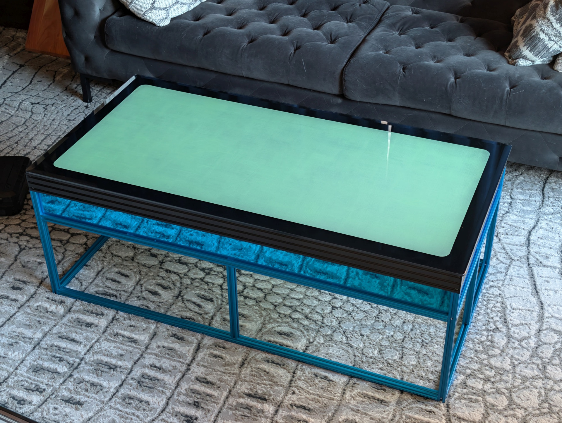

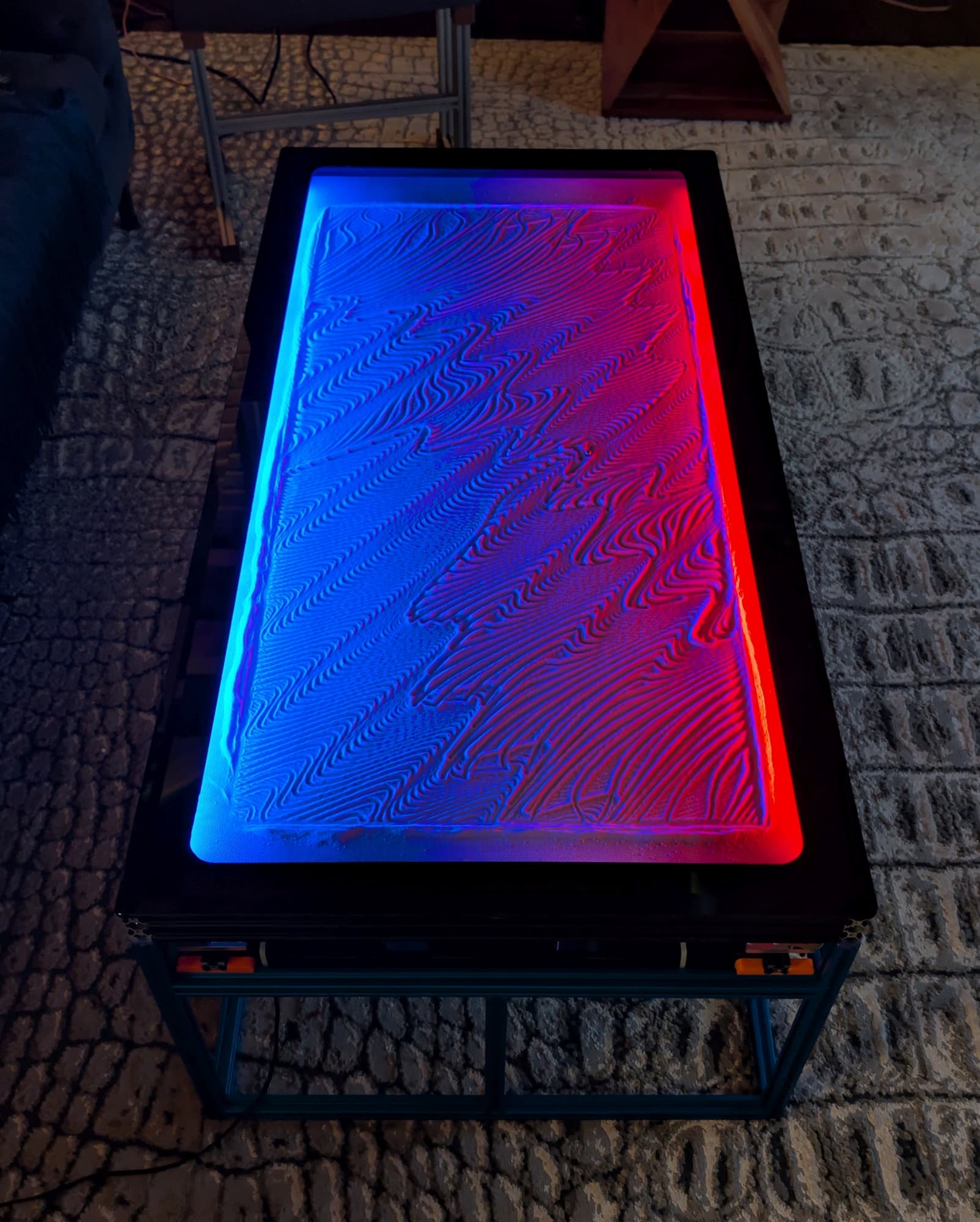

I realized that instead of screwing the sandbox down onto the posts in the blue support frame, all I had to do was put threaded pins in the posts and drop the sandbox onto them. The sandbox already has the holes and the posts are already threaded. Pins are on the way.
I added mirrored blue acrylic side panels with some clear silicone edging material to center it in the slots and prevent it from rattling. I think it turned out well.

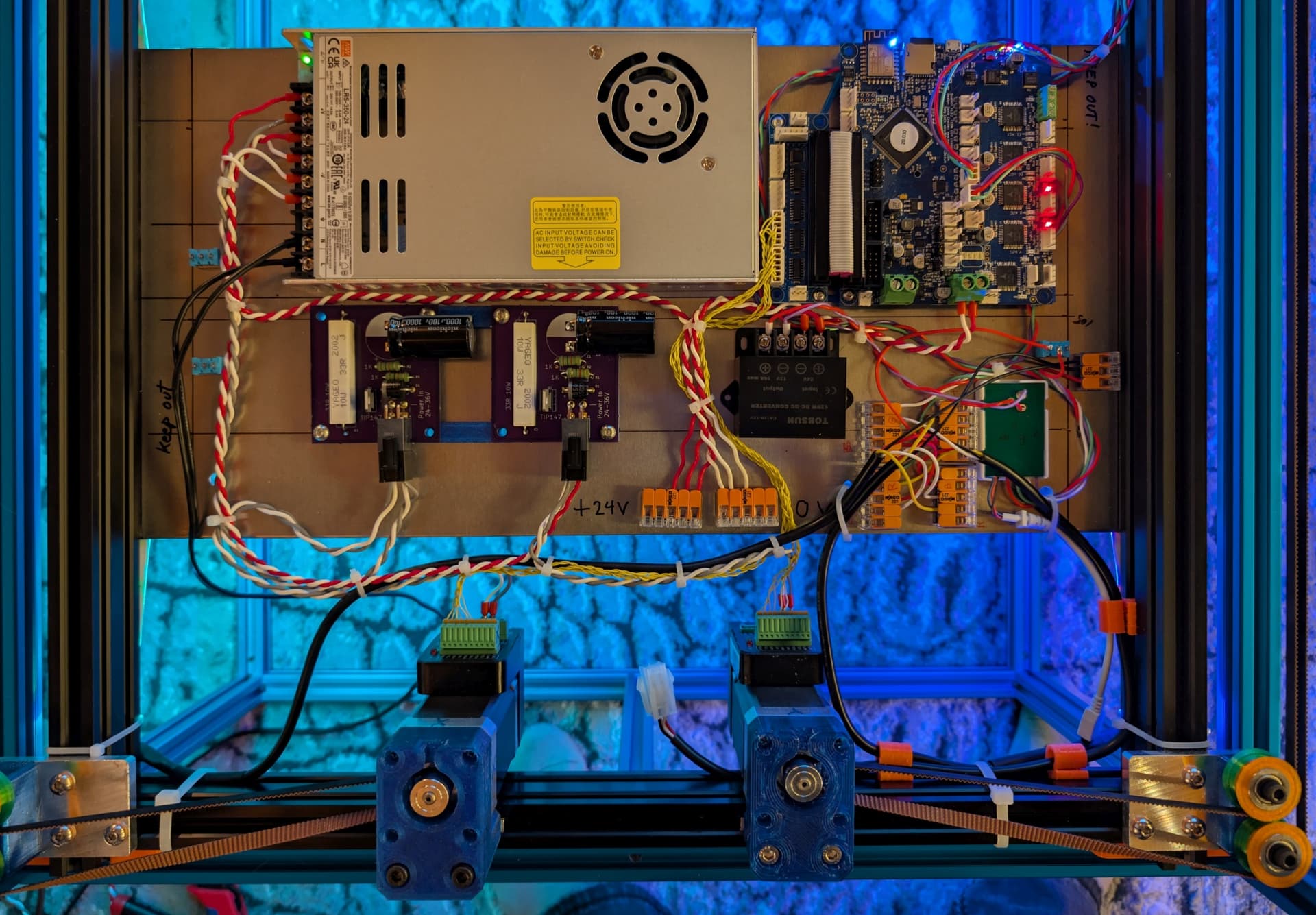

This is the electronics plate with everything mounted. I did my best to neaten up the wiring with zip ties. The connector between the motors is for the LED strips in the sandbox. If I want to take the sandbox off, I just remove the glass, disconnect the LED strips, and lift the box off the support frame. If I want to do some work on the mechanism, I can just lift it out of the support frame.

I have noticed one potential problem- when sitting idle with LEDs on, the power supply cooling fan kicks on sometimes. I’m thinking there’s a problem with the temperature monitor in the power supply, so I might have to replace it.

Update: For some reason, the power supply fan in the table turns on at random intervals for a few minutes at a time, even when the motors aren’t running. I don’t like to hear the fan, so I am going to replace the one LRS-350-24 power supply with two fanless LRS-200-24 supplies.

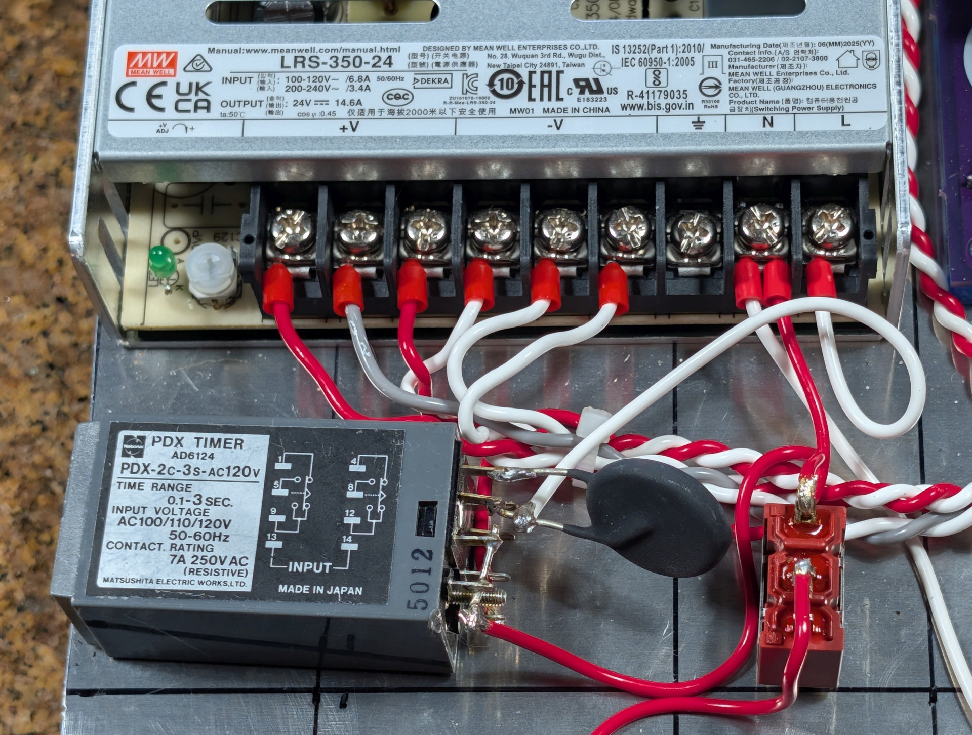

The power switch I used, supposedly rated for 8A, welded its contacts in the ‘on’ position about the 3rd time I used it. The power supply specs say inrush can be as high as 60A! I have ordered some NTC inrush limiters to install, along with a new power switch.
The LEDs are powered from the 24V supply in the table. I have decided that isn’t ideal because I’d like to be able to stop the table from erasing a drawing and leave the LEDs on, so I’m going to install a separate AC powered supply for the LEDs with its own power switch. That way the table can run in the random sequence mode and if I see a drawing I’d like to leave on the table for a while I can switch off power to the controller board and leave the LEDs lit. Or if I’m watching TV in a darkened room, I can switch off the LEDs whether the table is running or not.
I found that a comb does a nice job of spreading the sand after the table has run for a while and pushed the sand toward the edges of the drawing area. I got myself a new printer for Xmas and decided to test it’s multicolor capabilities by printing a comb for Arrakis 3.0.

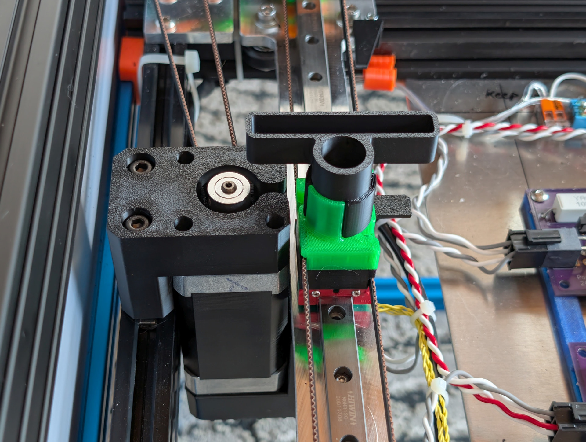

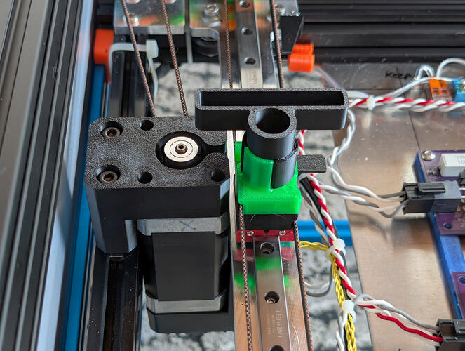

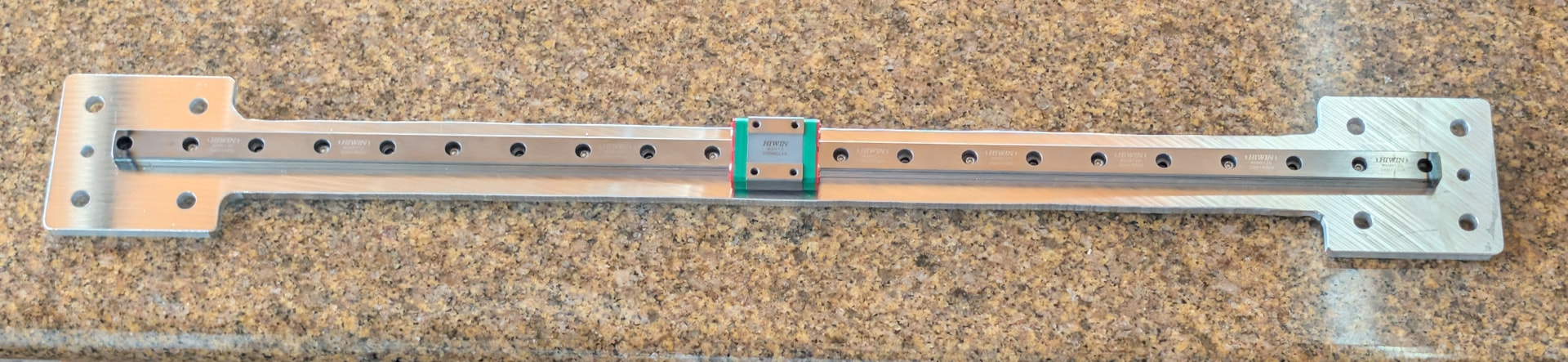

I made some major changes to the Arrakis 3.0 mechanism. I discovered that after only two months of operation, the V-slot wheels were wearing badly. I chalk this up to my inexperience with designing around v-slot wheels. I’m not sure I like them.
I have corrected the design, I think. I fabricated a 1/4” tooling plate base for the X axis, and that necessitated reprinting the pulley standoffs at the corners of the table, the motor mounts, the homing sensor mounts, and the magnet carriage. I’m still not sure about using 4 wheels at each end of the X axis, but we’ll see how they wear. I think I prefer sliding UHMW bearings (like Arrakis 2.0) for reliability and long life, and may yet convert to that.

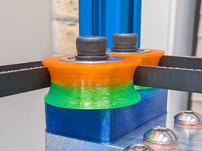

The 3D printed PETG concave pulley flanges and belts seem to be holding up well with no signs of wear except for some small rubber crumbs around some of the pulleys.
I had twists in the belts in the short segments between the drive pulleys and the corner pulleys. I decided to try moving the twists to the long segments between the corner pulleys at opposite ends of the table, which should reduce belt wear. It seems to be OK that way- there are no clearance issues, and the noise level doesn’t seem to have increased even though the belt teeth are hitting one of the corner pulleys.

I used a small, 6A rated switch for main power. The table has a 350W power supply, so 6A should be plenty, right? Nope! The switch contacts welded in the ‘on’ position about the 5th time I switched on the table. I checked the power supply specs and found it was rated for a maximum inrush current of 60A! I installed a 16 Ohm, 5A, NTC thermistor and a 3 second time delay relay, and a 10A power switch. Now when I switch power on, the thermistor limits current to the power supply and after 3 seconds, the relay shorts the thermistor. No more power switch problems!

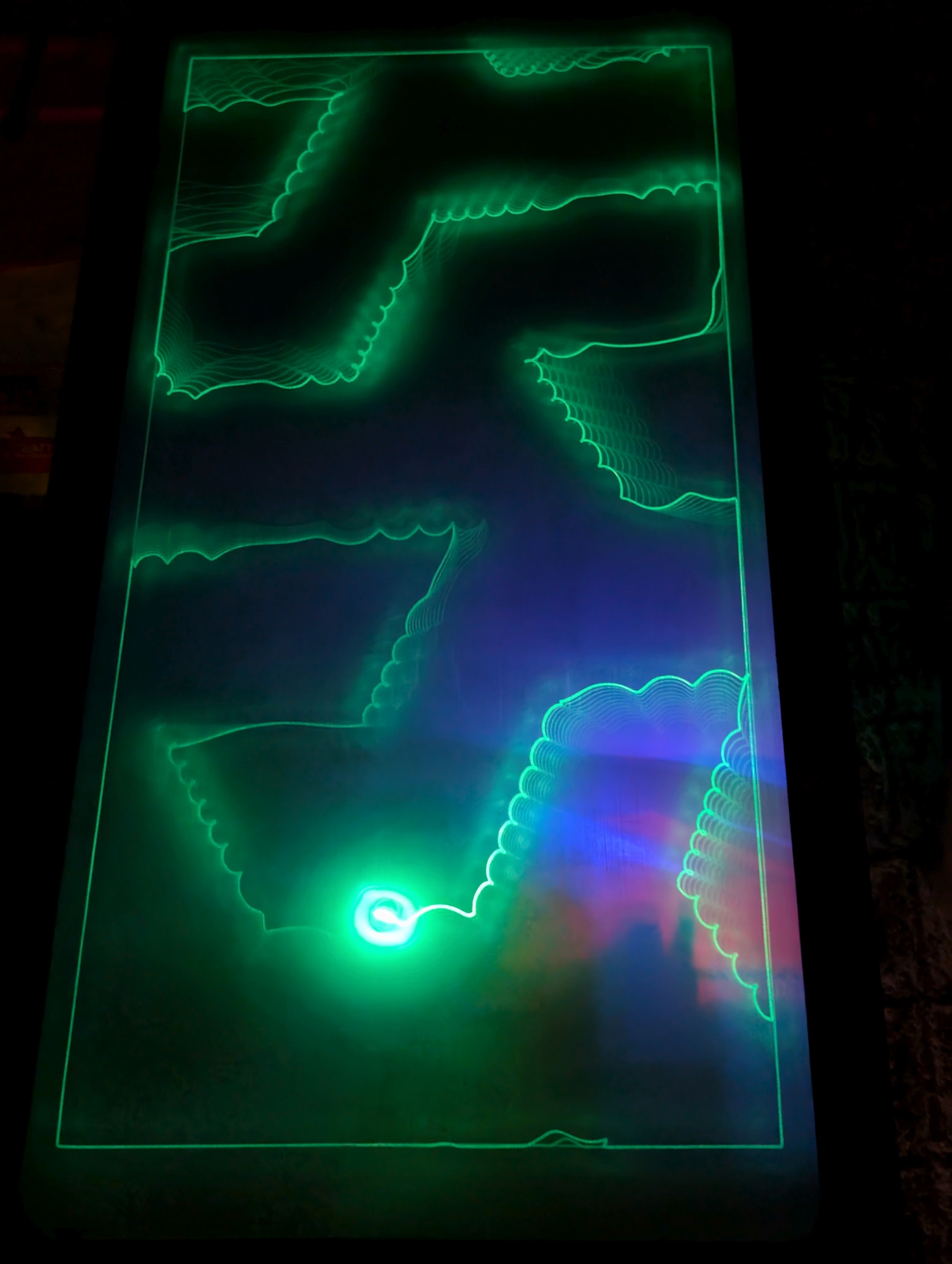

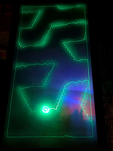

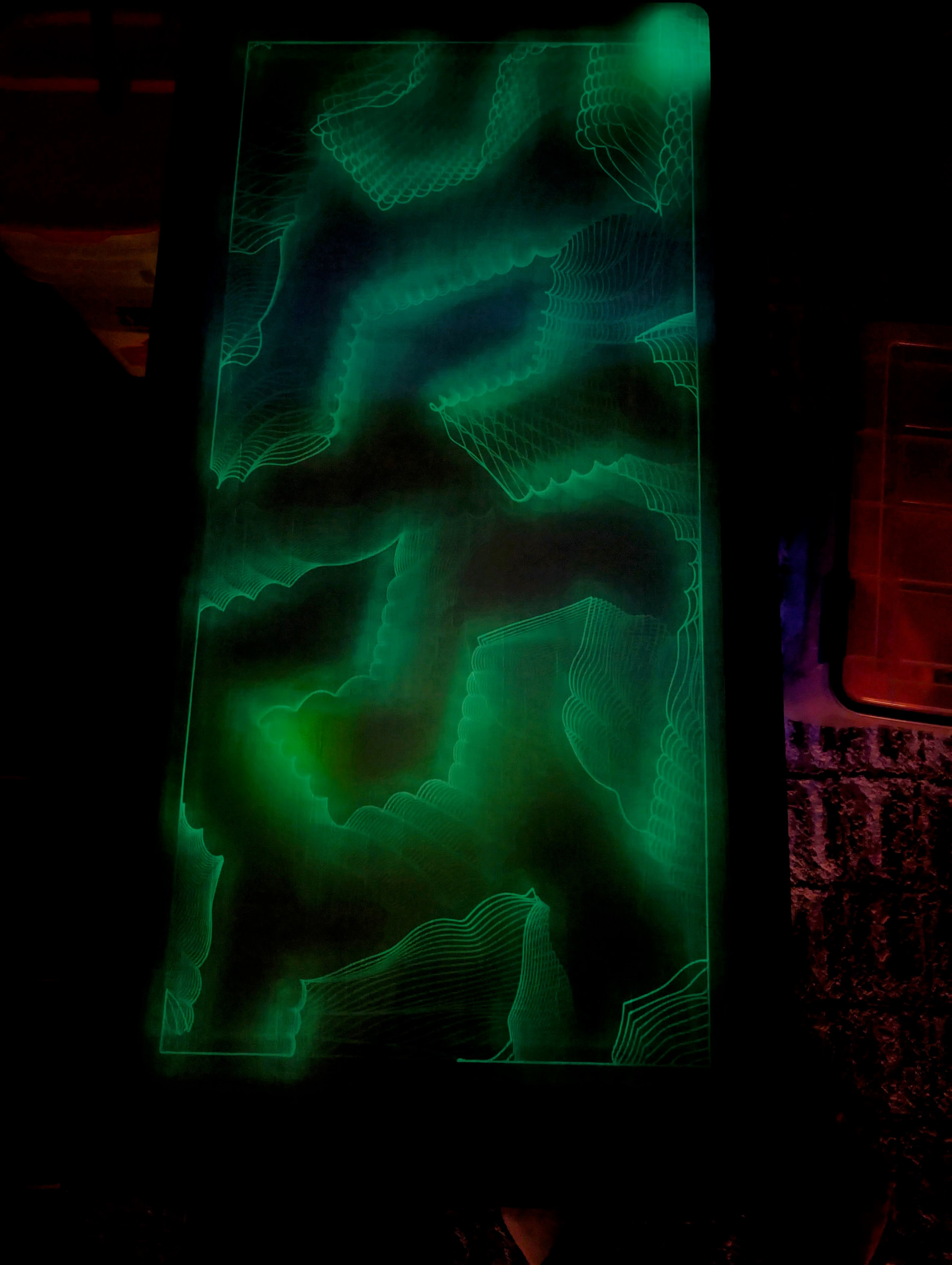

I made a second sandbox-type frame using 2060 v-slot to fit on the table, painted the underside of the glass top with three coats of strontium aluminate glow in the dark paint, and designed and printed a module to fit in place of the magnet. It includes a NC reed switch to turn off a 5 mW 405nm laser. A magnet on a bracket near the home position will switch off the laser when it isn’t drawing (I haven’t designed this part yet- for the initial test I just moved the magnet by hand).
Here’s the table with the painted glass top sitting on the 2060 v-slot frame. The pale green color is the paint glowing, even in daylight:

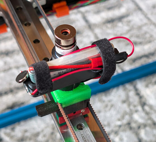

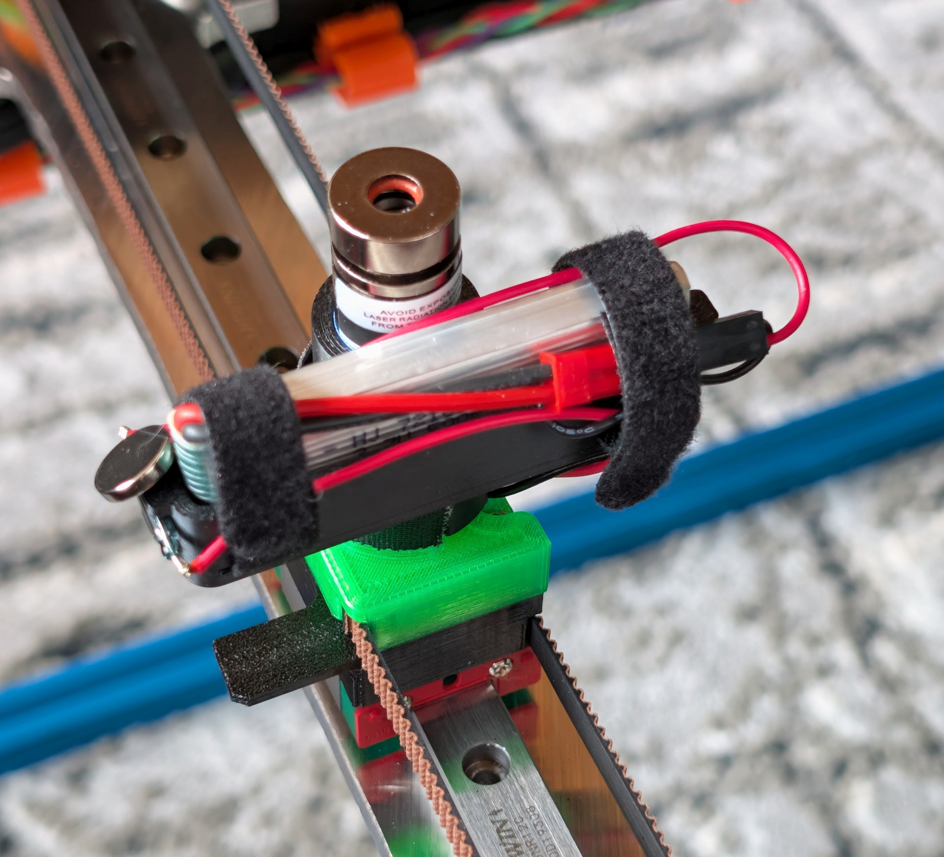

Here’s the 3D printed laser module being tested for clearance with the motor mount:
Here’s the assembled laser module with a small magnet hanging on the reed switch to keep the laser turned off. The battery is a 500 mAH LiPo type:
I did the first test last night, which pointed out a few problems.
  1. status LEDs on the controller, motors, and other electronics light up the table in red and blue- I need to put some tape or a cardboard barrier on them.
  2. the thing is uncomfortably bright when it’s running- maybe best switch to a LED instead of a laser.
  3. there’s a large halo of light around the laser beam that wrecks the contrast of the drawing- I might be able to make a mask that will reduce that, or maybe just move the laser much closer to the glass.
  4. I need to crank up the speed and acceleration - the first test was a pattern with lots of curves and with the acceleration at 10000mm/s^2, it was too slow even though I set the speed to 1500 mm/sec.
On the good side, the drawing looks almost 3D because the most recent lines drawn are brightest while the older lines are fading away. You also don’t need to run any erase patterns as the drawings fade away on their own. OTOH, the drawing capability isn’t really usable in daylight hours.
More tests to follow.
Don’t worry, there’s still a sandbox with a new glass top available. It takes about 3 minutes to convert the table from sand mode to laser mode and about the same to convert it back. Handling the glass is the most difficult things to do because of the weight. I bought a couple large vacuum handles that make the job a lot easier.
This is very cool, especially the fading of the older vs the newer lines. It reminds me of Tron
I did a little more work on it. Getting better.
The halo around the beam is a problem. I didn’t see it when I was just holding the laser a few feet from the painted surface– in that case the halo was spread very wide and so relatively dim. In the table, the laser is much closer to the paint, so the halo is smaller and brighter.
I printed a tube to fit over the laser and drilled a small aperture hole for the beam, but the halo is still there, even though the aperture is now about 3 mm from the painted surface of the glass. I think it is caused by reflections off the walls of the hole in the tube. I’m going to try cutting a clean hole in a piece of aluminum foil to use as an aperture and minimize the halo.
