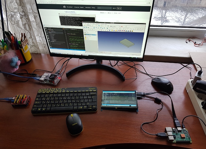

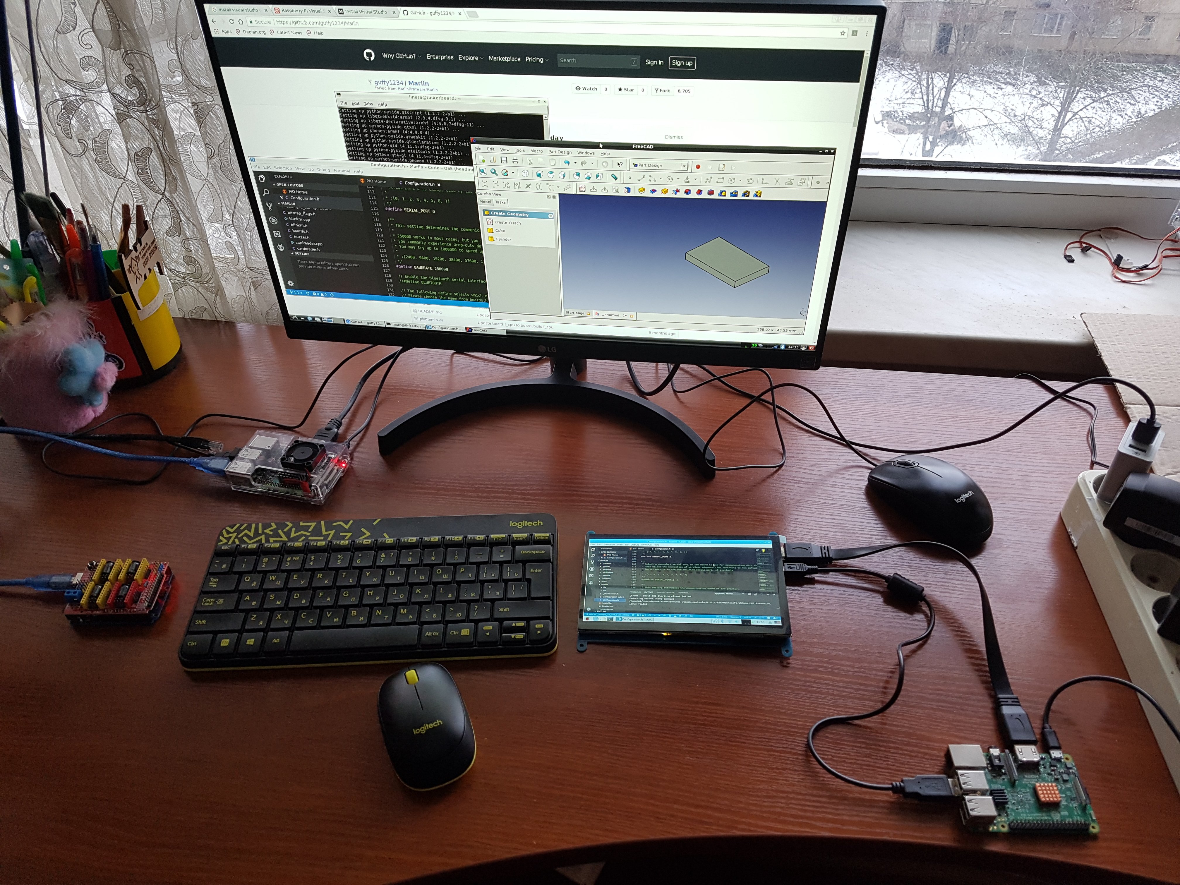

It seems i have solved
[attachment file=90440]
  1. if you need freecad arm 0.16 - stay on debian. No ubuntu
  2. Beauty armbian over tinkeros is just xfce desktop vs openbox
  3. Chromiun 72 doesn’t work on debian. Use 71 or less
  4. Visual studio code also doesn’t work if it 1.32. 1.29 works
