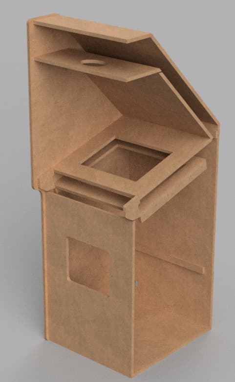

I started from a 3d model one f the members did with onshape, and tweaked/adjusted a few things
I mainly added some dowel-pins holes to align and hold the elements

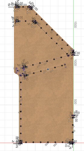

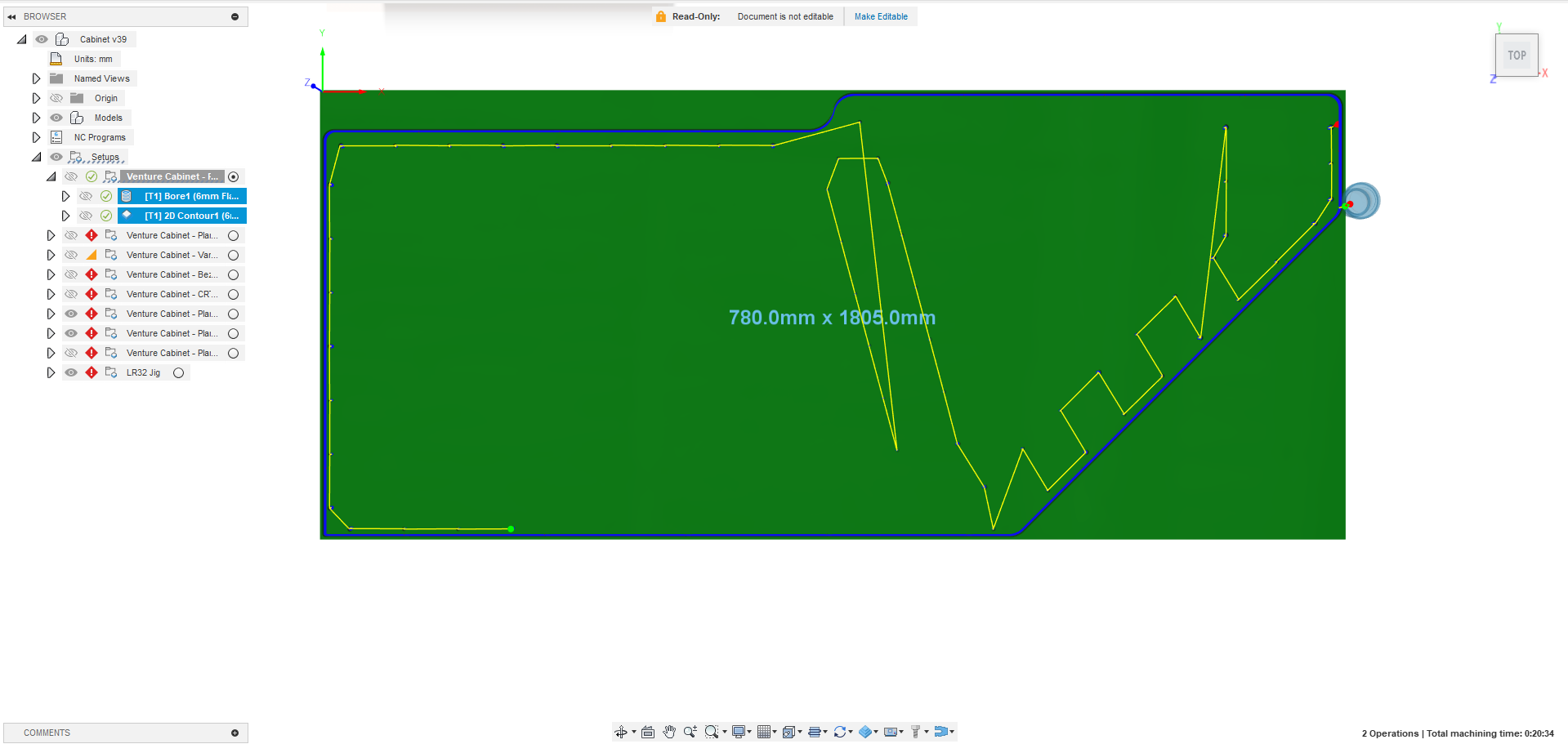

Again, I used Fusion360 MapboardsPro plugin to lay out the parts
The model spans across 3 whole 18mm MDF sheets
After tinkering quite a bit and doing some complicated maths, I got this part layout which allows me to split some of those sheets in 2 or 3 for easier transportation

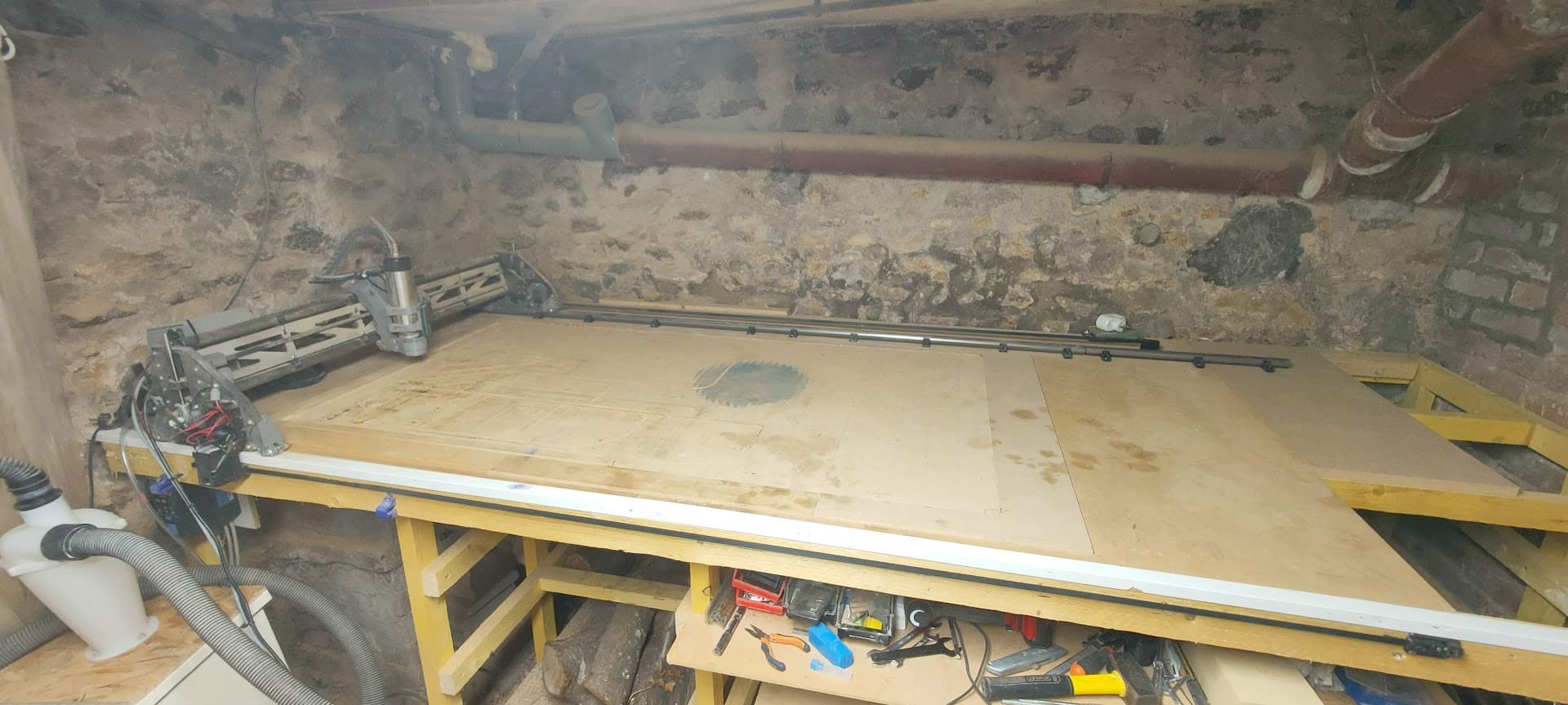

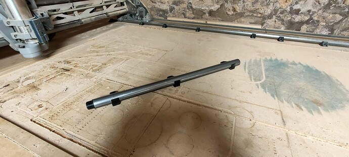

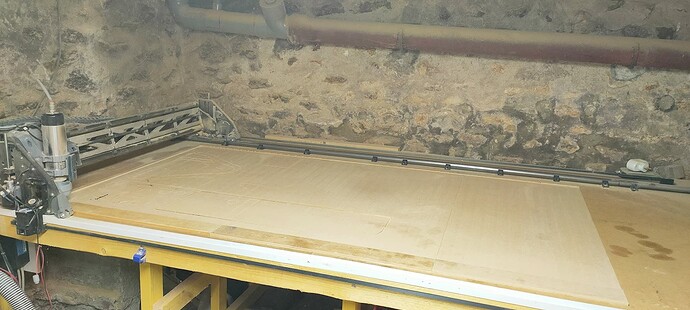

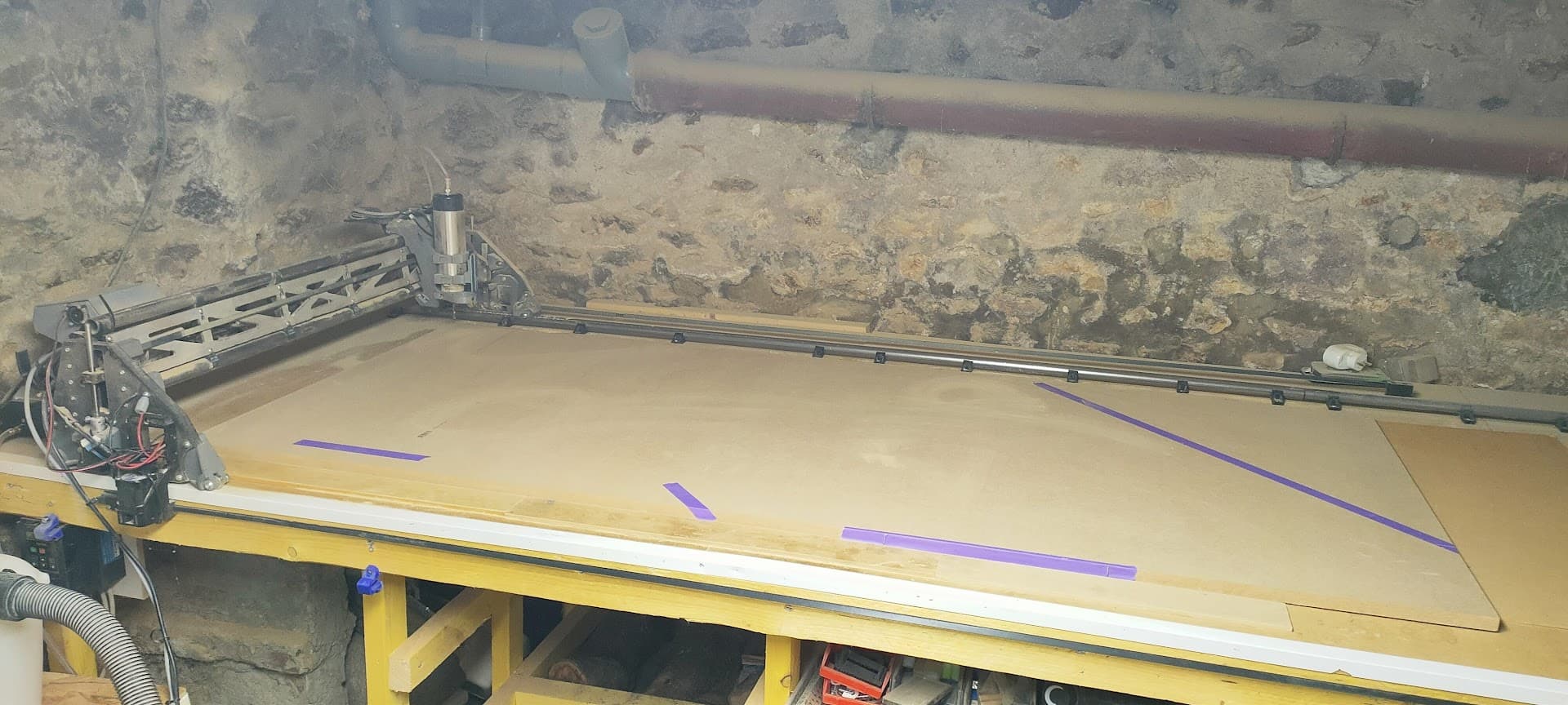

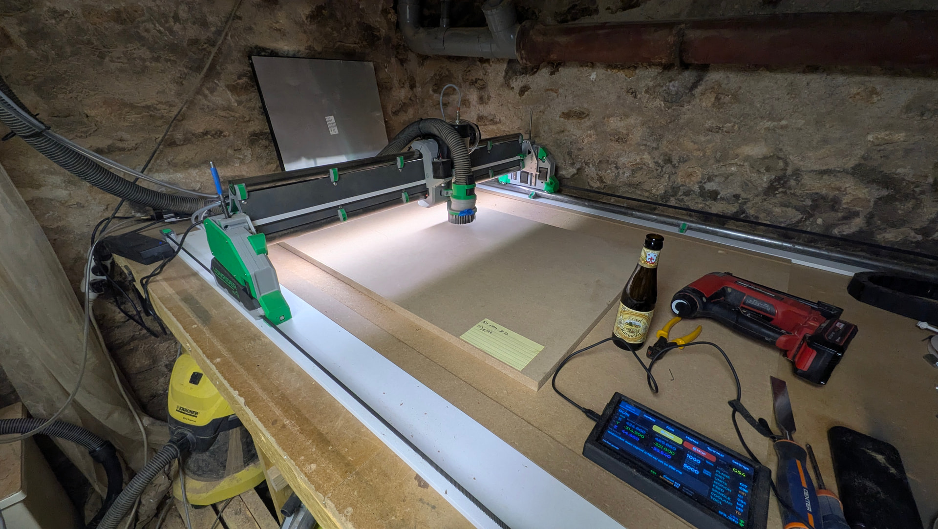

The first one here, is that my LR3 isn’t long enough on the Y axis to fit the side panels
Nothing to worry about though, I added a small Y-rail extension (witha 3d-printed insert to keep everything aligned) and changed the Y belts for longer ones

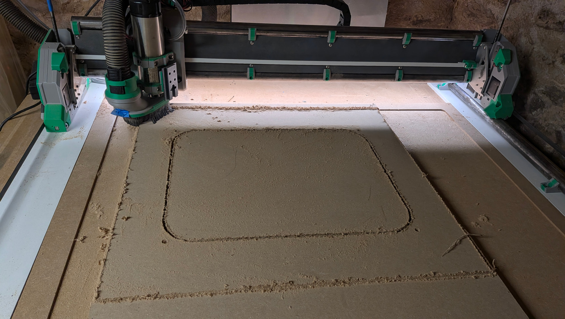

Then it was time for side project 2: re-surfacing the whole board - Y extension included
Of course, when you have this kind of project, be wise and always start by cutting the smallest part first! :slight_smile:
And then skip directly to the largest one :smiley:

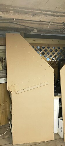

Also maybe check before assembling that your basement’s ceiling isn’t too low :stuck_out_tongue:
I got lucky on this one :slight_smile:

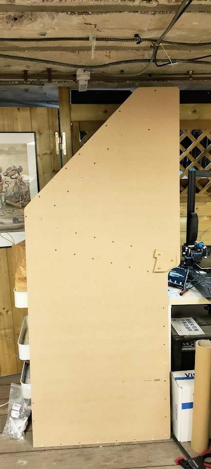

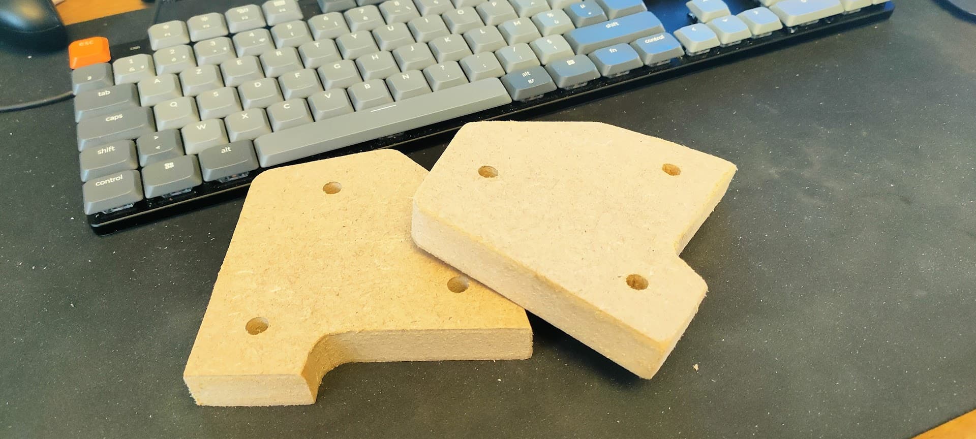

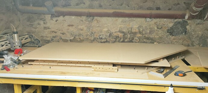

For some of the parts, I skipped a step and crudely cut the chamfer directly on the CNC
Those edges will be hidden, and it just avoids having to cut them with the circular saw…

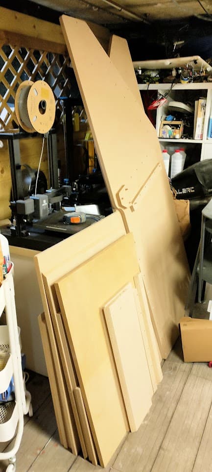

Then it’s just a matter of cutting different parts for almost a whole week :slight_smile:

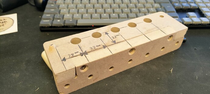

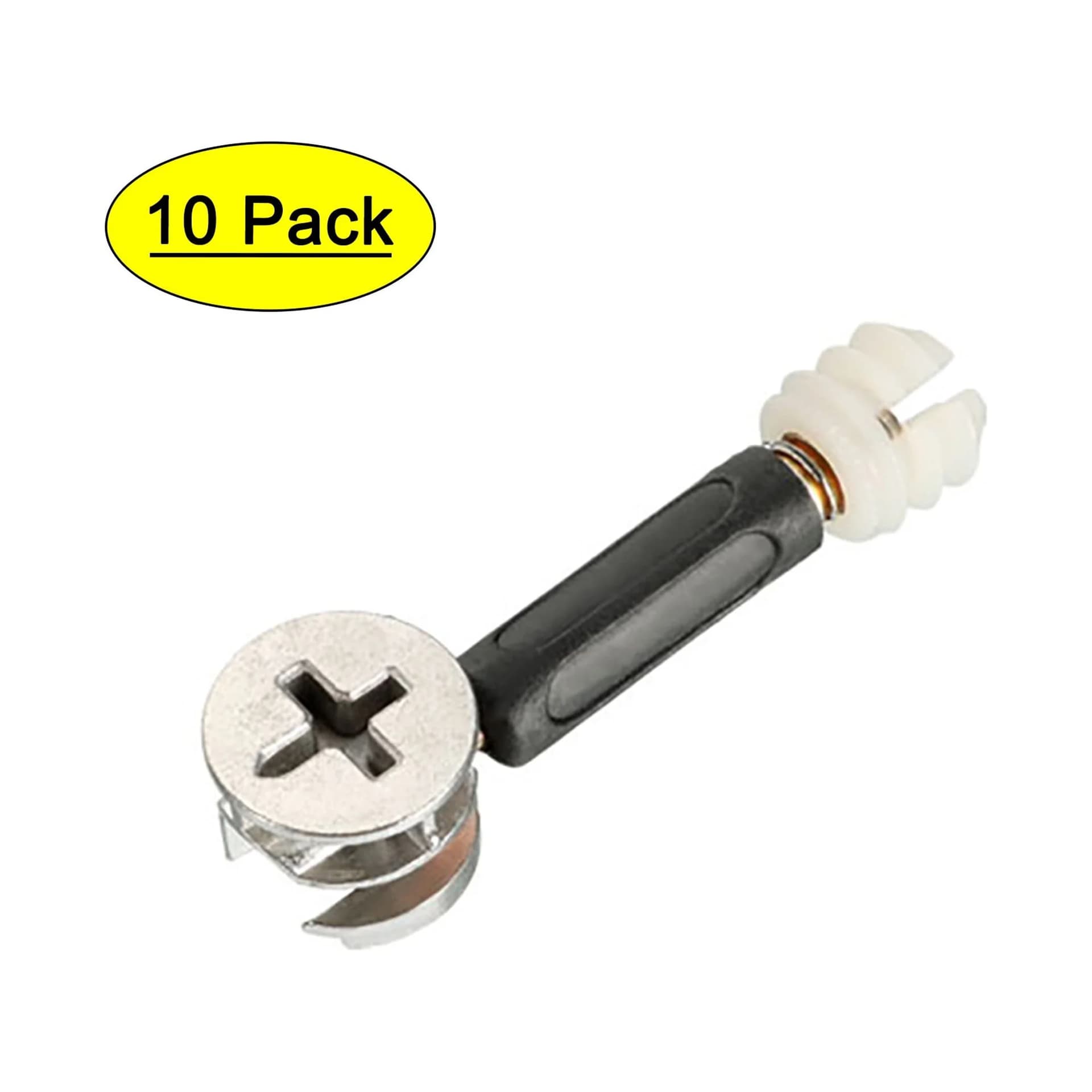

You may have spotted some larger holes and white “dots” on the sides.
Those are holes and inserts for metallic dowels and cams that will “lock in” the parts

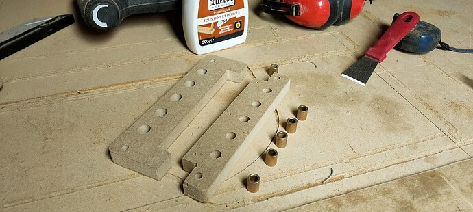

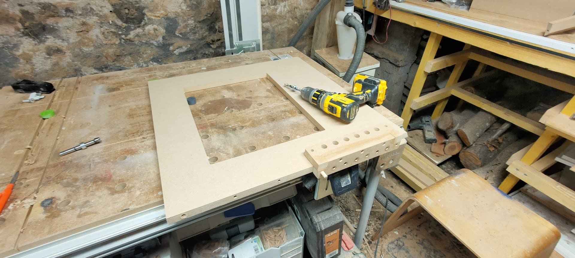

While I can mill out the holes on the faces of the part, I can’t access the edge, so it’s time for side project number 3!
I designed and cut a small jig to locate and drill the different holes for those cam and dowels
I used small brass bushing as drill guide for the dowels, but it’s mostly a throw-away jig so I didn’t bother too much about it wearing out

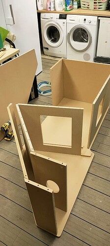

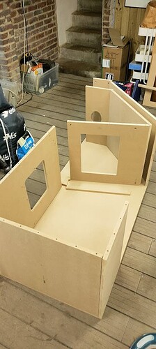

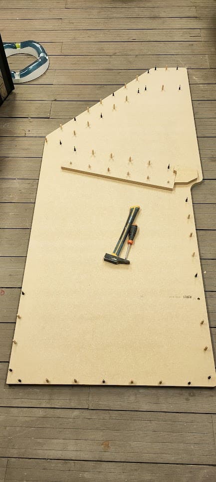

Assemble, glue-up and fasten with screws…
And then just spend half of your weekend drilling various holes (making a few mistakes and starting from the wong side for a few of them, of course…)
All done
Time to start the assembly
Note: too many dowels… really… >_<

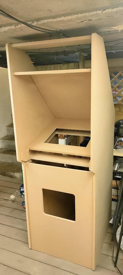

Now the cabinet has been delivered to the association for installing the electronics, painting and adding trims and vinyls
I’ll add some follow-up picture when/if I get some :slight_smile:
Looking back at all the work it involved, I said yes just a bit too fast but in the end it was a fun project :slight_smile:

Looks great. How long did a large piece take to make on the cnc?
That’s approx. 20 minutes per side-panel (not pushing it)
8 minutes for boring the holes / 12 minutes for contouring the part (3mm passes)

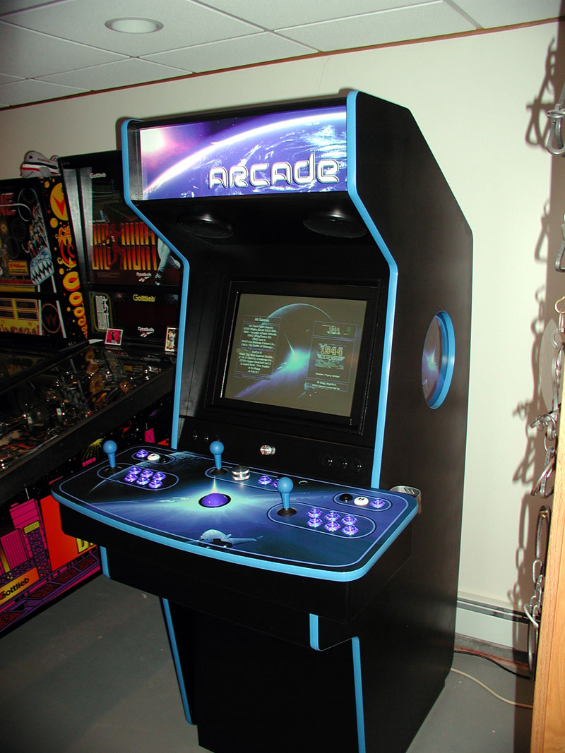

Found a pic of the finished cabinet…

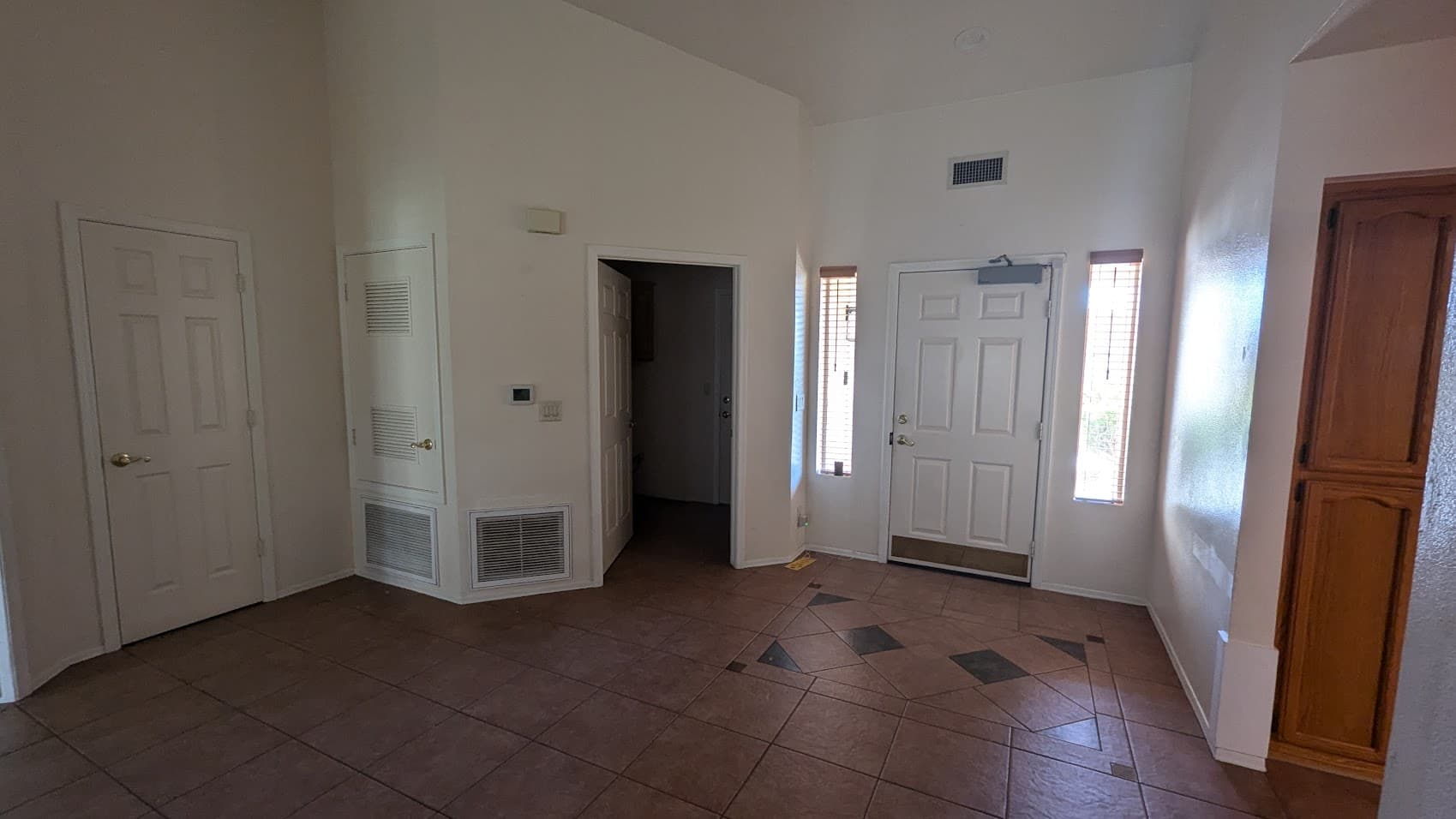

But…the timing of this topic just sparked an idea. We have a closet in our front room - it’s meant to be a coat closet but we live in the desert so don’t really use coats and instead it’s a cleaning supplies closet. It’s the door on the left here:
For reasons I can’t adequately explain it bugs me…it just looks out of place to me. So the idea of hiding it has occurred to me. I was thinking about making it into a “hidden room” with a bookcase facade because that’s something I’ve always wanted. But I don’t really need or want a bookcase there.

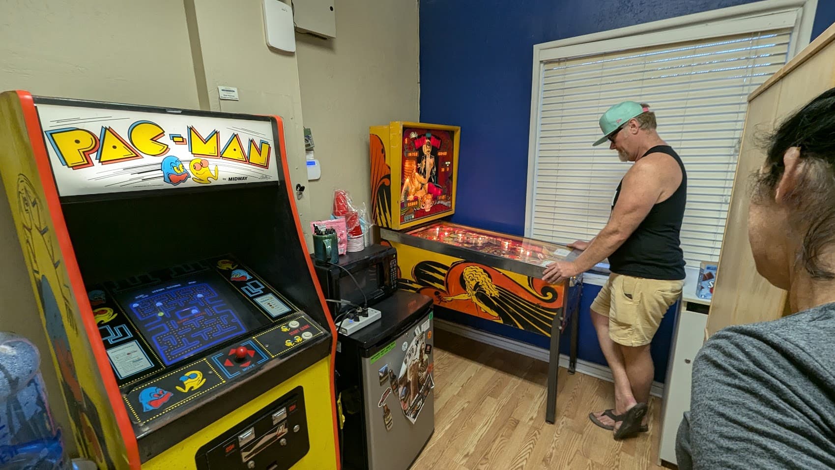

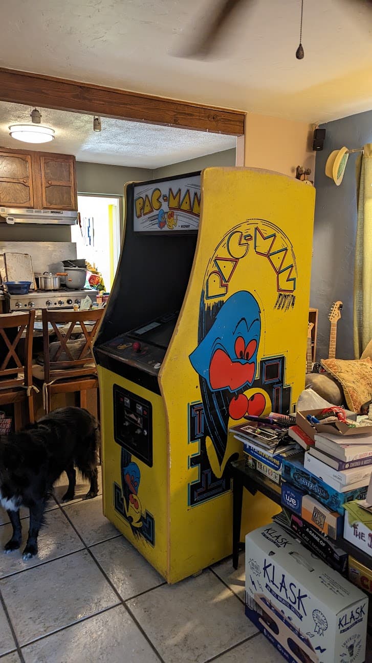

Very true. I’m ‘responsible’ for an original pacman and a mata hari pinball that my boss literally dragged out of a barn a few years back:
Having it in my living room for a day made me realize just how much larger these things are than they seem in a commercial setting:

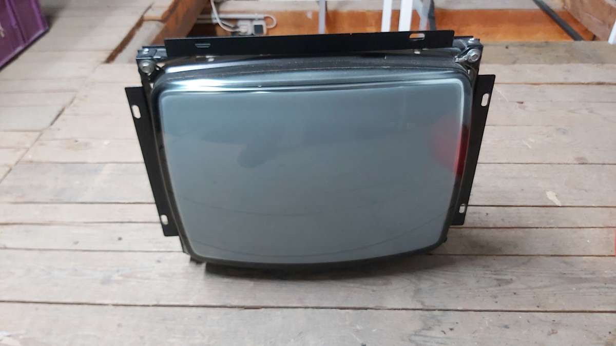

The pacman actually fired right up once I cleaned some mouse nests out of it and washed off all the dirt. But the first day we had it in the office the monitor died after a few hours. I ended up doing a recap on it and it’s been going strong since…but it does start to freak out and reset randomly after being on for a few hours and I still haven’t figured out what’s causing it. The power supply is literally two transformers on a board:
Most likely it’s the main board edge connector which is notorious for having insufficiently large traces on the power pins. But…it’s good enough for us…just means our high scores don’t last more than a few hours. And since we turn it off at night that’s not a big deal since pacman only saved a single high score and it was lost at power off anyway.

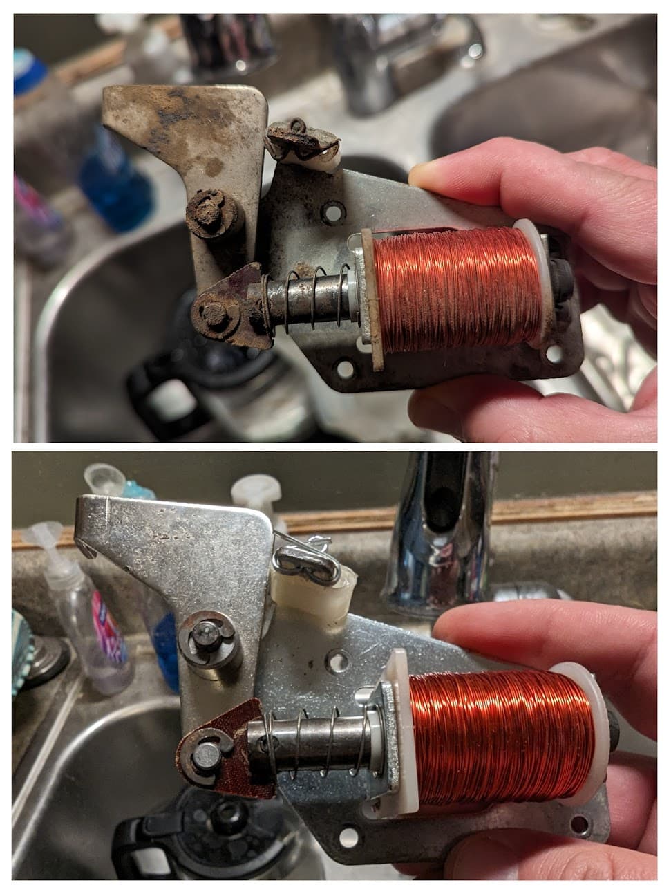

Still had to do thigns like strip down and clean most of the mechanics:

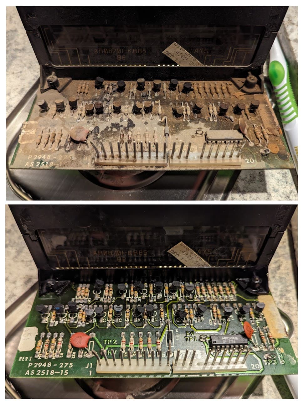

And even the Display units had been used as mouse urinals…but a visit to the ultrasonic bath cleaned them up was better than I expected:

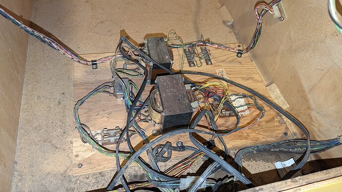

One display was totally dead and did have to be replaced with a modern LED replacement. But otherwise I was able to keep it all original. It did take two weeks of tracing wires to track down one fault in the lighting but the rest was fairly standard cleaning and replacing old rubber.
Unfortunately last month we turned her one one morning and she didn’t boot. Yesterday I finally brought in my test gear and started ivestigating only to find that the 5v test point on the MCU board is showing 24v :fearful: haven’t found exactly what went wrong yet but some kind of regulator failure appears to have occured and now all of the IC’s on the MCU board are probably toast :frowning:

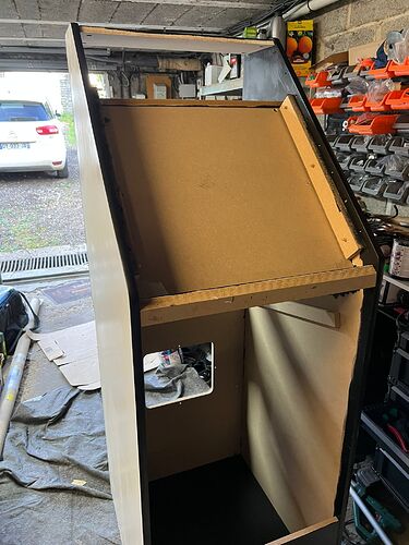

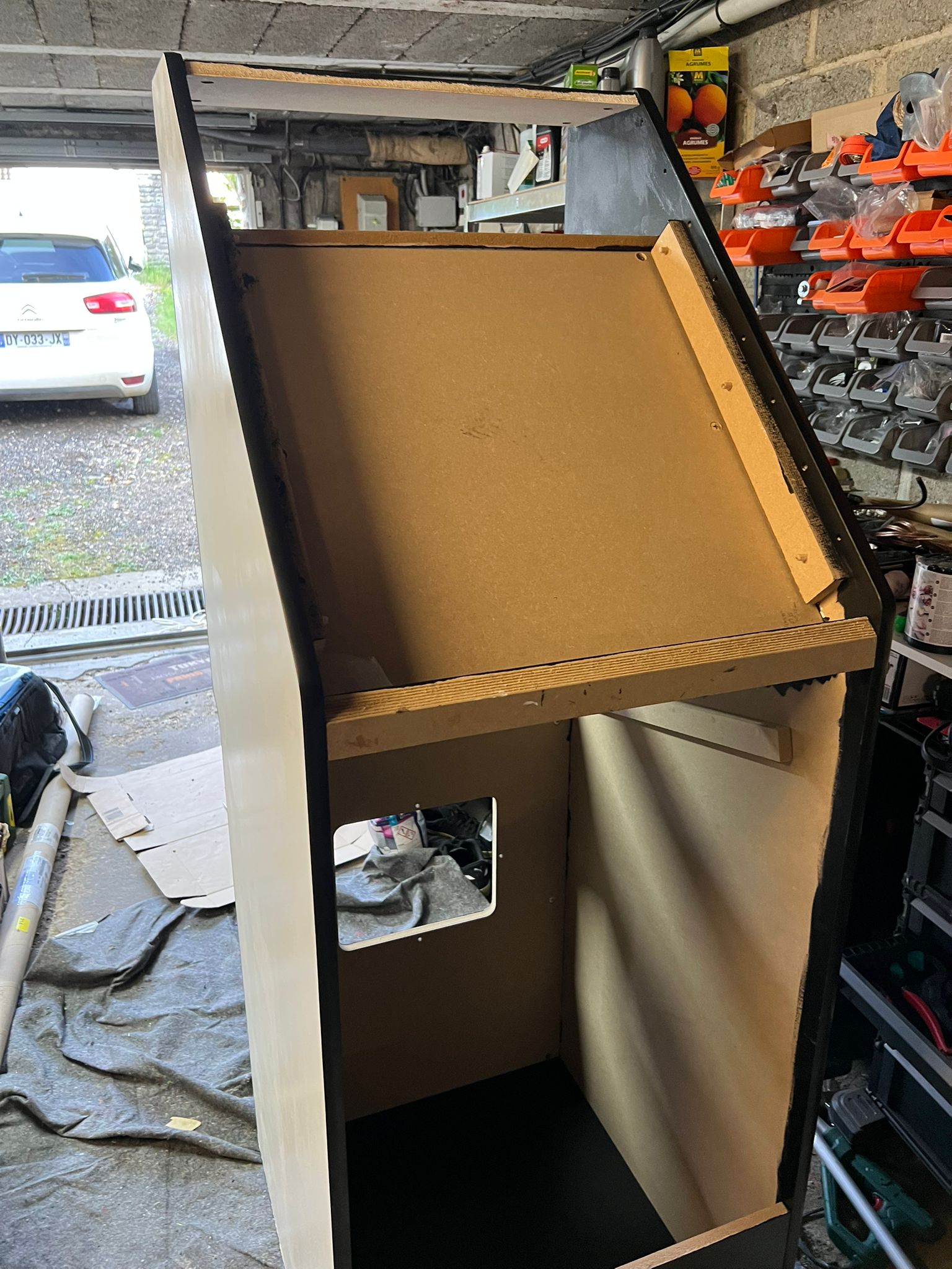

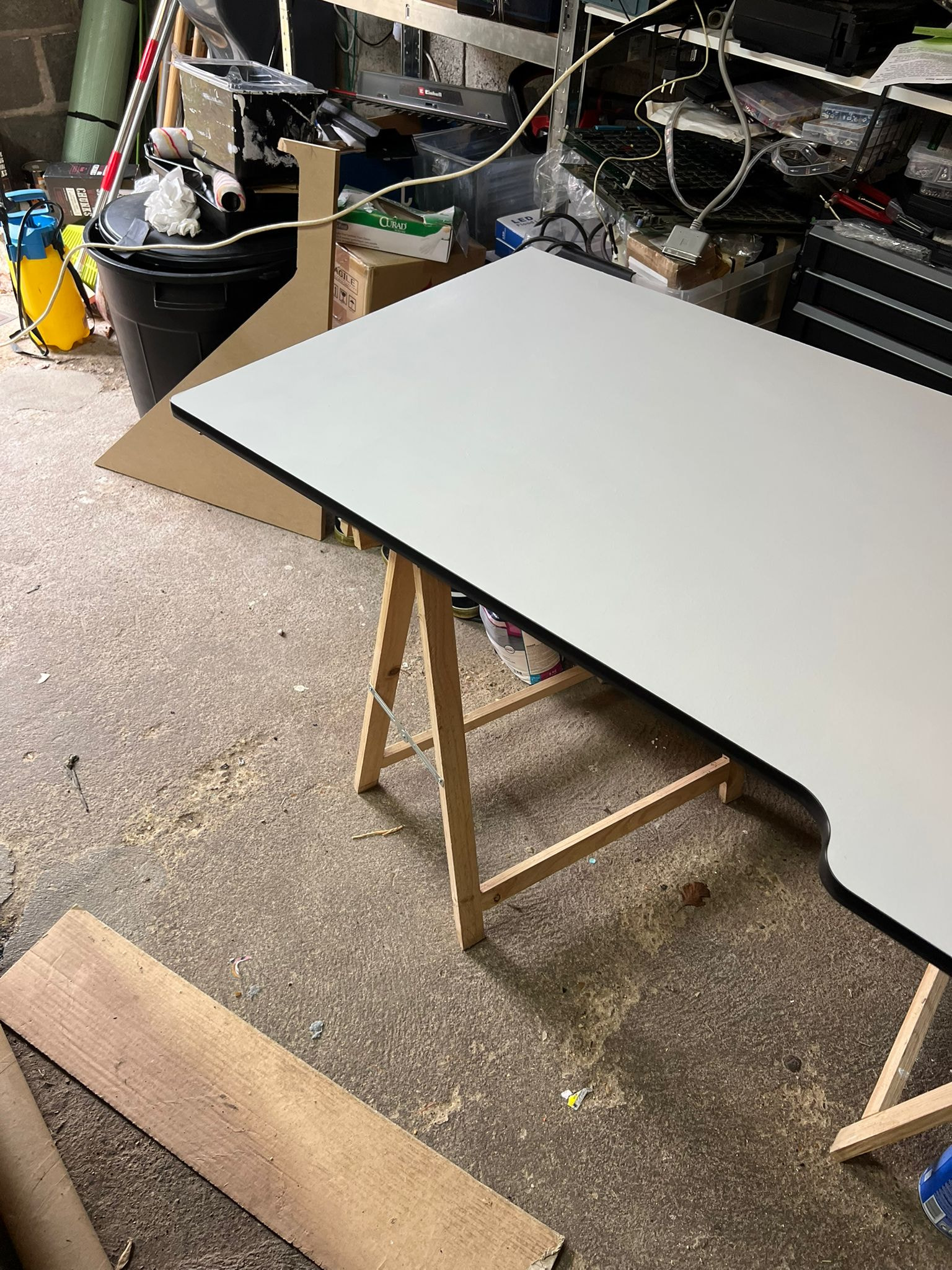

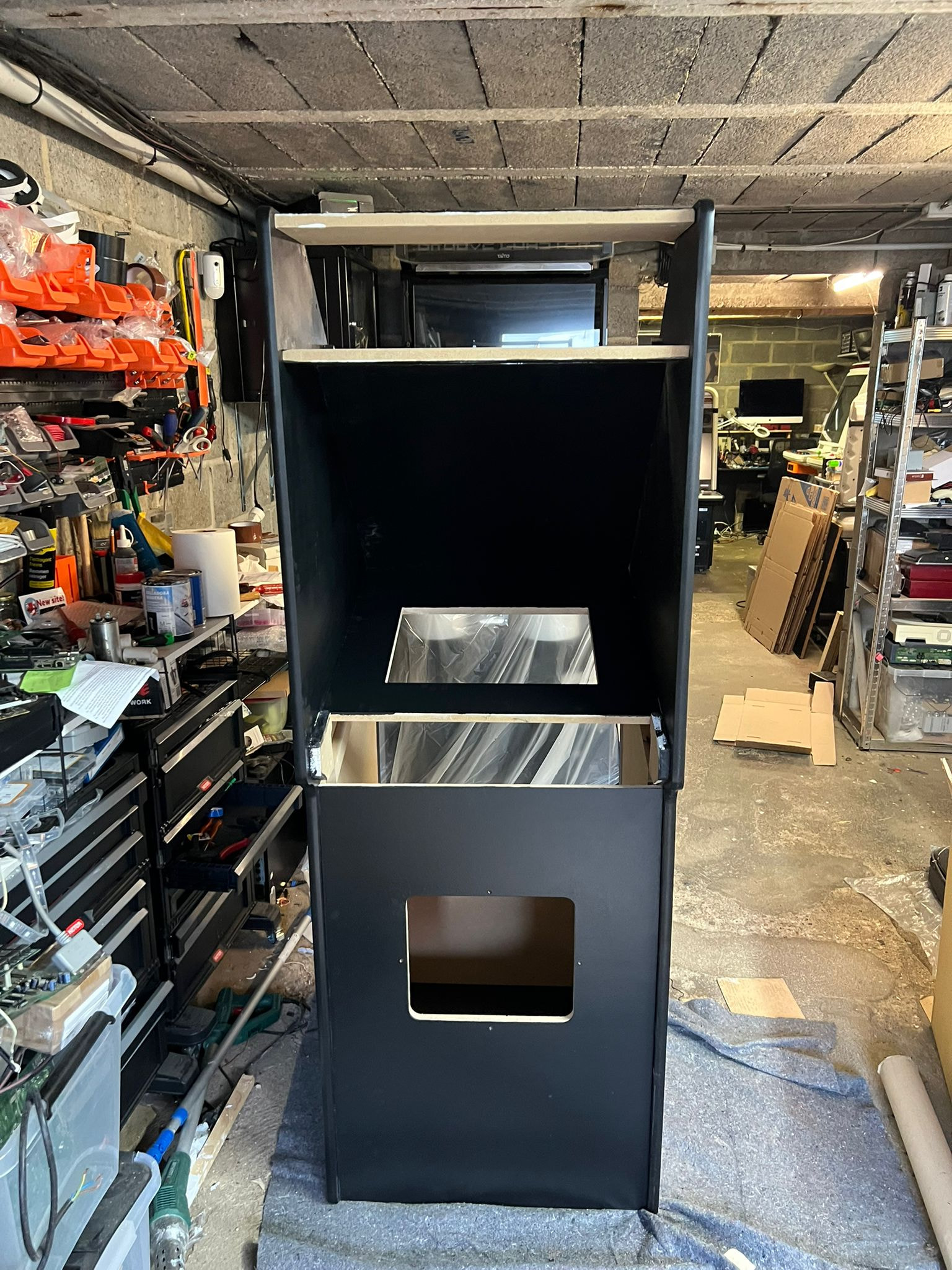

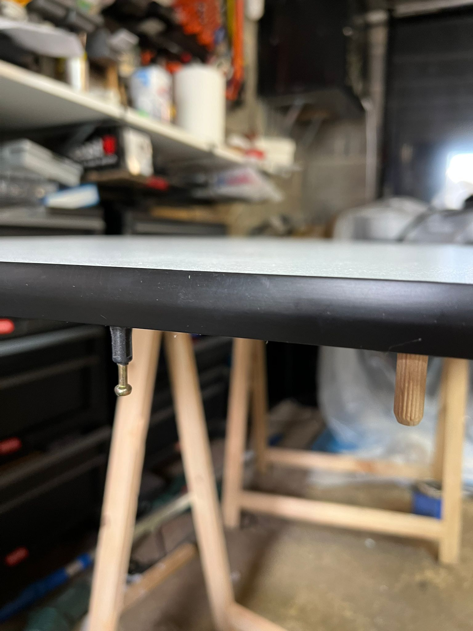

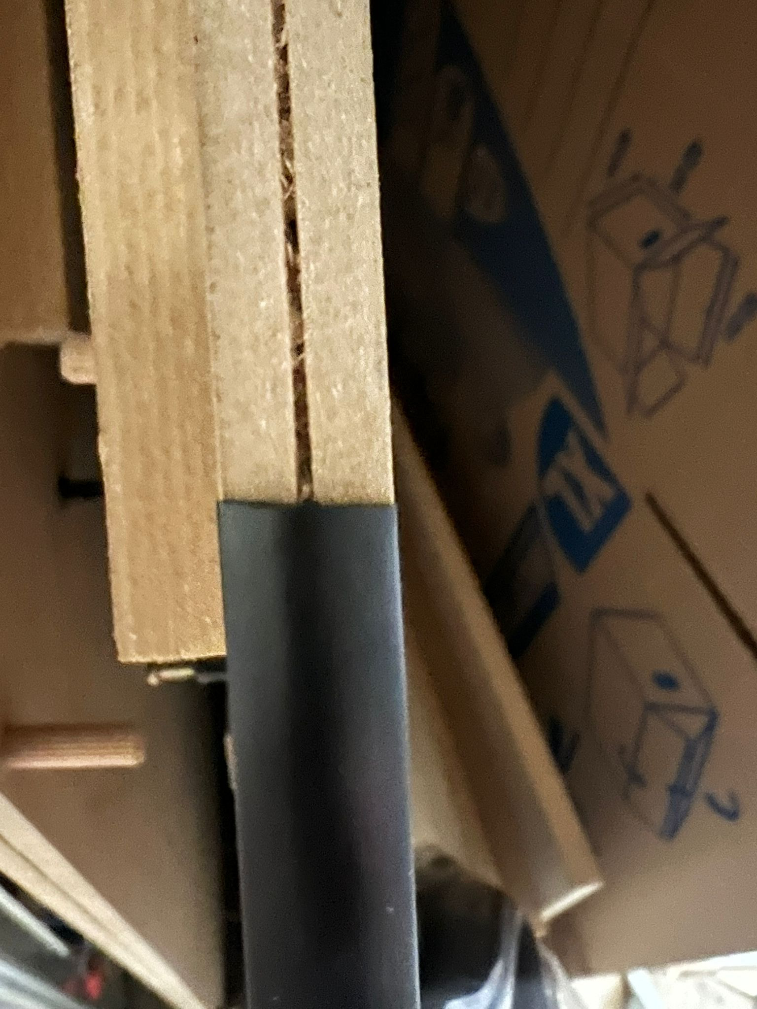

Almost a year has passed… My friend just started the paint and binding…
Happy to see this arcade coming to life :smiley:

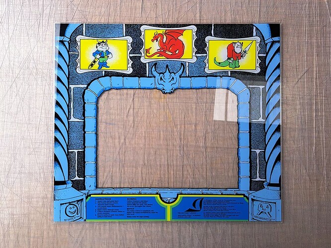

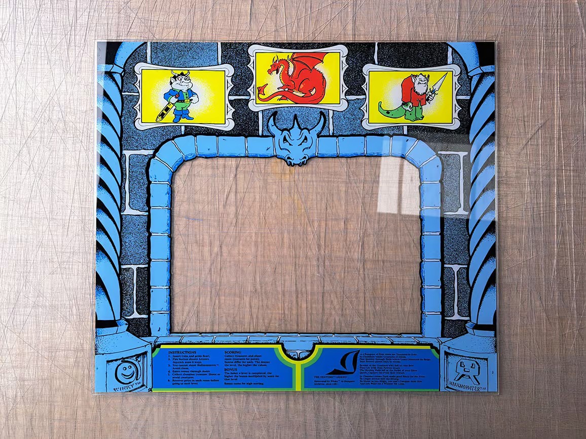

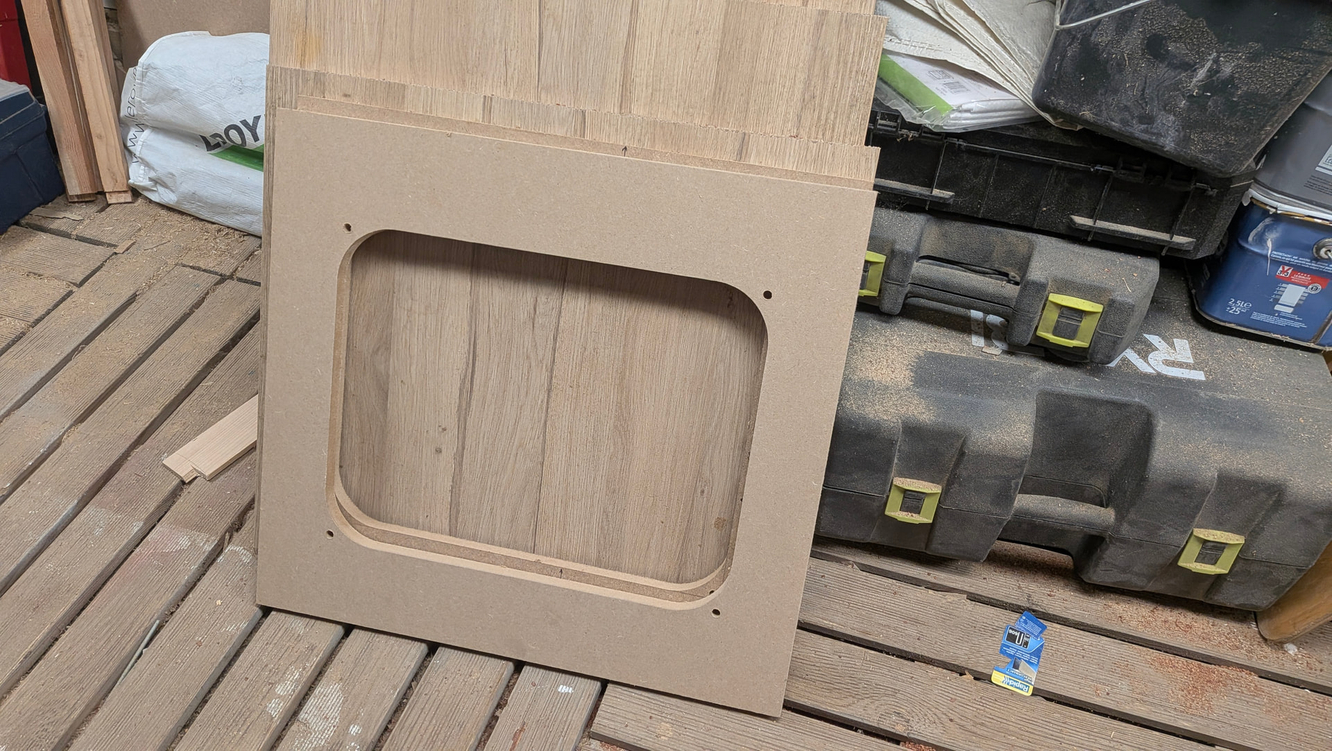

Oh yeah and of course, the position of the screen in it’s panel doesn’t match the bezel
So this cabinet will have lr3 and lr4 machined parts :slight_smile:
