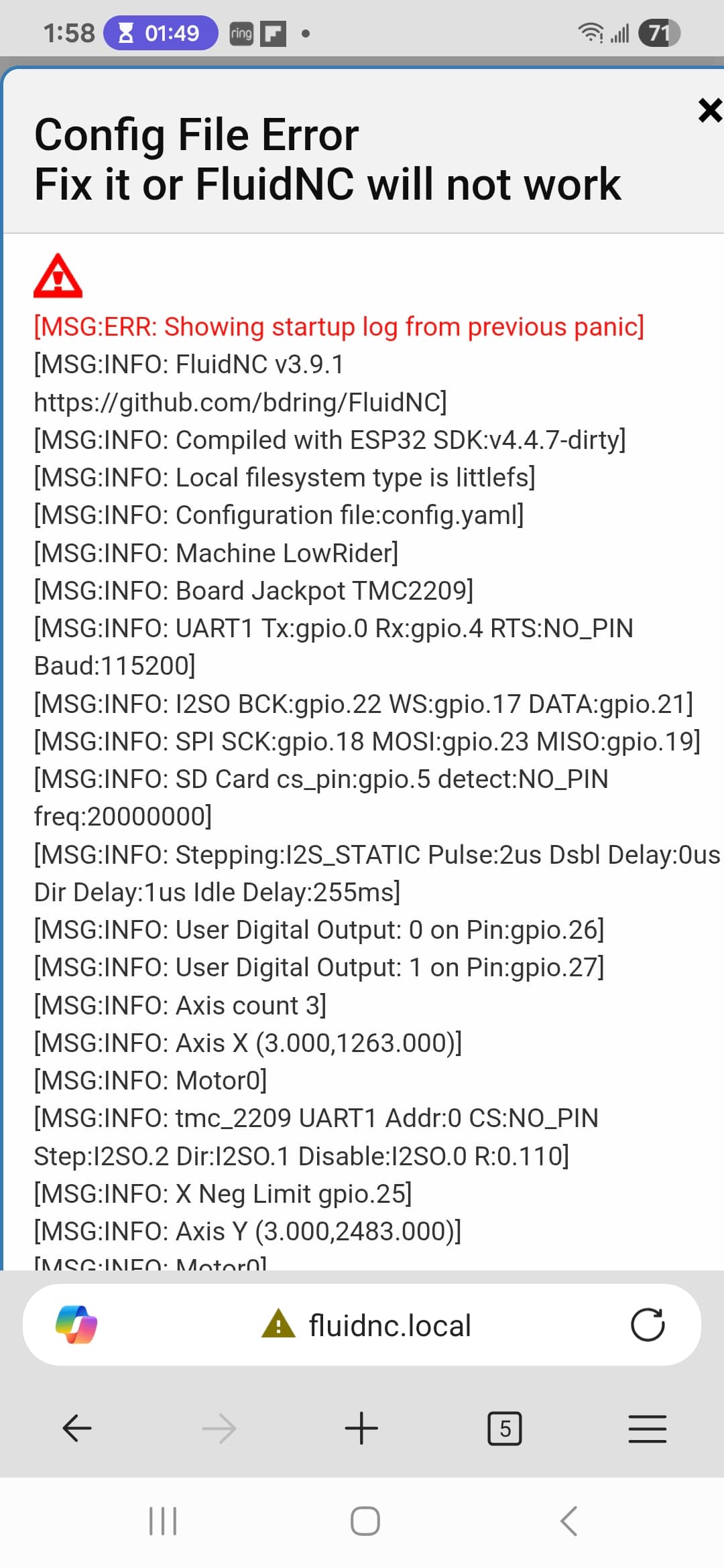

And there is always a caveat. When I paused interacting with the board for a while and went back to it, the connection had dropped. Connecting back to the board, within the first three lines I had a message about a panic error related to the config file. My phone had already auto-connected to my home network, so all I could do was take a screenshot.
Today I will reload the published config file using my PC and get to all the other suggested steps.

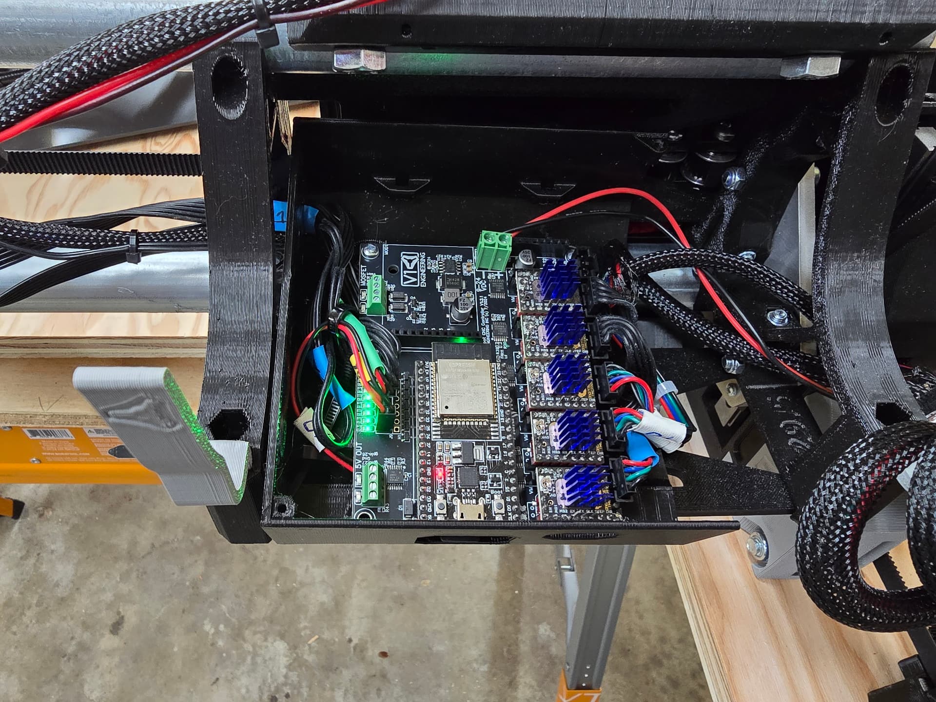

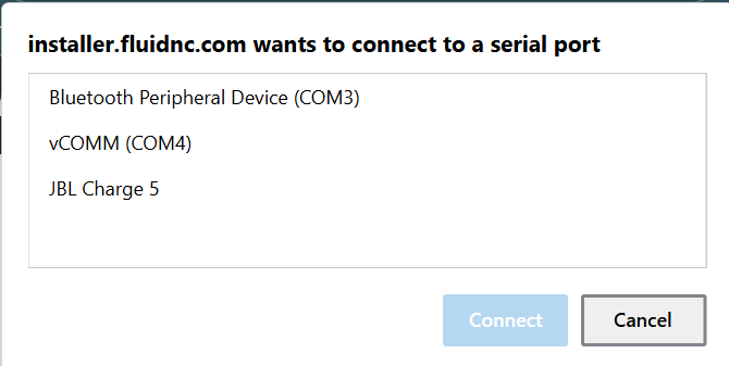

This turning into another rabbit hole. First surprise (to me at least) is that my ESP32 board uses a USB-A connector and not USB-C as expected. Got over that one because I have a LOT of cables and adapters on hand from years of changing standards.
Second, the board is showing up in Device Manager, but not in the FluidNC web installer. I was hoping not to install the desktop version for something I don’t plan to do very often.

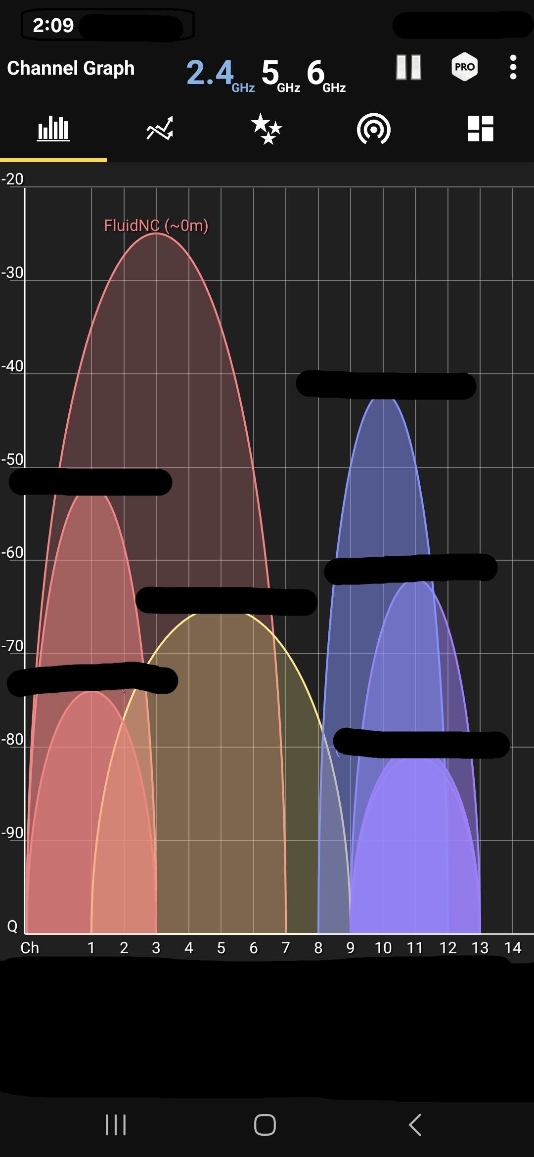

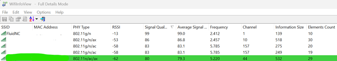

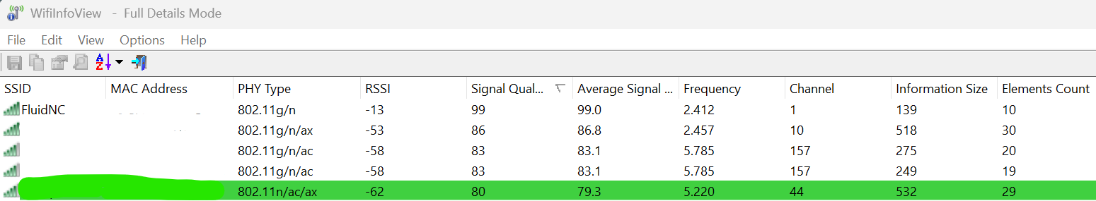

Signal levels all look good. 2.4GHz is a little crowded, but as expected FluidNC is the strongest signal since I’m practically on top of it.
Android phone (via WiFi Analyzer):
PC:
No, they are not.
Levels are marginally better but considering you are next to it, you have interference.
Do you have any control over the other devices?
You really want either an open channel or to join FluidNC to an existing WiFi AP if possible.

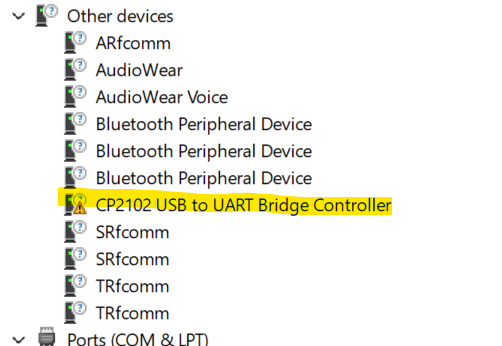

The reason for my COM port issue was stated, right there in the documentation:
“Some PC’s will need USB drivers if your ESP32 is not recognized by the computer. If needed the ESP32 USB drivers are here Silabs CP2012 drivers.”
So, I navigated to Silabs CP2012 drivers, downloaded CP210x Universal Windows Driver and installed silabser.inf. Restarted the computer and boom! I was able to connect to fluidnc.local over my WiFi.
Hope the following summary helps the next person with this issue.
In short: AP mode can be unstable when the WiFi has a lot of interference. Once your device is setup and doing what it’s supposed to, switch to STA mode by following the instructions at the Fluid NC Wiki for connecting via your local WiFi network. If during that process your ESP32 is not recognized by the computer, try updating the drivers on your PC by navigating to Silabs CP2012 and installing the universal driver.
