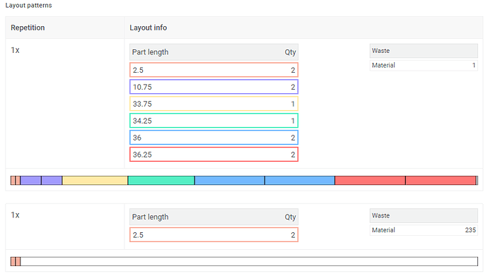

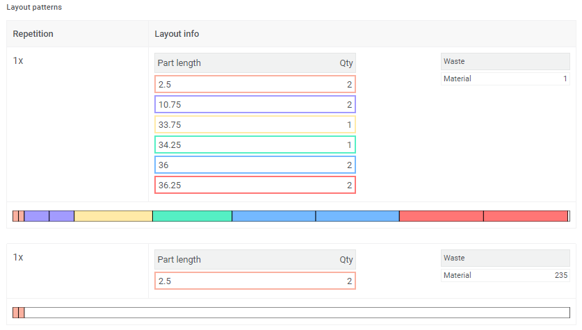

Just wondering if anyone here has some leftover pieces from their builds that I could possibly purchase so I can have the right about of material for a 24x24x3.25" MPCNC (I’m located in Northern California).

Oh I get that, but the problem is that I need a little bit more than 20’ and I guess they won’t sell partials.

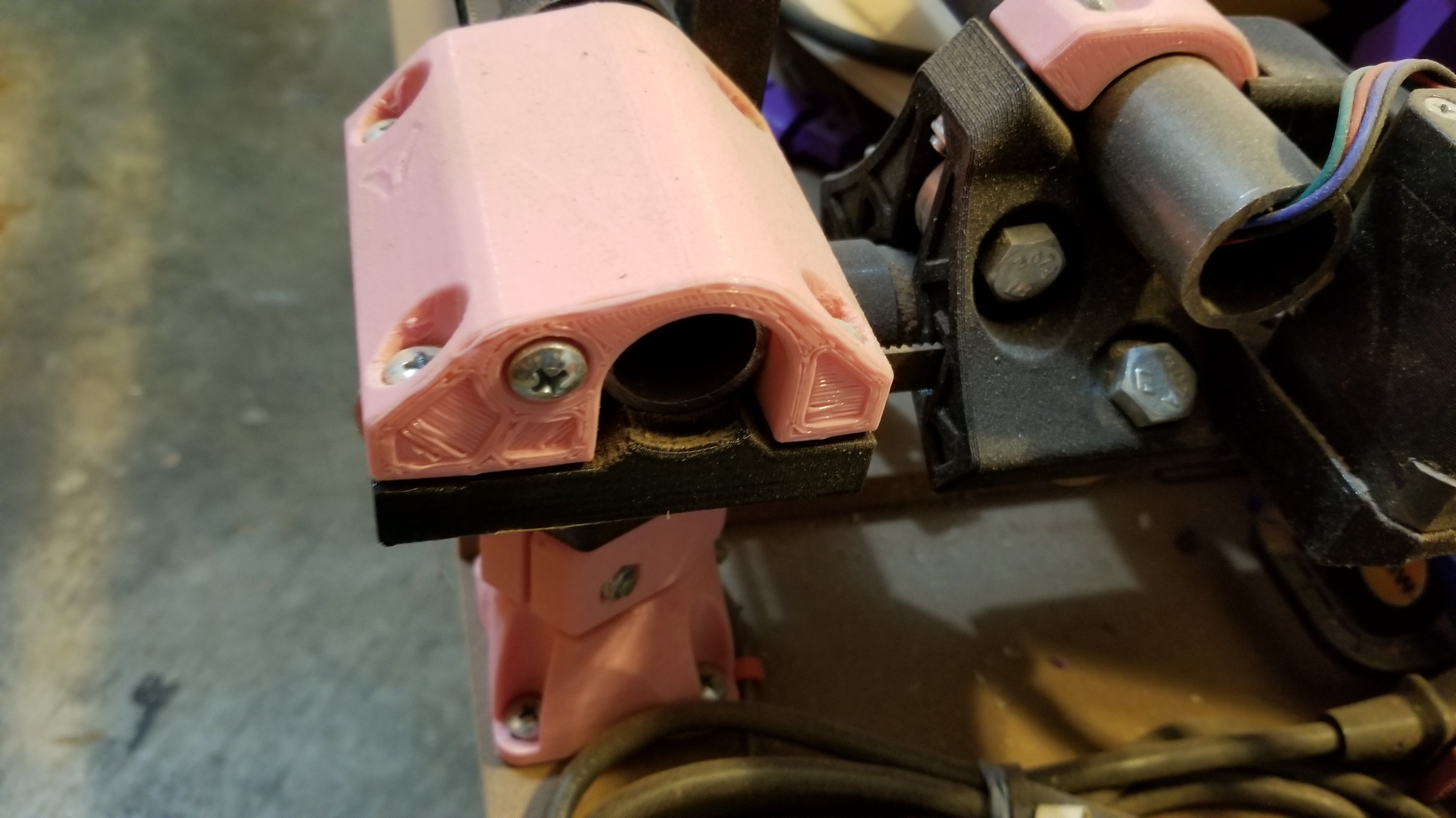

Since you are only 4 inches shy, you could cheat the ends a bit like this
You could cut a half inch from each end of each tube and end up with 4 extra inches of length.
Thanks, I didn’t think of that!
