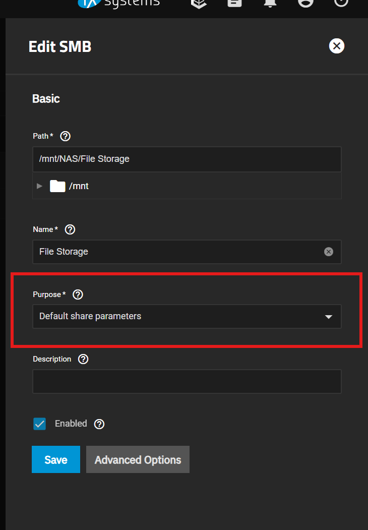

I have TrueNAS Scale set up on a computer on my network. I use it for all my downloads and keep pretty much all my files on there so it doesnt matter which computer I am at, I can get to everything. Well up until now that has worked great…
Yesterday I had to wipe and reinstall windows on my main computer. Now that its back up and running I cant get to anything on my nas. I can map the drive no problem. But every time I do it just creates a new folder under the main “File Storage” dataset and gives me an empty file with the storage amount thats free on the nas. It wont give me access to anything that is already on there. I have googled and searched and even gotten ChatGPT involved trying to figure this out. As far as I can tell I have all of the permissions set correctly and I dont have create new directory selected for the user name. But each time I try and map the drive it makes that folder and wont let me in to the old data that I need.
Anyone have any ideas??? I have made a post on the TrueNAS forum but from reading around over there I’m not sure someone like me is going to get much help. I have a lot higher faith in this forum. I really need to get into these files so I can get some orders going. None of my computers can access the nas right now. IDK what I have done wrong :man_facepalming:

Yes. Same user. And now that is the only use account. All of the old files “belong” to that user but I still cant access them or even log in without it making that new blank folder.
I can log into trueNAS but you cant access the files that way. Only through a mapped drive. I know My computer and Carmen’s computer both make the new folder when you try and map the drive. I have not checked the garage computer yet but will do that now.

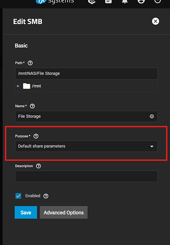

OMG I FINALLY GOT IN!!! It was damn sure to do with permissions. But I wish I knew exactly what I did to mess it up. What I just changed to finally fix it I am 99.9% sure I never changed. But right now I am just happy to be back in LOL
You’d better type whatever “it” was in here, or you’ll never remember how to fix it the next time lol

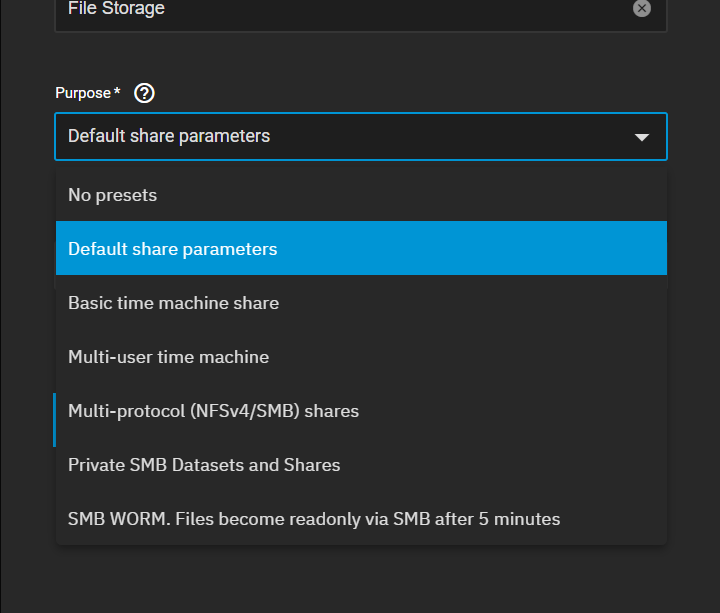

That one. That’s what I changed. Still need to go see if the other computers can log in with the same username, if not ill just create 2 more usernames and get them in that way hopefully
I tried no presets first and that would let me see the NAS but not connect, the moving to the default one worked. Originally it was on “private SMB Datasets and Shares”
All 3 computers logged in under the same user name now. So now any computer can write into any folder on the NAS. No more needing multiple folders for the same stuff!
