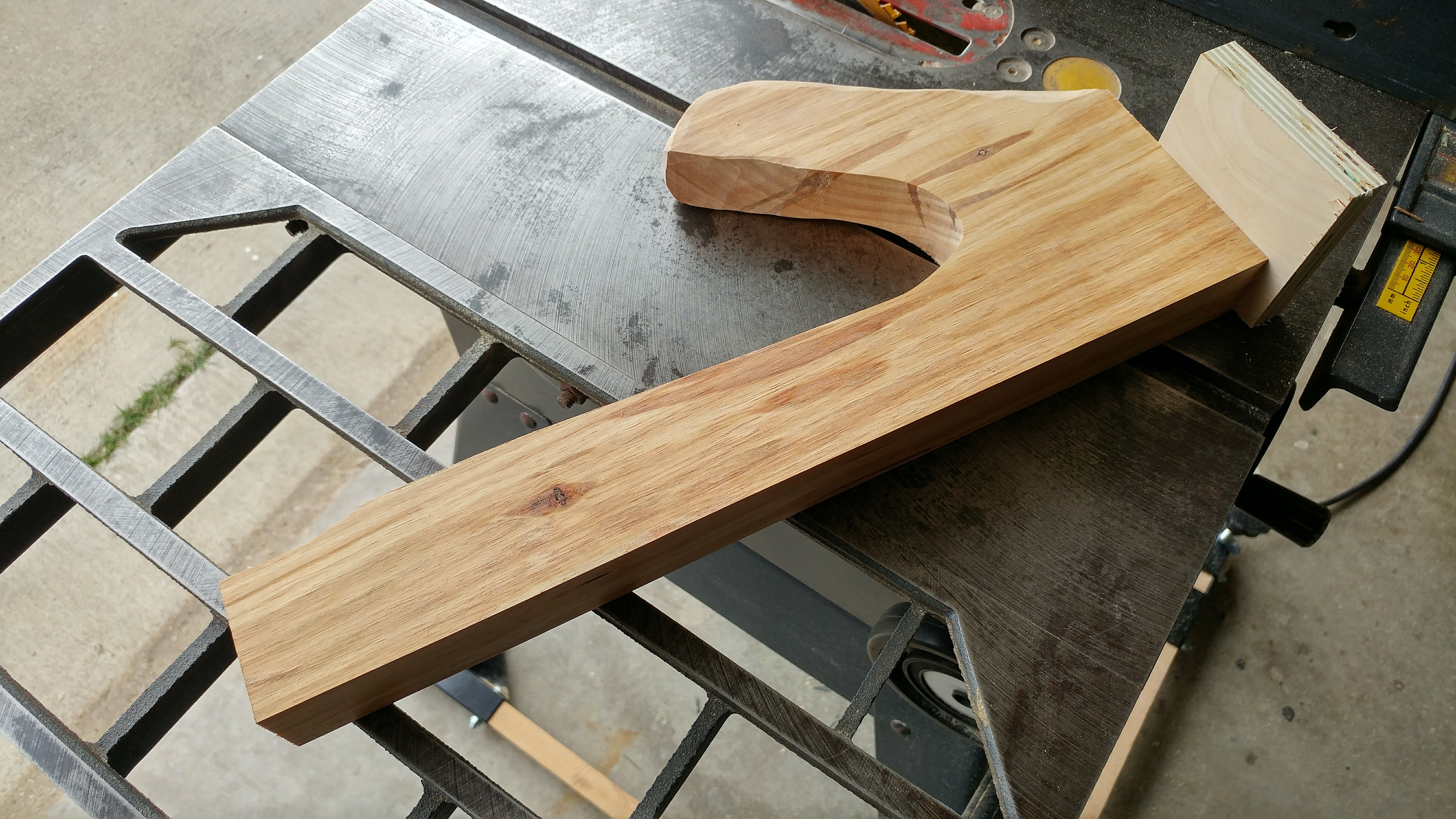

I slapped this push stick together a few years ago. As it wears out, I use the cross cutting sled to cut the bottom off and then glue on a new one. After doing that too many times, I just grab another piece of scrap and cut a new one out. The plywood on the back is screwed on and gets replaced with a new square pretty often.
What I like most about it is the ‘push’ area pushes on both sides of the blade and the pressure pushes down on the piece also.
