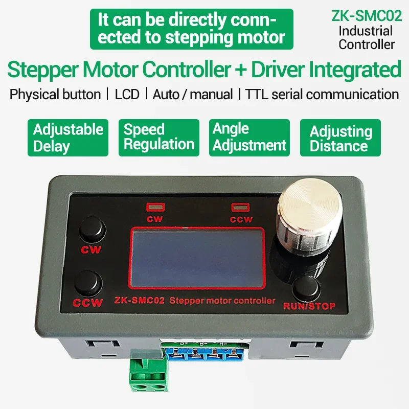

You could also get hold of one of these:
They’re pretty useful to have around. It’s basically a little panel mounted controller with a couple of buttons, a control knob and an LCD that lets you run a stepper motor in a few basic ways like speed controlled forward/reverse, run at fixed speed when the button is held down, turn X rotations on button press, turn one way on button press and then turn unwind those turns on release, that kinda thing. It’s a good way to have a play with steppers for all sorts of stuff.
It is very rare for stepper motors to go bad. If it was working before, and you can spin the shafts, it is likely they still work. As for testing, in addition to the ZK-SMC02 mentioned by Jono you can:
