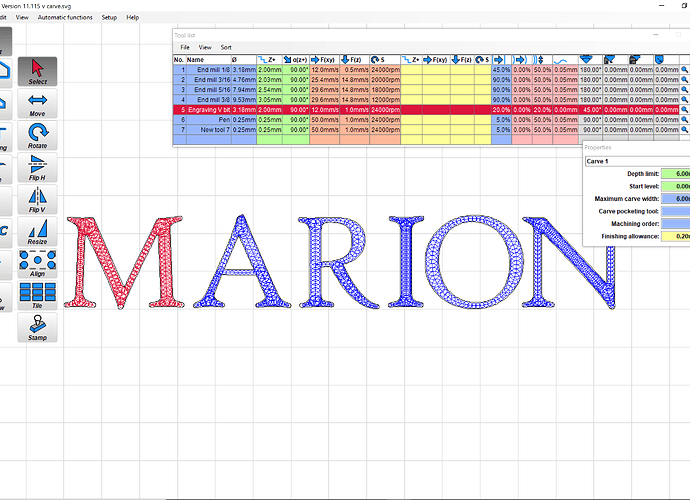

Here is Estlcam setup. It turned out fine. I will post pics of my tests and final work in foam and then MDF, but here is my Estcam setup.
[attachment file=“Screenshot (116).png”]
There are some things I still have to figure. The cut order is a bit weird for this text. I am not quite sure if I have the finishing steps figured out right. But in any case it didn’t take too long, about 8 minutes I think.
One thing to remember is that you have to have a bit sized to the font you use and the height of the letter. Your letters shouldn’t have parts that are wider than the tool to keep it all with a v groove. I’m still trying to figure out that part, but using the font High Tower and sizing it at 25mm high for the capital letters worked out fine.
I compose the text in Inkscape and bring the SVG into Estlcam.

i’m not sure how it works in estlcam but in vcarve pro you tell it the depth you want the letters to be carved, and it will flatten out the bottoms with the v bit by taking a bunch of small stepovers OR it can clear out the flat areas with a different endmill. V carving is still useful even on bigger letters because it allows you to do the smaller areas/serifs.
in your picture you have a 20% stepover (i believe) which is way too high to make flat areas look good. that is why you aren’t getting good results on areas bigger than bit width most likely… you’d want to be down to like 5%
