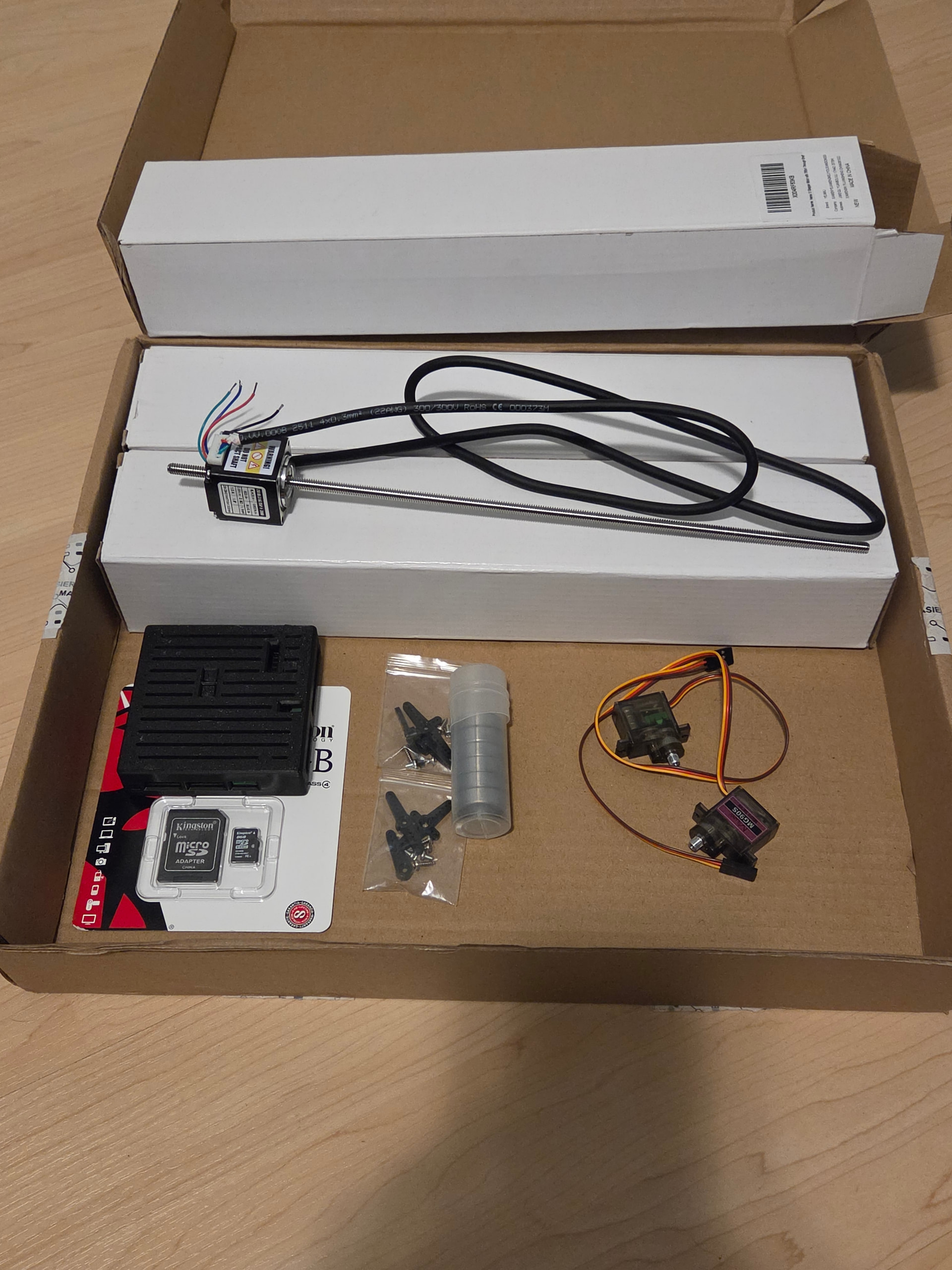

Sometimes you see an interesting part that gives you a weird idea and then that part goes on sale so you just have to go for it.

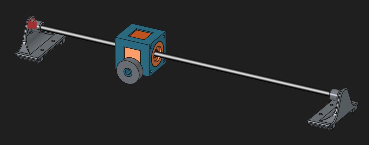

This idea was spawned by a through shaft NEMA 11 stepper motor.
I have lots of ideas on how I’m going to accomplish my goal but I’ll probably be playing in CAD for awhile.

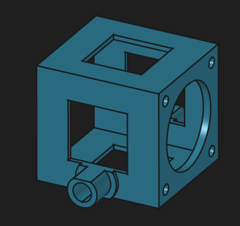

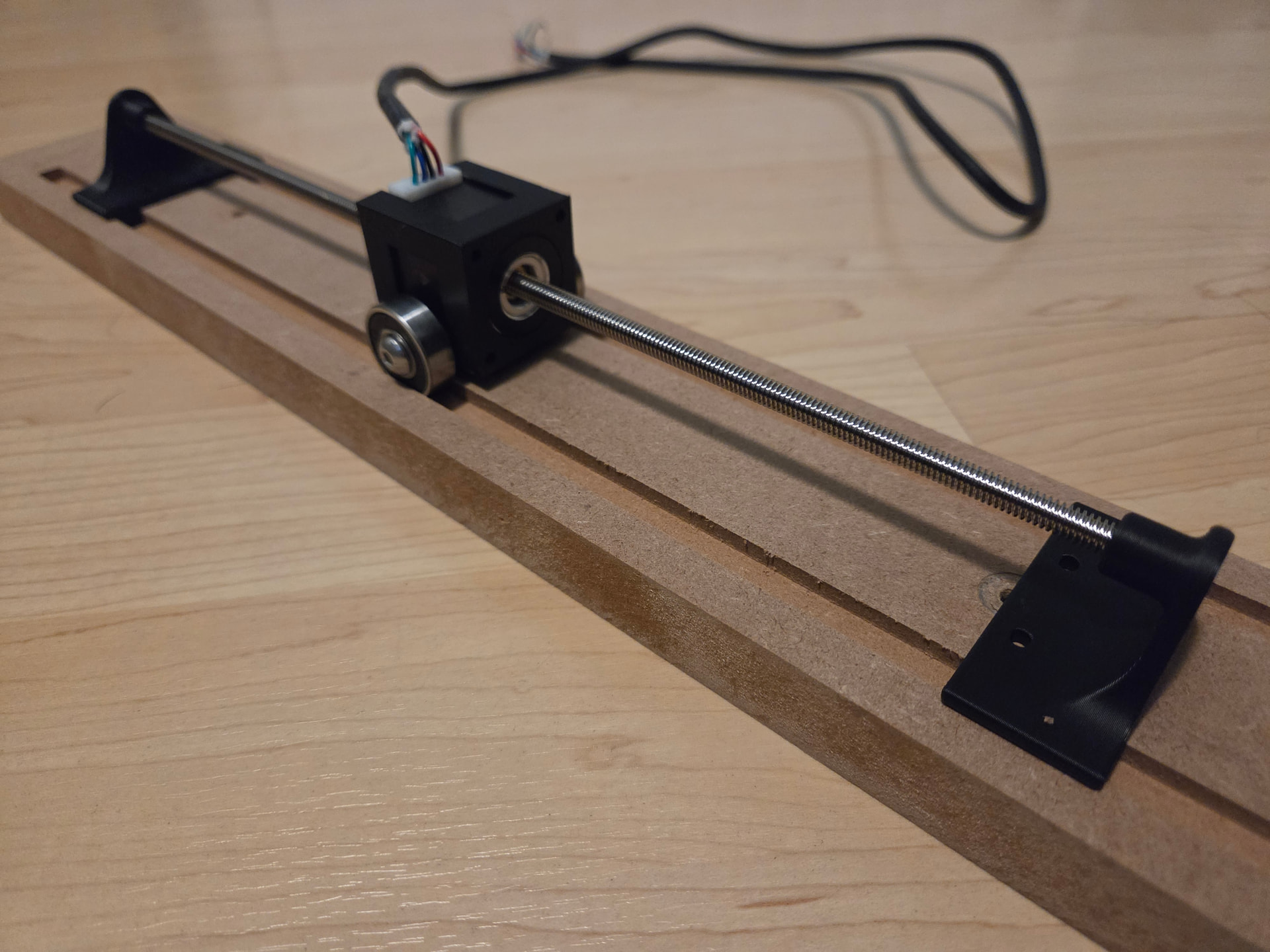

Going to experiment a bit with these motors. This weird setup with this tiny stepper having bearing wheels is funny. Just looking to mess around in unconventional things and see how it goes. I think a normal person would use linear rails but that’s boring. Eventually, each axis will end up in some kind of hardwood beam. The X beam will mount right to the Y steppers. I want this thing to eventually look elegant on the outside, but weird on the inside.
Interesting take..
For a square machine I’m not sure I can see the point vs a corexy, but maybe I’m missing something ?
For a round sandtable though, this could bé a very nice solution, just mount the beam on a dolly and attach a motor to make it a turntable
Ha, I’m not sure there is a point. I’m experimenting. I will say that since this is intended to be on a desk and is already quite small, I need it to take up as little space as possible.
