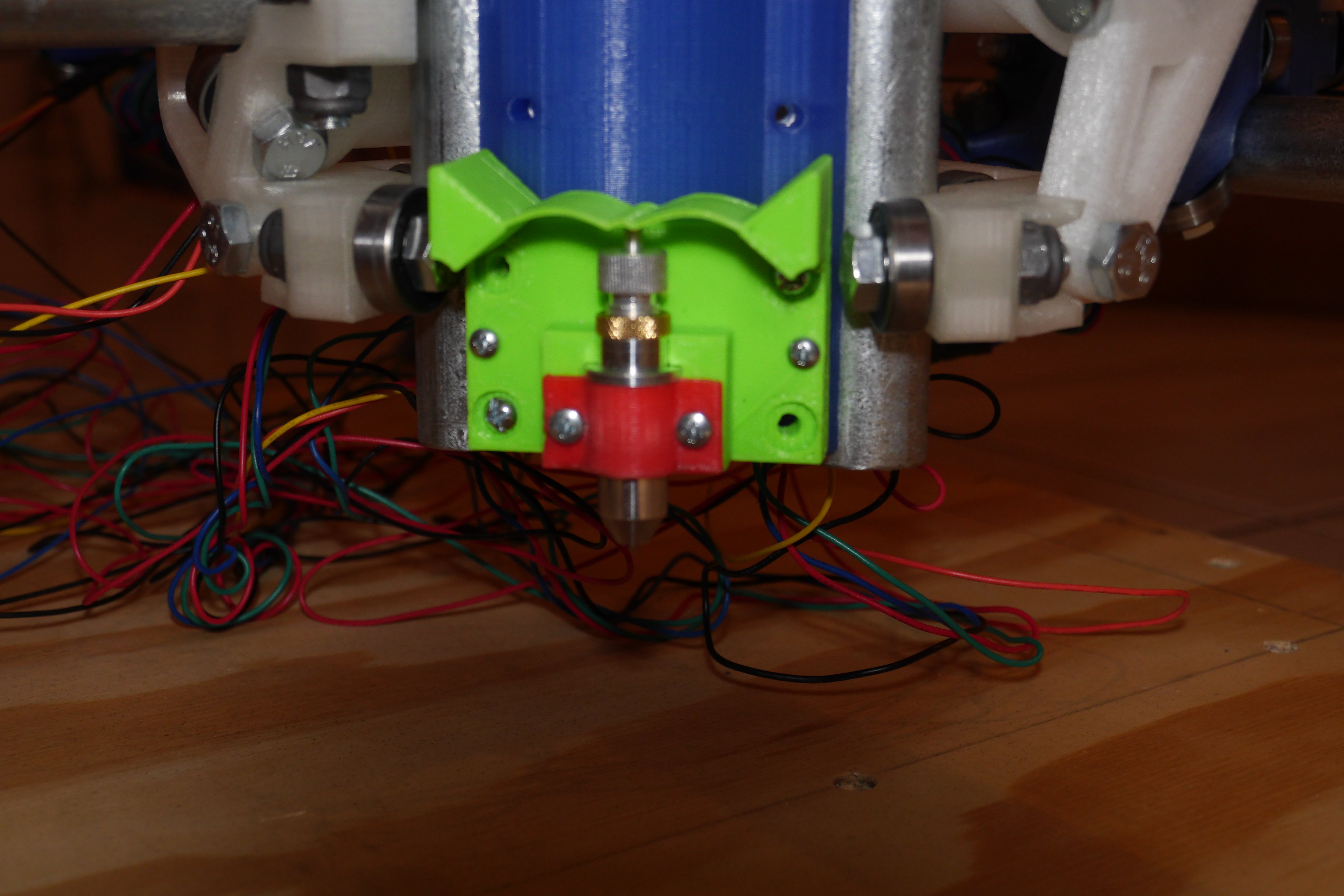

Another Roland drag knife mount
I adapted the Roland-style drag knife holder mount that I had made for my 3D printer to work with the MPCNC. It has a plastic spring (ABS recommended, unless you want more tension) for pushing on the tension button at the top of the holder. I haven’t tested it yet with the MPCNC. Back when I used it with my 3D printer, I drove it with my [gcodeplot](https://github.com/arpruss/gcodeplot/) python script, which I’ve adapted to work with MPCNC.
https://www.thingiverse.com/thing:3388793
[attachment file=86329]
That looks pretty good, if you spring mount the body instead of the blade you can use the body to limit depth (for things like cutting vinyl and not cutting the backing) and the spring to control overall tension for different materials.
Good point. I should experiment more.
