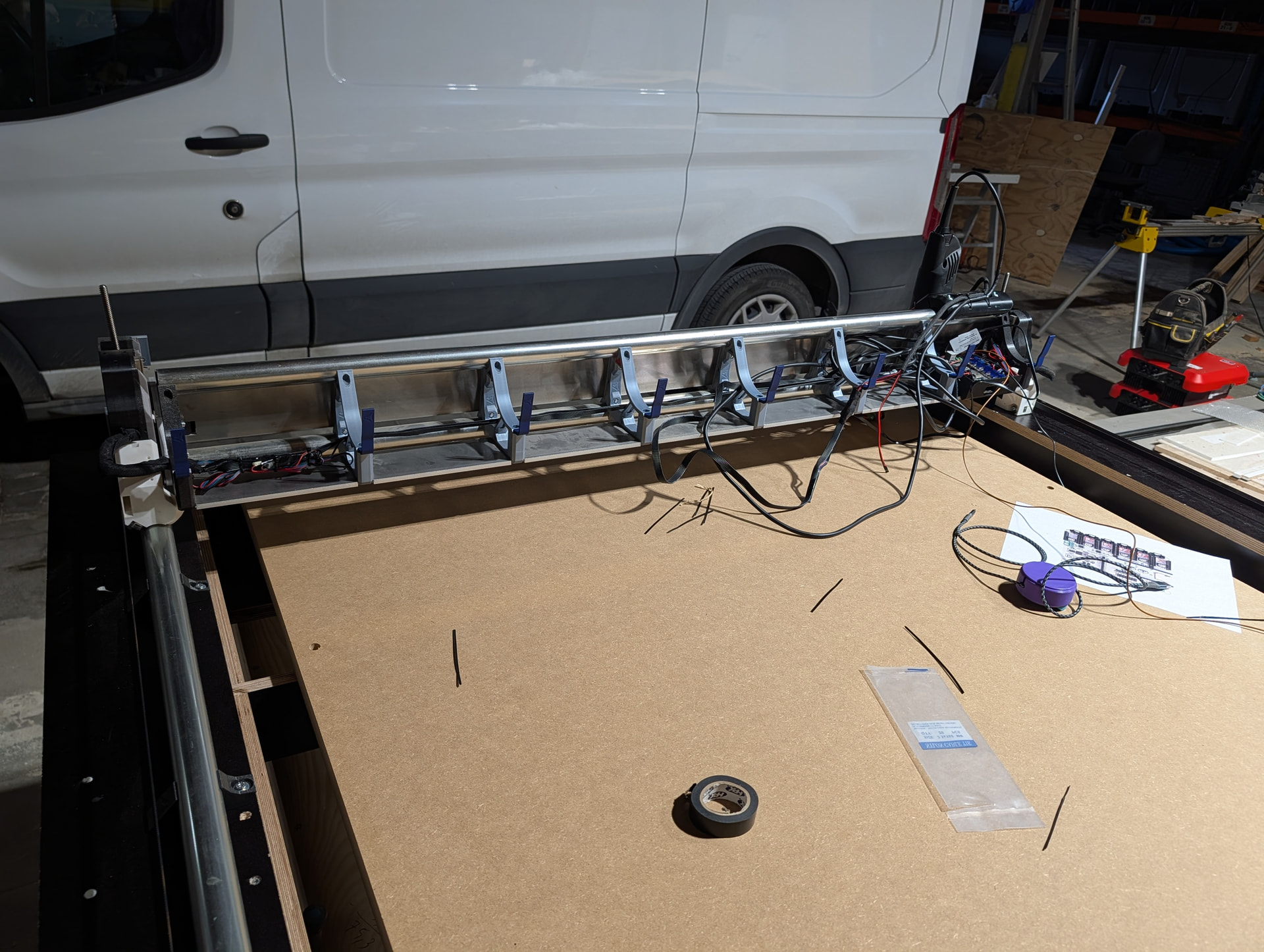

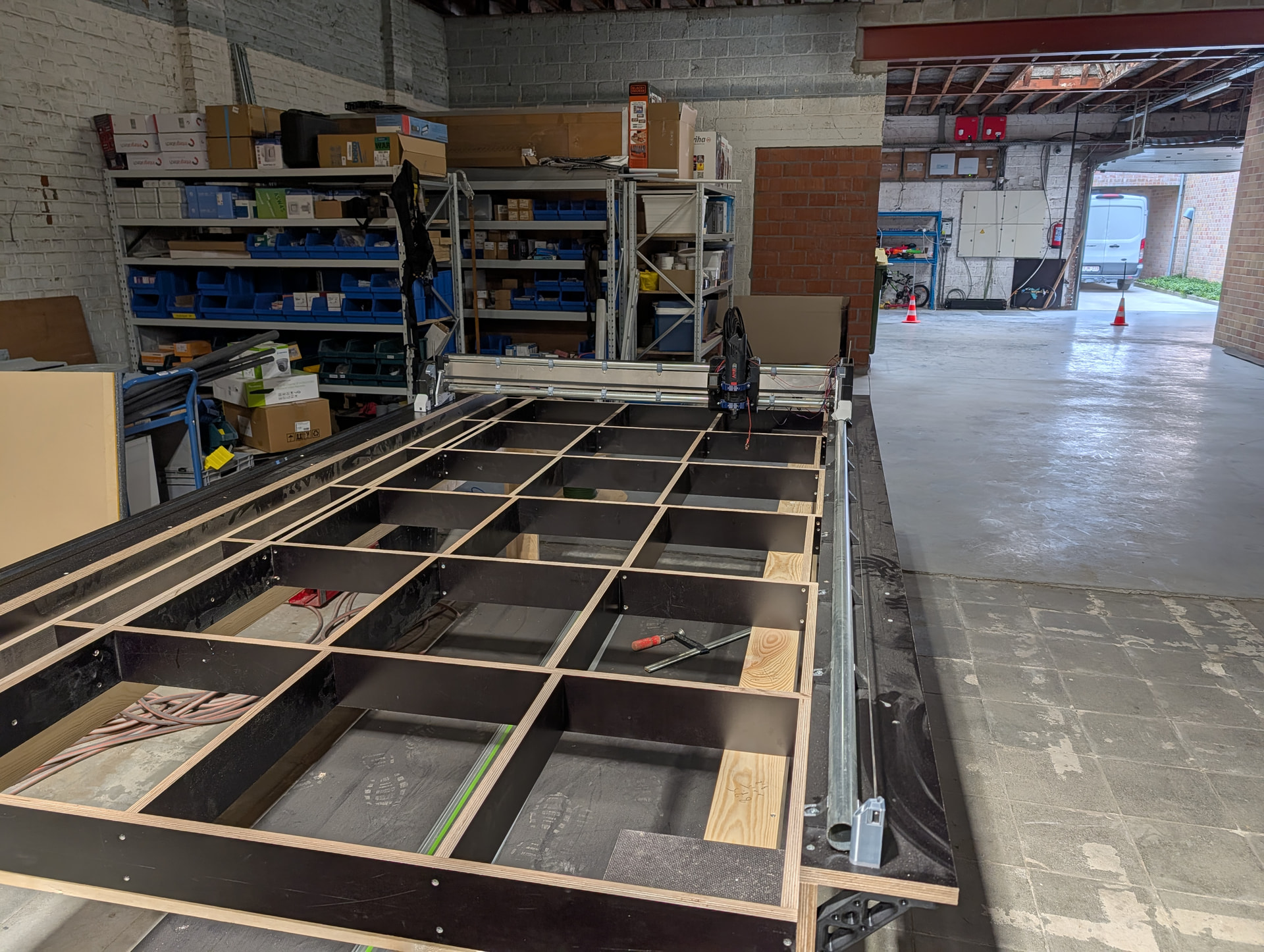

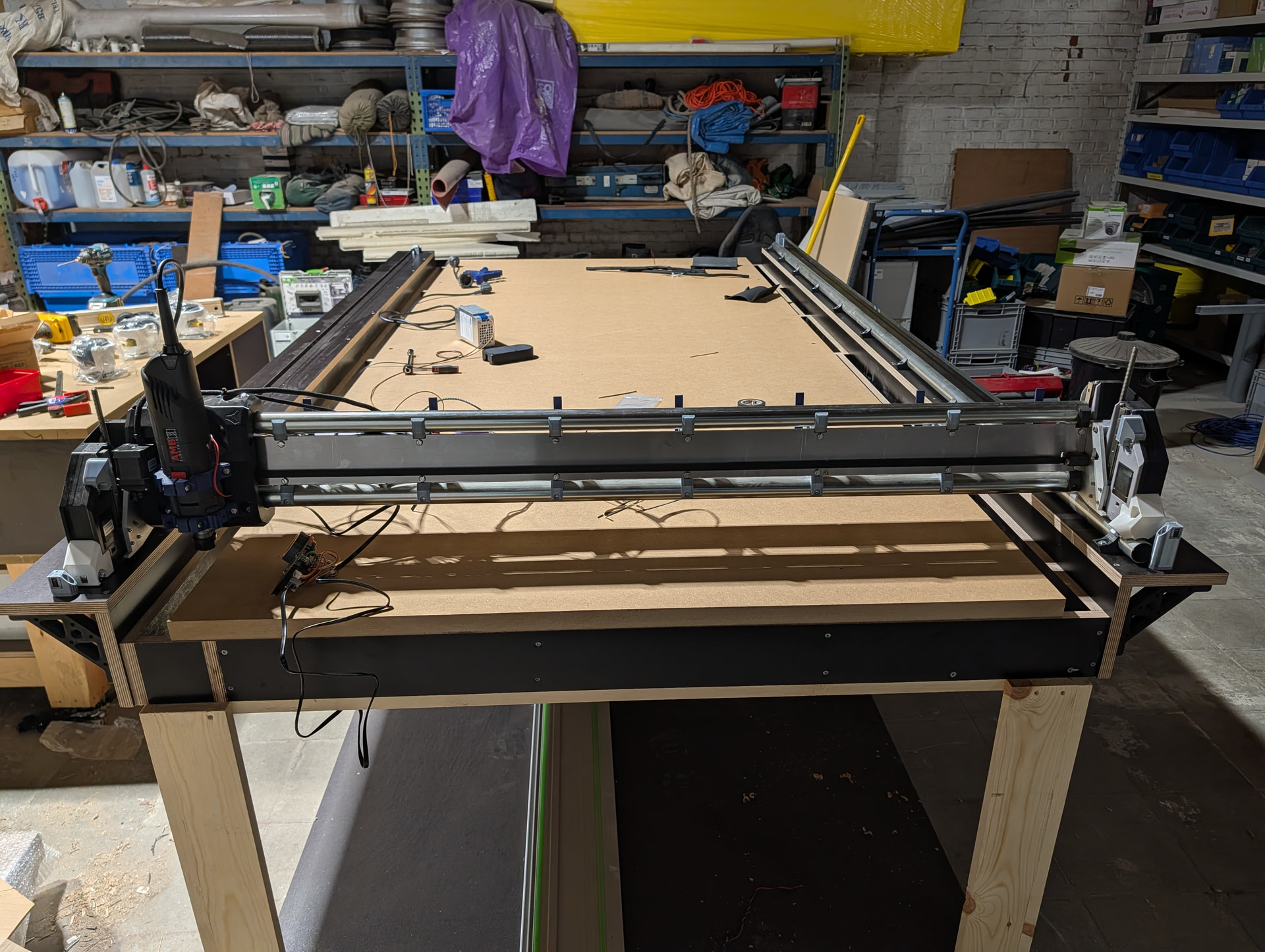

I’m an 52 years old electrician from Belgium. I started building the lowrider a while ago but recently i found some time to continue the works. I didn’t make much pictures from the actual build but i do have some from the current state the machine is in. I have a moving machine ready for calibration.
Specs:

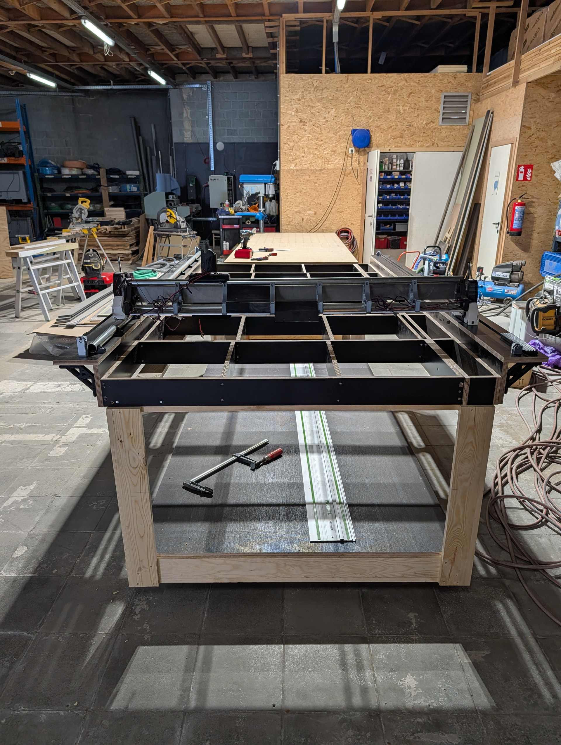

its a machine for a full sheet of plywood 122mm x 2400mm with some margin.
The struts are lasercut so no temp struts for me.

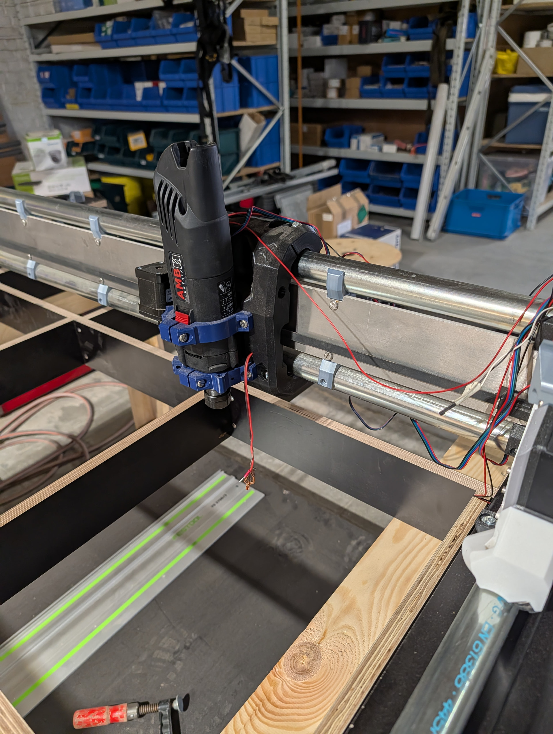

It has a router from amb with a mod for it i found on printables
I’m still looking for some solutions for the moving cables (any suggestions).
Don’t look at the mess its stil a work in progress.
You are welcome. :face_savoring_food: Feel free to post a make and rate it 5 stars. :grinning_face_with_smiling_eyes: AMB gave me their router’s 3D model for it, really, really nice. Great company.
I fixed an aluminium L track to the back of the braces and used a small drag chain. The tape measure trick also works. :slightly_smiling_face:
Thnx for the responce Philipp. I think i posted a build some time ago on printables.
I found 3d print for wire tracks on printables and orderd standard tracks on amazon.

I designed all the parts for concealing cables and printed them on my 3D printer,
the cable chains come from Aliexpress.

I found some draglink on amazon but i think i bought bad ones because for some reason they don’t go completely flat. So i found a parametric dragchain on printables and printed my own in ASA. I also found some brackets that i printed. Just need to mount everything.
