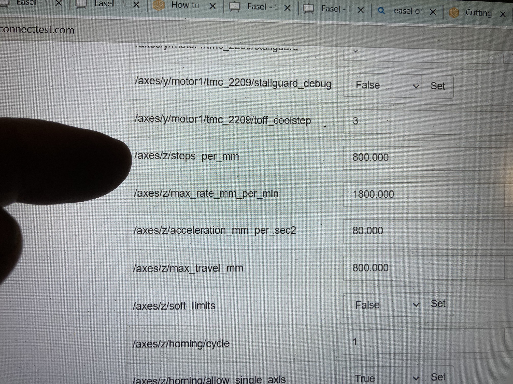

I also bought mine M8 2mm pitch from amazon and they have plenty room for sawdust and gunk. 2mm needs to move fast so they are a bit noisy from resonance. The worst is the liniar track they can be too cheap and I had to smooth them with emery cloth otherwise they were too tight and gravity wouldn’t do its thing. I might considering a 4mm pitch to slow down my Z screws.
You need to be sure your Max Z speeds are set 4x slower than ours. At such high speeds you have very little torque left.
Correct, the gearing is 4:1 now so torque is not a problem. I Will try testing other pitch to find the best solution.
No but speed is, steppers motors lose considerable torque at higher speeds. That is why I use the 8mm pitch screws. I would prefer a 10 or maybe even a 12mm honestly.
I am aware now - just ordered 8mm pitch.
