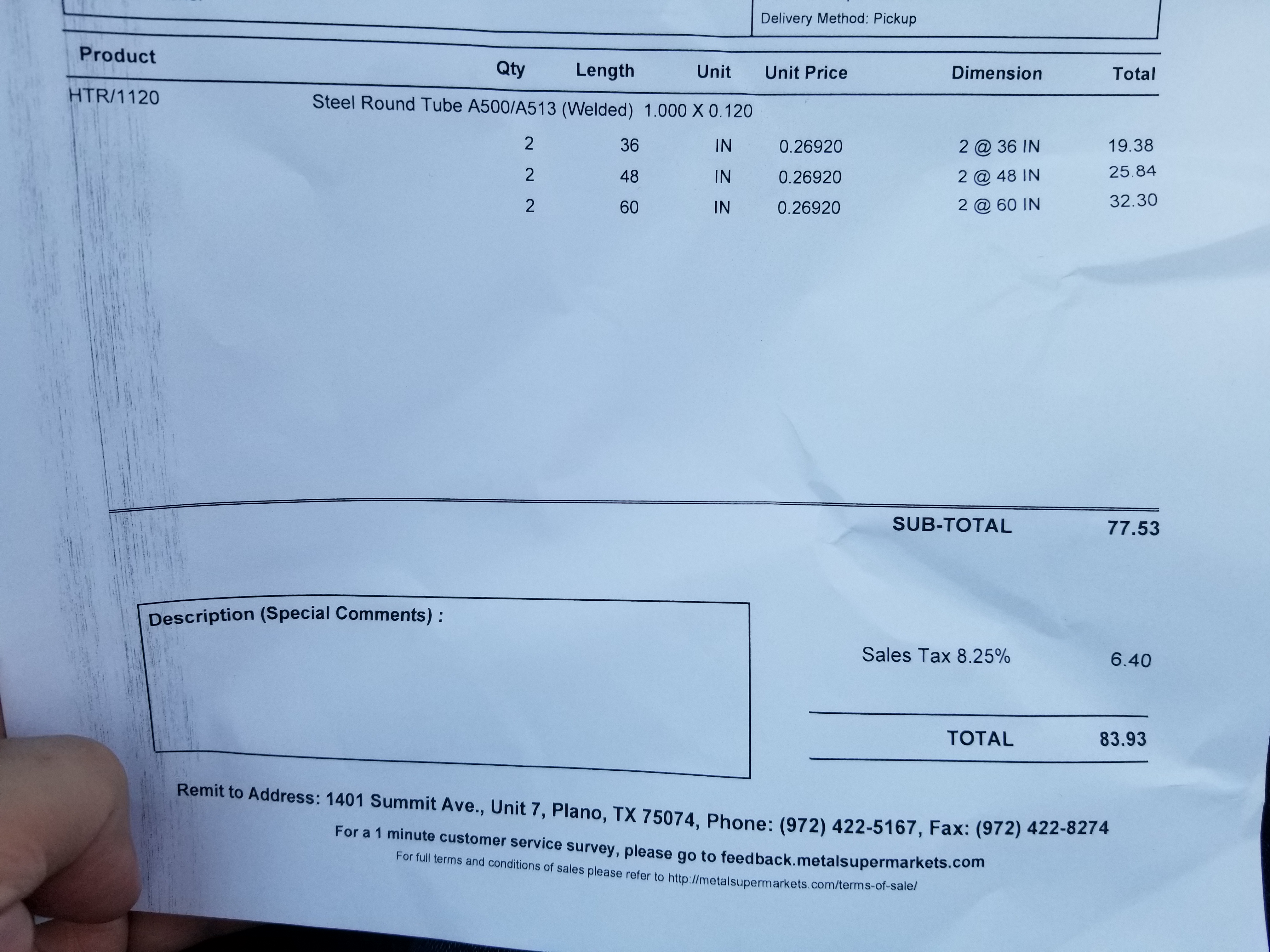

I went with ordinary mild steel, not stainless. I also got a bit thicker wall since I was going bigger than normal but that would be optional.
So far it hasn’t been an issue and I’m happy with my choice. As long as your climate isn’t super humid you should be able to get away with it.

That’s a rip off price. Shop local. $5/foot stainless 1” OD .065 wall last week at Metal Supermarket. $100 out the door for 20 feet, plenty for my build.
