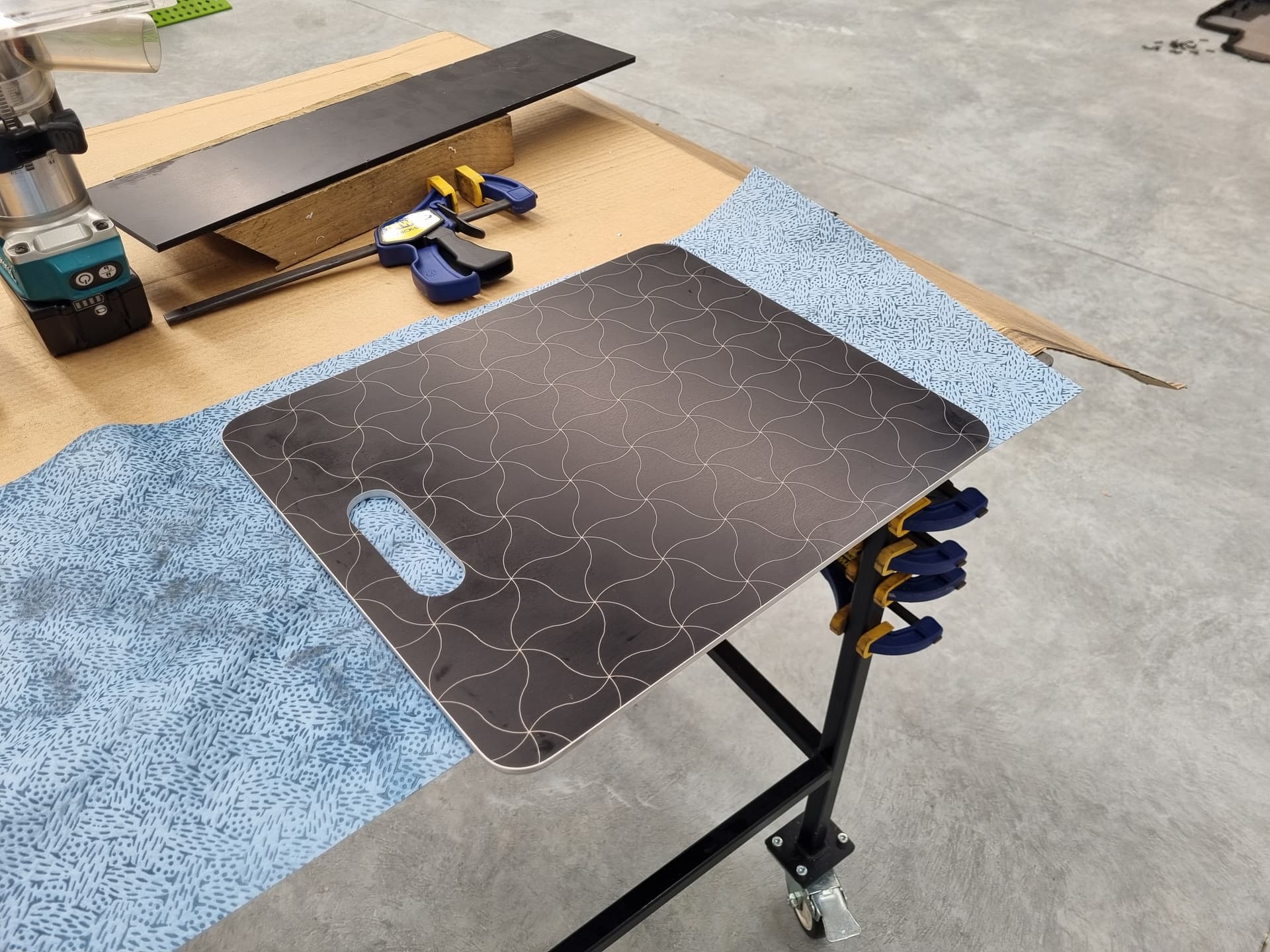

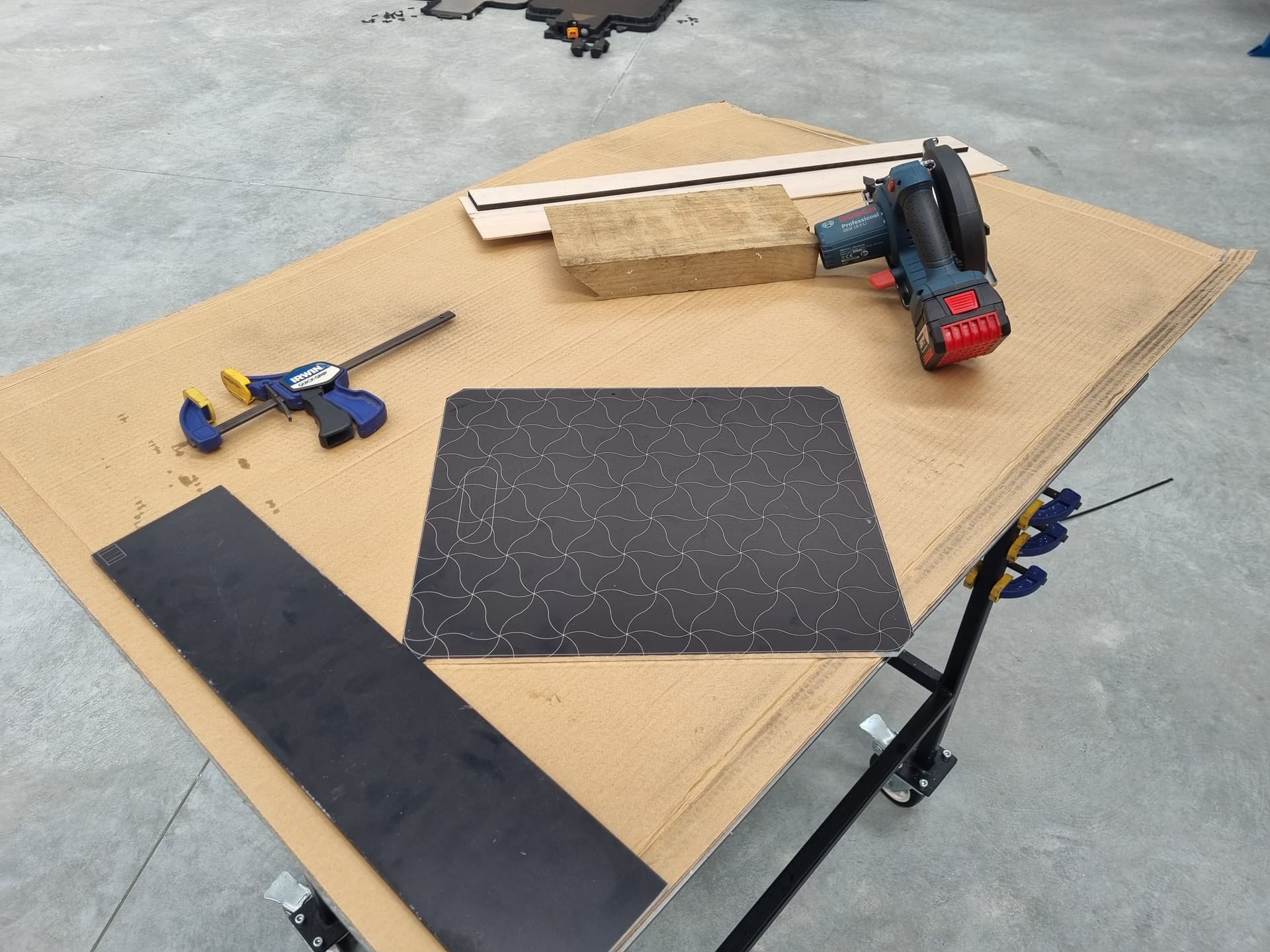

Used the laser cutter to etch the shape onto the anodized aluminium as well as a design on the surface for a laugh. Used our Bosch metal cutting circular saw with my DIY wooden track for it to cut the rough outline. I left around ~5mm to be trimmed off.
I also laser cut the same design into an offcut of 9mm plywood, with the outline offset by 1/8" and stuck it down with double-sided tape. No good photos of this step, unfortunately.

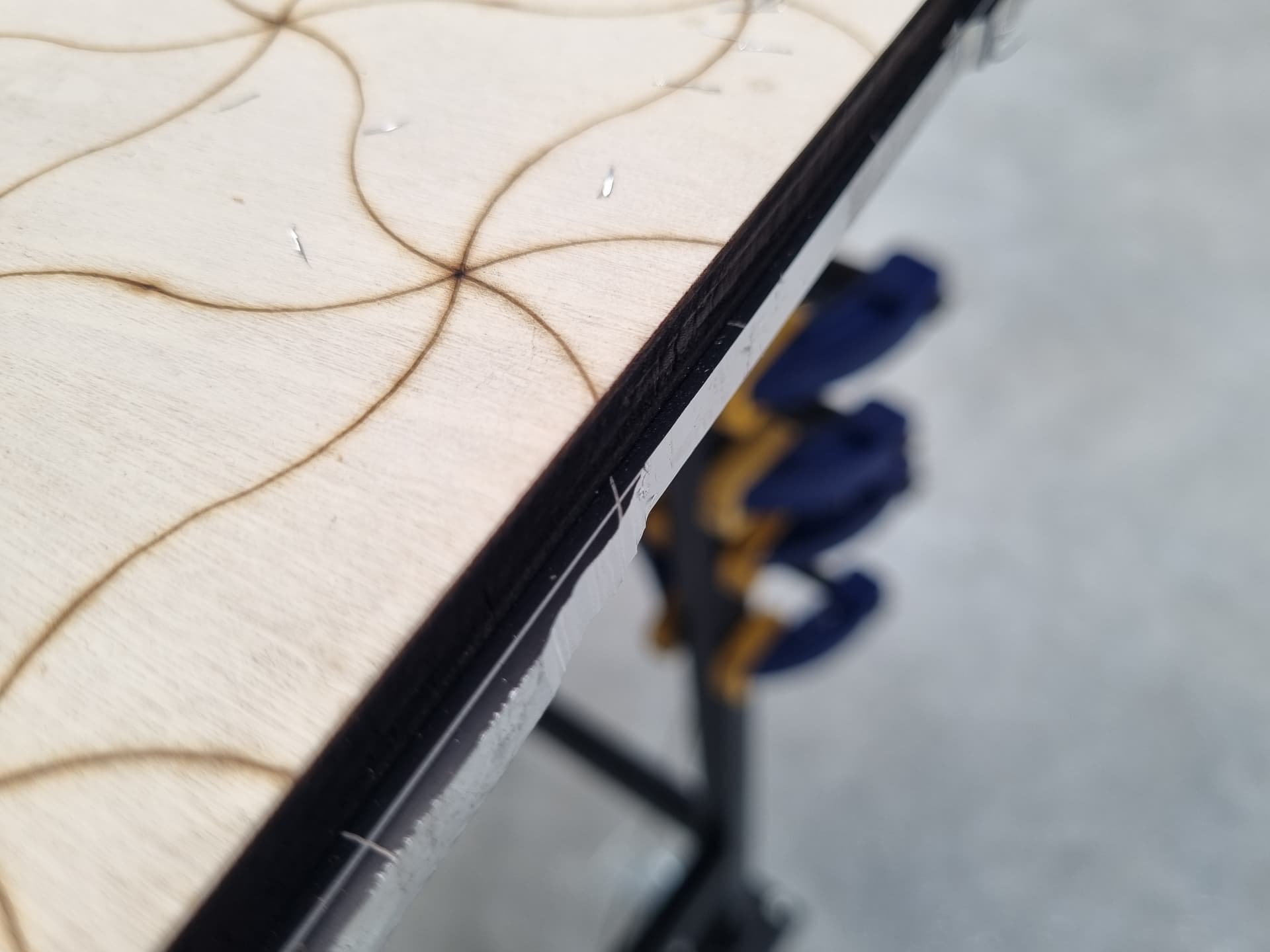

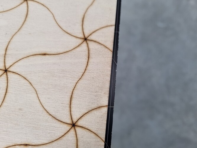

Using a 1/2" pattern bushing and a 1/4" carbide spiral bit I routed around the outside. That’s showing the lead in and how clean the result is. I was doing the cut in a single pass, so 6mm DOC, ~5mm trim at maybe 10mm/s with what felt like probably ~5kg of lateral force (it definitely takes some doing). With the router in the lowest speed setting you can definitely hear it loading up but it doesn’t bog, didn’t get more than slightly warm and was throwing beautiful sliver chips the entire way.
I had a few issues with the pattern bushing rattling loose so ended up with some chatter marks about halfway around so in future I need to remember to tighten it better with the slip-jaw pliers.

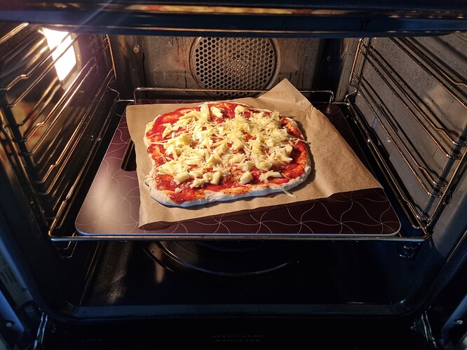

@Dreyfus As requested!

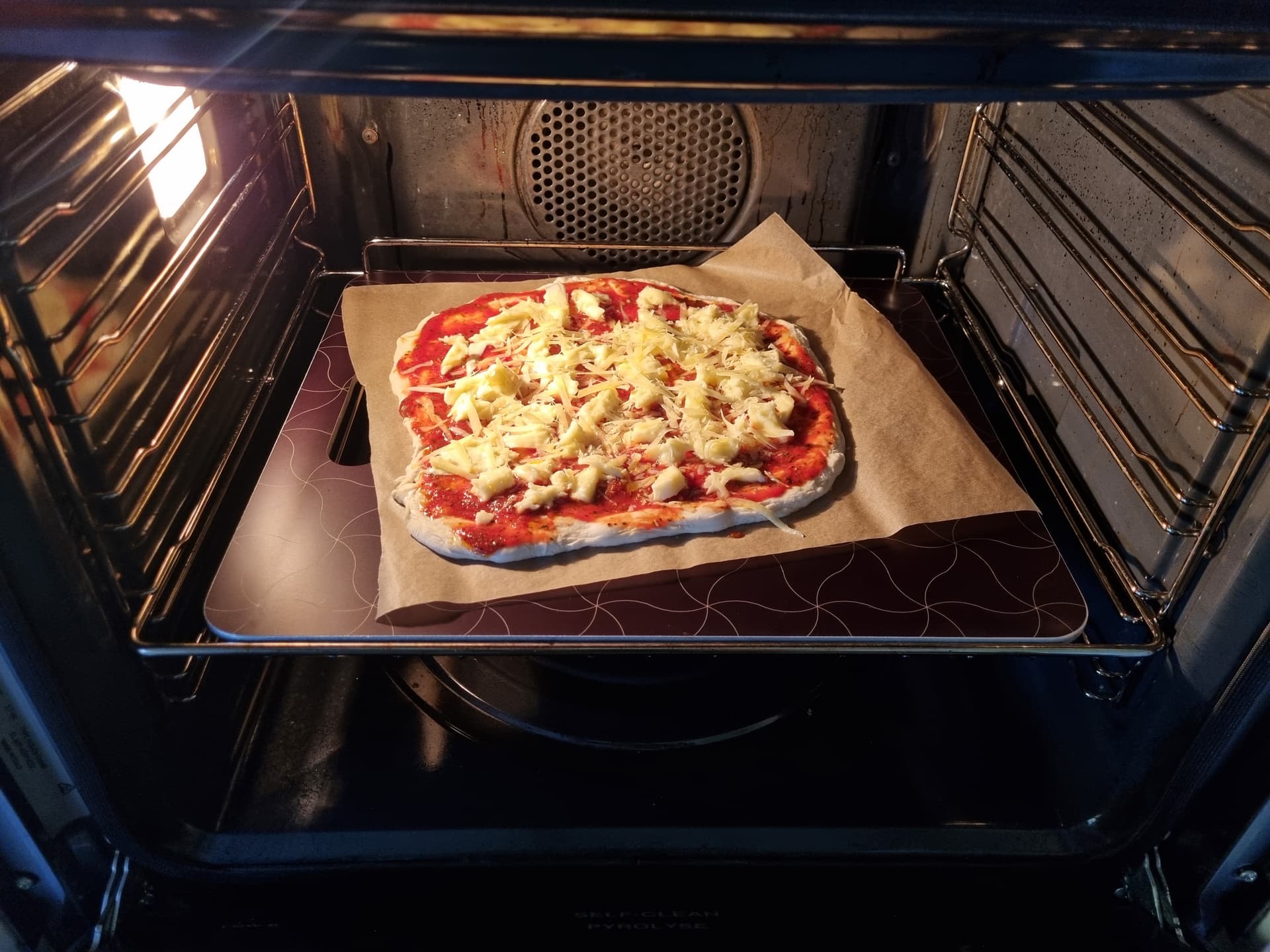

Preheated the oven to 280C for 10 minutes after it reached temp, the plate was at 250C according to my non-contact thermometer at the time I put the first pizza in.
Sourdough base, passata with dried mixed herbs and garlic infused olive oil as a sauce, mozzarella and parmesan on top.
In for ~10 minutes, the plate was at 230C immediately after removing the pizza. I’d love to know what it dropped to as soon as I put the pizza on, though. Maybe that’s for the next one, I’ll put it on and measure it after 30 seconds or something. May have overdone the cheese a little, it had a real oily patch in the middle.

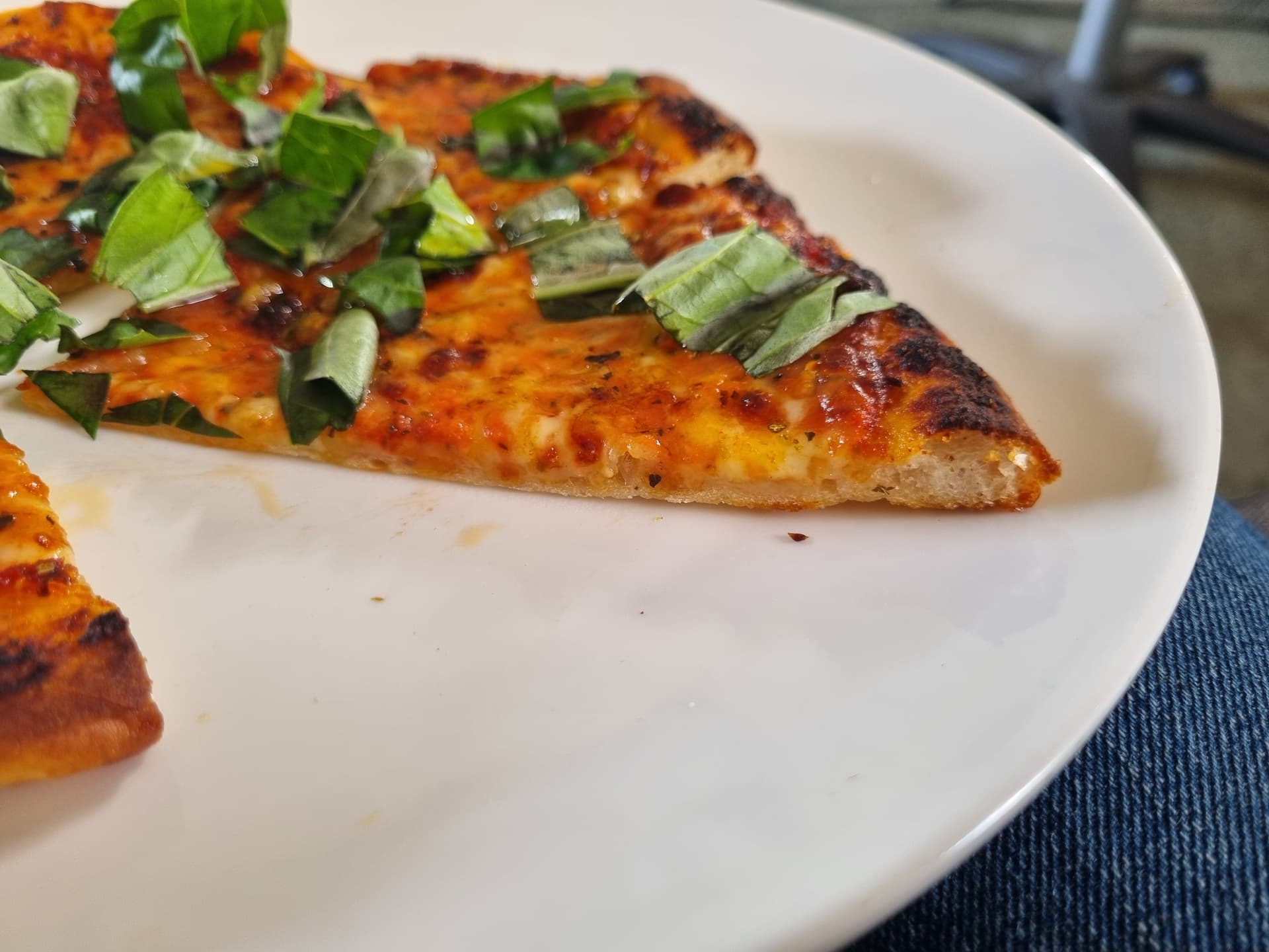

This is the 2nd one. The first one was still just a touch soft and doughy on top because the dough was still very wet and the sauce was quite liquid but the bottom of the base was super crispy. The 2nd one was a little thinner, I floured the base a lot more before it went in so it wasn’t sticky anymore and it cooked through much more.
Plenty of dark spots on the base. I think it would have been even crispier and more evenly browned without the baking paper due to radiant heat off the plate where the dough wasn’t necessarily touching once it cooked and lifted. That’s a definite advantage for a guaranteed food safe plate…
My half of the 2nd pizza. My partner’s verdict: Nicer than Sal’s, which is an expensive 'New York Style pizza chain around here. About on par with one of the local Italian restaurants, flavour-wise, but nicer because it was perfectly hot and crispy when we ate it, rather than needing to get it home.
So, I’m going to call that a solid success. I’ve really gotta figure out my process for working with the ~80% hydration pizza base, what a pain in the rump, especially trying to pull it out into a pizza base shape with relatively even thickness. The first one was way better than our attempt a couple of weeks ago with the ceramic ‘stone’ in that the base was crispy but it still wasn’t perfectly cooked through. The second one was much better but I’d have still liked to see a few more bubbles and a bit more spring from the base, although I suspect that may have been down to not enough kneading last night and then needing to work the dough too much because I didn’t portion it before putting it in the fridge so had to split it at the last minute before shaping.
Conclusion: It made a pretty big difference and I’ll definitely be using it again. I’d say it was the difference between a solid 75% effort and a 90% effort. With the ceramic is was something I’d be happy to eat myself. With the plate it would be something I’d be happy to have paid good money for or be proud to serve someone else.
