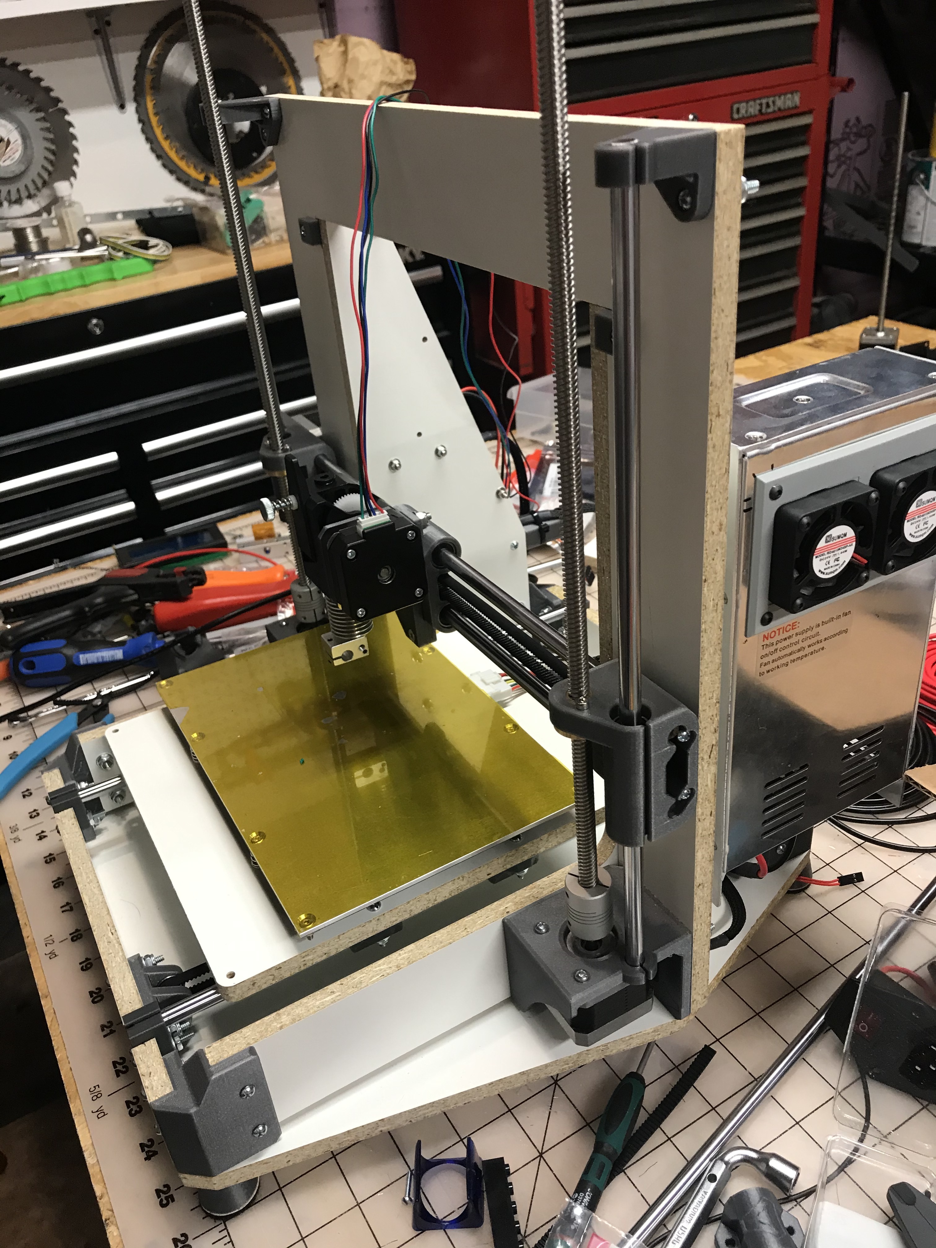

Near complete on my MP3DP build. More info and pics on the way.

I found a part cooling fan duct that mounts to the hotend cooling fan mount on Thingiverse. I had to rotate it a bit but that wont cause any problems.
So far I’m very happy with the MP3DP. Everything cut perfect on my MPCNC and fit together like a glove. I’ve had to add a couple mounting holes for the SKR board and move the Y axis home switch because of some interference with my heated bed screws. And of coarse added the 4 holes for the heated bed.
