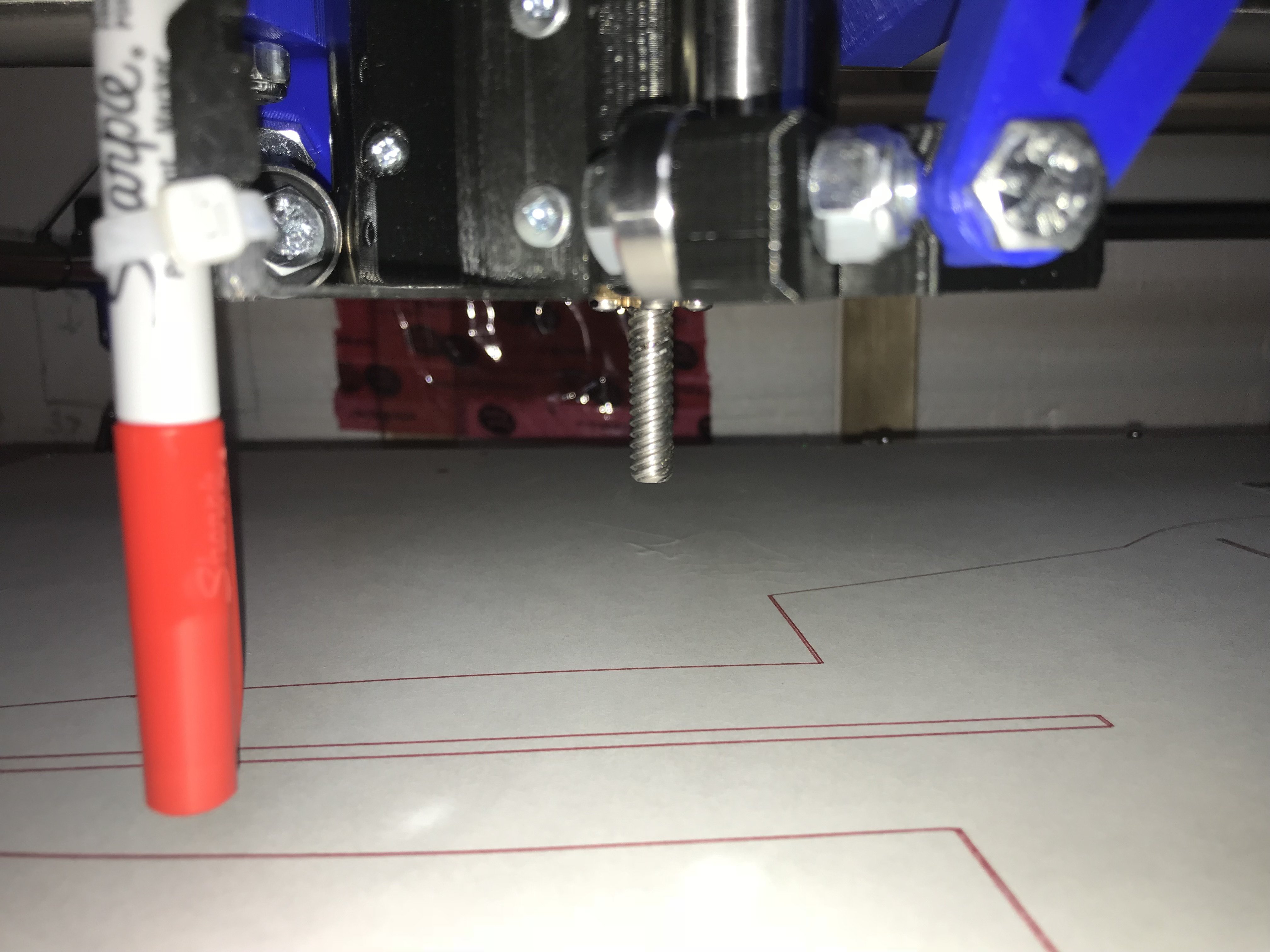

Hi Ryan, my screw is about 1" 1/4 or 280 mm, my Z tubing are 11 3/4, should I make them longer? At the moment my max travel is 3 3/4.
The nut goes on the top.
Your screw is too long.
