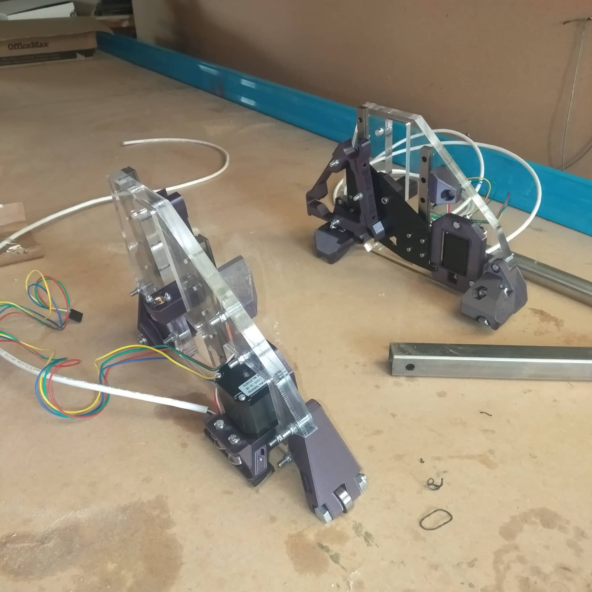

I’m having some difficulty aligning the linear rails so they run freely…
I’ve left the rails and bearing blocks loose, then run the assembly to the bottom to tighten the bottom of the rails, then lifted the carriage to the top to tighten the top of the rails, and then slowly tightened each screw in the rails, finally I’ve tightened the last 8 bearing block screws, but the rails seem to go out of alignment/get sticky when I tighten the bearing blocks.
I’ve tried multiple times and nothing seems to work,
I’ve eased off the fixing screws for the rails and motion is a lot smoother, but I am worried the rails may fall out over time.
Should the rails be tightly screwed to the YZ plates, or should I leave them relatively loose, and maybe add some loctite to stop the screws from falling out completely?
Should the motion of the rails be as smooth as the rails are when they are no attached to any plates?
The YZ Plates are 12mm acrylic, and the fixing holes are tapped m3 holes with machine screws.

Love the acrylic! Are you using wood screws, or planning on bolts thru to nuts on acrylic YZ’s outer face?
What I found is that it’s not the rails bolted to the Y plate that make it bind, it’s where it bolts to the XZ plate.
If there’s about 0.5mm of a gap between the size of the screws and the holes, that makes for a much larger angle on the 25mm square where the XZ plate bolts to them than along the axis that the rail bolts to the YZ plate. Try loosening that off about a half turn and see what it does for the rails.
In my case, I initially only used one screw in each of the trucks on the linear rail, and the axis was smooth as butter. It was when I put the rest of them in that it started getting rough. The XZ plate wasn’t perfectly flat, either, or at least not flat enough to get away with all 4 screws tight in each one. THis also resulted in a slight misalignment of the YZ plates when it was finally assembled.

I can loosen the screws where the bearing block attaches to the XZ plate, but it seems to give me a lot more play than loosing the rails on the Y plate…
I’m using 3mm steel XZ plates, and I thought it would be a good idea to spray the plate with paint + clear coat, but I have a suspicion that could be the cause of the issues.

I’ve hand tapped the acrylic with an m3 tap, the holes are 2.6mm and I drilled the first 2-3mm out to 3mm so the tap had a bit of a lead in to stay straight.
I was warned the threads could crack, but it all went very smoothly.
