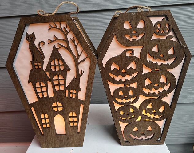

I like making artsy things, but have very little art talent or skill. The last couple of years I’ve leaned into AI image generators for my art references. The works below were largely created by Bing Image Creator, which is free, plus a small number using Ideogram.ai, which has a very limited free plan, but I spent $10 for a month just to see what it can create.
Everything was made using 2.5mm plywood, 5.0mm plywood, and 1/8" hardboard purchased from the local big box stores. The wall art measures 20" to 30" across the largest dimension, the coffin lanterns are 13" tall, and the cubes are 110mm on a side.

What did you tell it to get the coffins?
So here is one of the prompt I used: “A photo of a laser-cut wood wall hanging in the shape of a coffin. Inside the coffin are cobwebs, bats, and the words “Trick or Treat”. The wall hanging has a black wood finish and is hanging on a white wall. The background is clean and simple.”
And that produced:
I made an ugly error when I created the coffins. I first designed and constructed the coffin shells, then I started creating the coffin fronts. The proportions of the coffins I designed and the proportions of the AI created art were different, so I had to finesse the graphics to get even frames around the content. I would have saved myself a bunch of work if I’d constructed the shells to match the proportions in the AI art.
