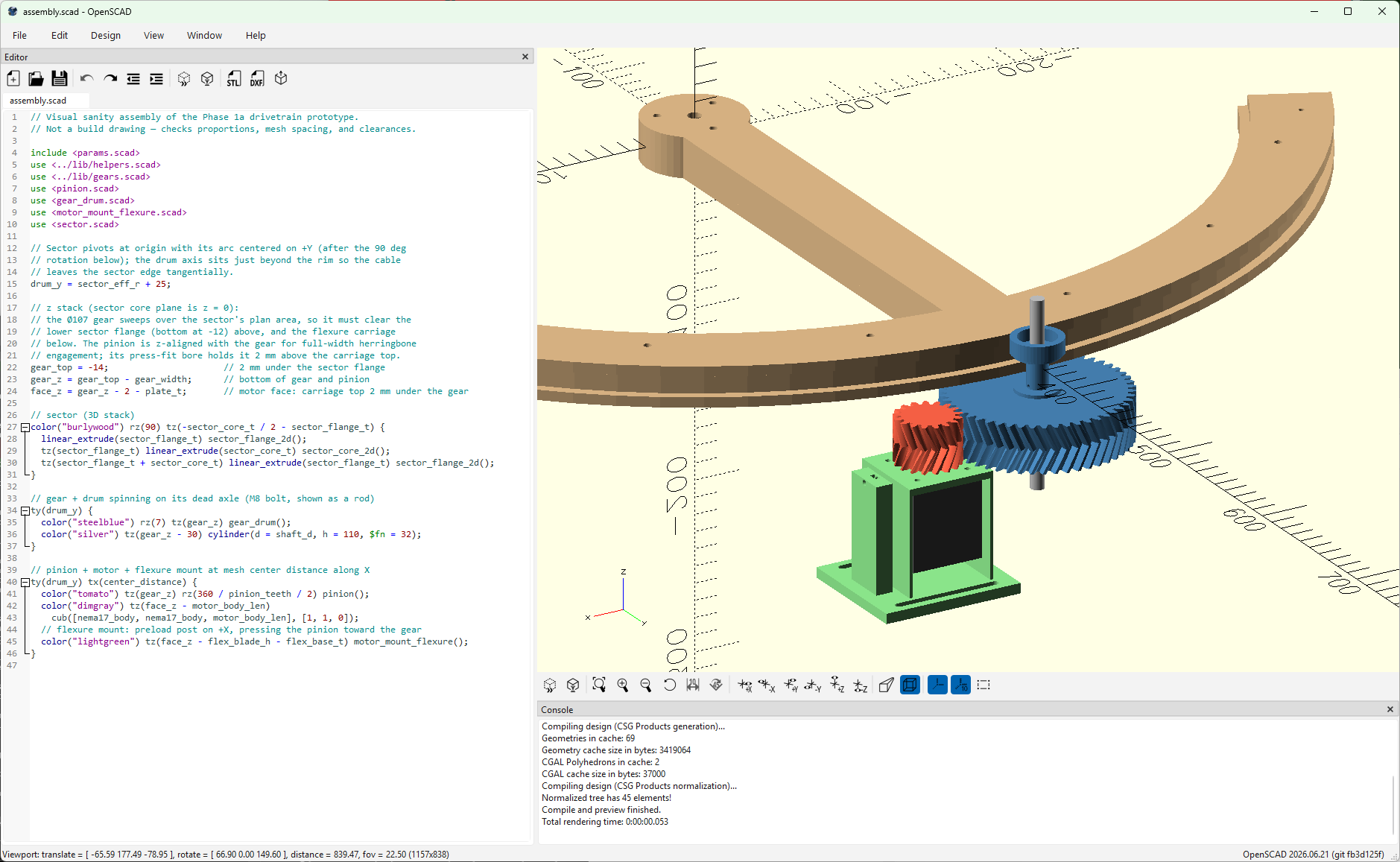

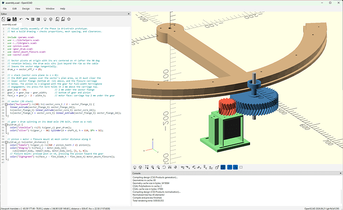

So now AI is generating OpenSCAD for me :exploding_head:
I did not write any of this (but I did have to notice some mistakes and tell it to fix).
Was that supposed to have an additional herringbone gear set on the upper part?
Looks like a telescope positioner…
Lower part is a gear and upper part is a capstan, so total gear ratio is 150:1. There will be position feedback so if the capstan loses position (inevitable) it’s okay.

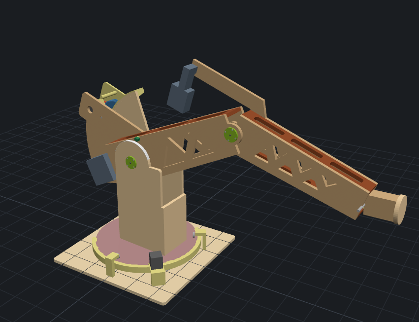

I’m looking at a plywood robot arm by the way
(This is still an early draft)
Needs 4 capstan robot legs. Keep vibing!

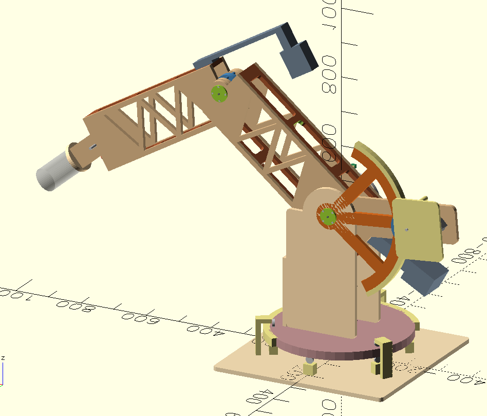

Fable had proposed this:
And here it is, calculating loads and stuff, to explore the parameter space and tradeoffs.
I am just beside myself, this is so ridiculous.

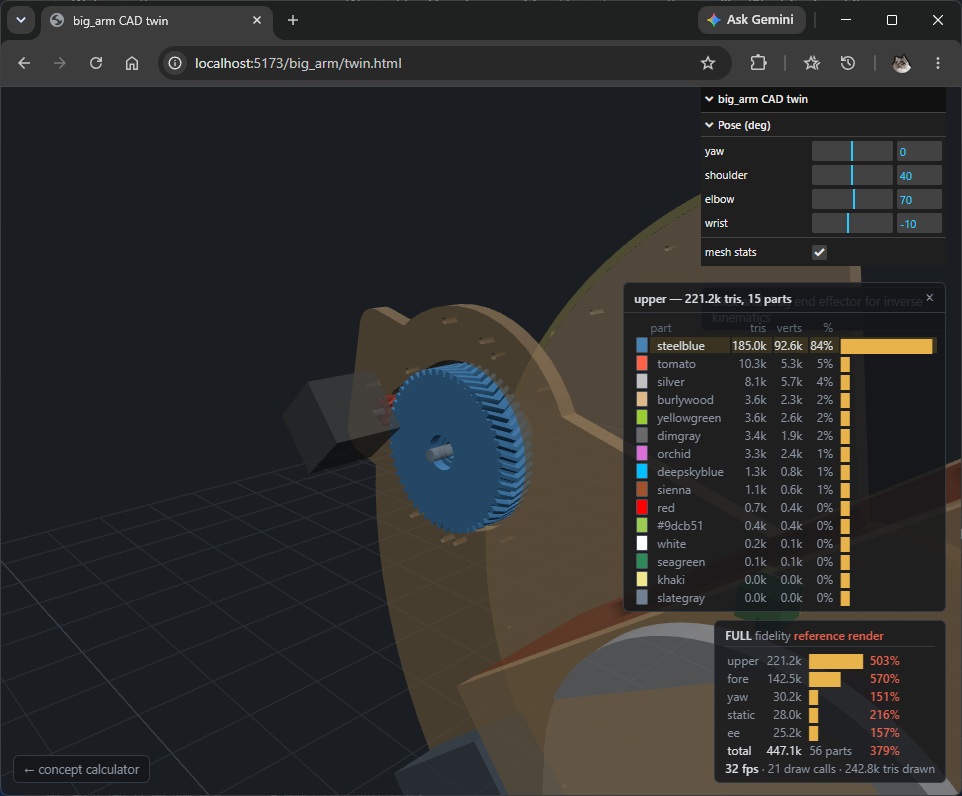

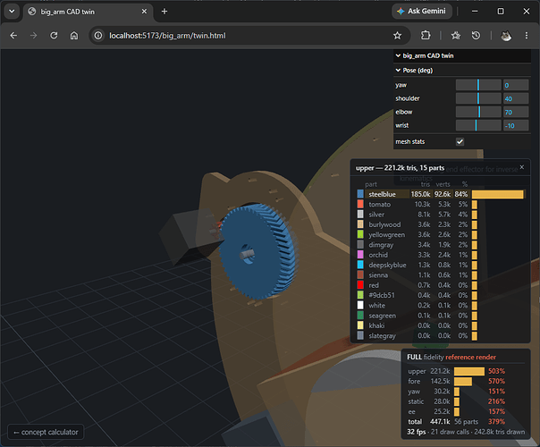

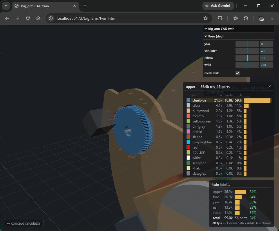

Yo @jamiek ! Dug around, like what you’re doing. Tried to contribute and shared pull request adding mesh stats (opus 4.8 extra high) before code radically evolved, too late already?
Let me know if you want more context about the mesh stats windows that auto zooms on selected part.
BEFORE 447k triangles :
AFTER 99k :
LGTM
PR #1 — “Make the twin cheap to draw, and keep it that way” (aaronse)
Verdict: solid work, merge-ready from my side. I fetched the branch and verified it rather than just reading it — details below.
What it does
  • Adds a $twin special variable (params.scad, default false) that coarsens tessellation on manufacturing-only features — the capstan groove sweep drops from 60 hull segments per turn to 8, herringbone involute sampling from 10 steps to 3, and various $fn values halve. Only export.scad sets twin = true, so print/cut exports are untouched. Using a -variable is the right call: it reaches lib/capstan.scad and lib/gears.scad through dynamic scoping without those libs needing to include params.scad.
  • export-cad.mjs now parses OpenSCAD’s --summary geometry output, enforces per-body triangle budgets (non-zero exit when blown), writes a stats.json next to the meshes, and gains npm run export:cad:full for a full-fidelity comparison render that’s allowed to overrun.
  • The viewer gets a mesh-stats HUD (toggle in the pose panel, or ?stats=1): triangles per body against budget, live FPS/draw calls, and a per-part overlay where clicking a part isolates it and flies the camera to it. It also fixes a latent nit — gui.onChange was firing setPose for every GUI change, now scoped to the pose folder only.
What I verified
  • The branch is current with main — merge-base equals your HEAD; aaronse already merged your shared capstan-cutter commit and re-baselined the budgets for the third drive.
  • The budget gate passes: export renders 140,800 triangles total, every body sitting at 83–87% of its ceiling — consistent with the stated “~20% headroom” policy, and matching the README’s 140k claim.
  • tsc --noEmit passes and all 23 unit tests pass.
  • The code reads like your repo — comment voice, helper idioms, and the part() color-as-semantics convention are all respected.
Things worth knowing before merging
  1. I verified numbers, not pixels. The capstan groove at twin fidelity is 8 hulls/turn of an octagon (down from 60/24) — the README claims “no visible difference,” but I haven’t eyeballed it. Worth one spin of the viewer (or npm run export:cad:full + compare) before taking that at face value.
  2. The “CI fails on the commit that caused it” comment oversells slightly: your only workflow is the manually-dispatched Pages deploy. The gate runs there, but nothing runs export:cad on PRs or pushes, so a budget blowout surfaces at deploy time, not commit time. A small PR-triggered workflow would make the comment true.
  3. The budgets are hard-coded in the script with a “ratchet down deliberately” policy — fine, just a convention to maintain.
  4. Minor: #ik-hint’s CSS top is hand-adjusted from 172px to 200px to account for the new switch row — it’ll need touching again if the panel grows.
The PR body’s “447k → 99k” numbers are from before your third drive landed; the post-merge reality is 616k → 140k, which the README states correctly.
