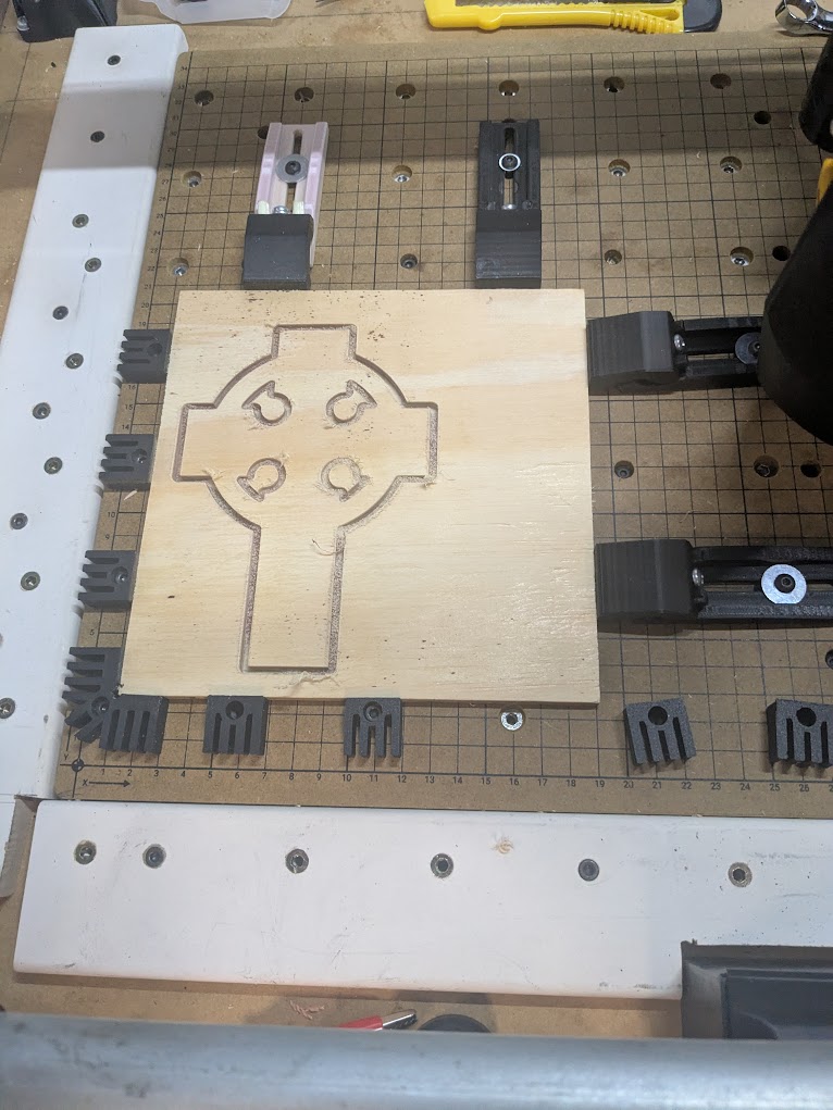

After 9 years, I finally got my first successful carve

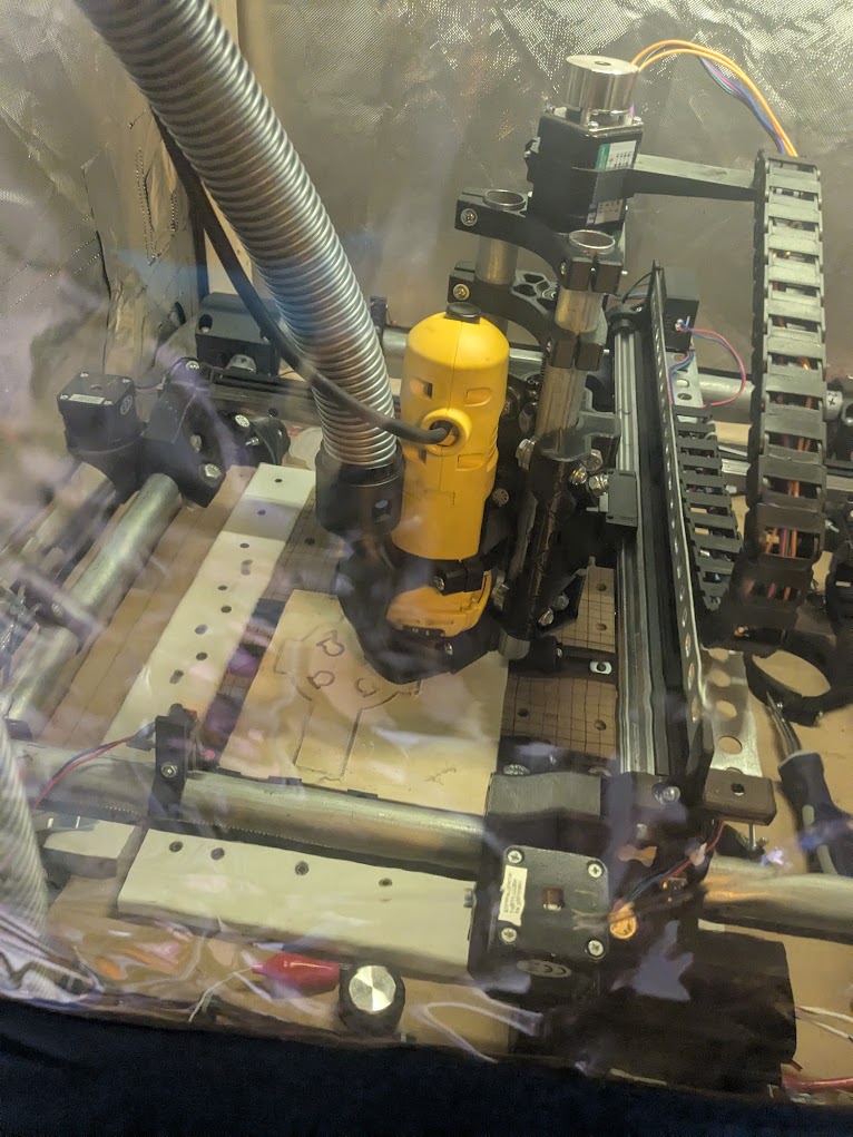

I started building a Burley in my garage in 2016. I lost interest for a couple years, by which point it had totally rusted. I printed, then reprinted a Primo in my laundry room over the last half-decade. After swapping the X and Y conduit for linear rails and adding a braking motor on the z-axis, the final hurdle was setting the Vref on z-axis too HIGH, which caused my Z to lose steps and gave my poor spoilboard a good beating. I still have to cut out the final layer, but I’m ready to cut some more stuff out now that was able to clear this big hurdle.
