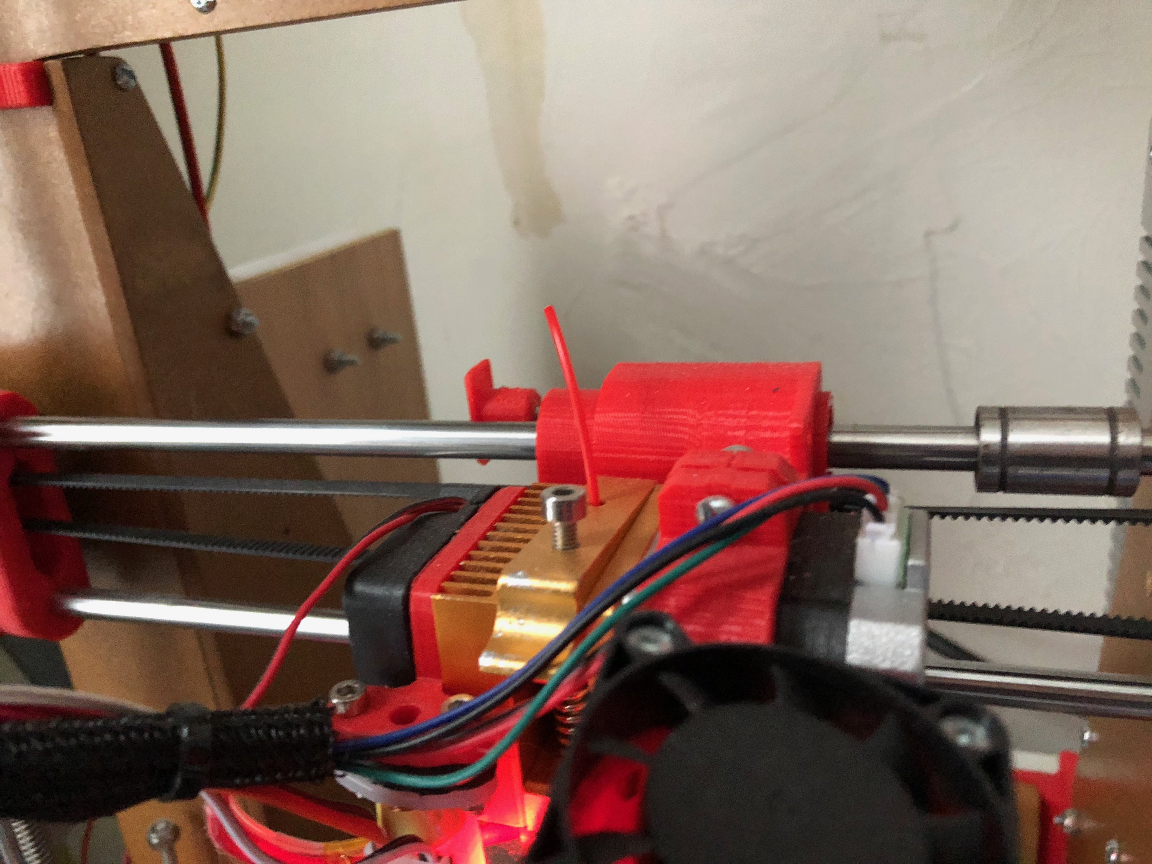

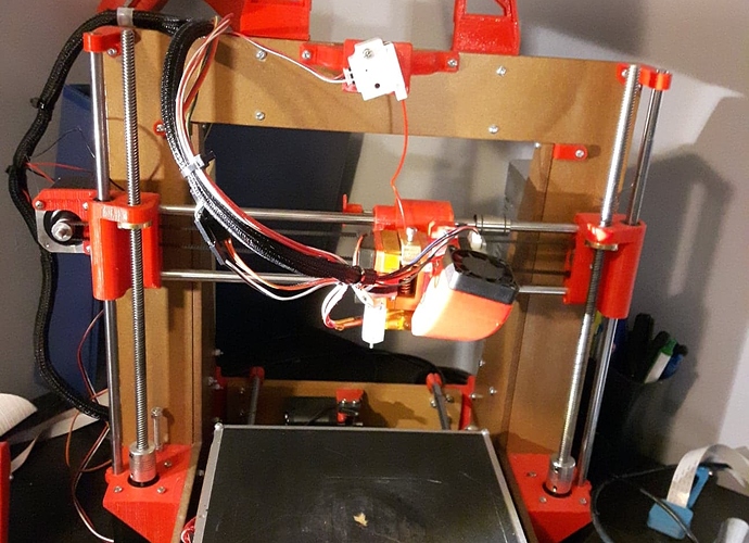

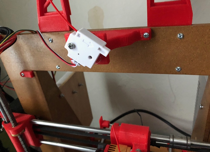

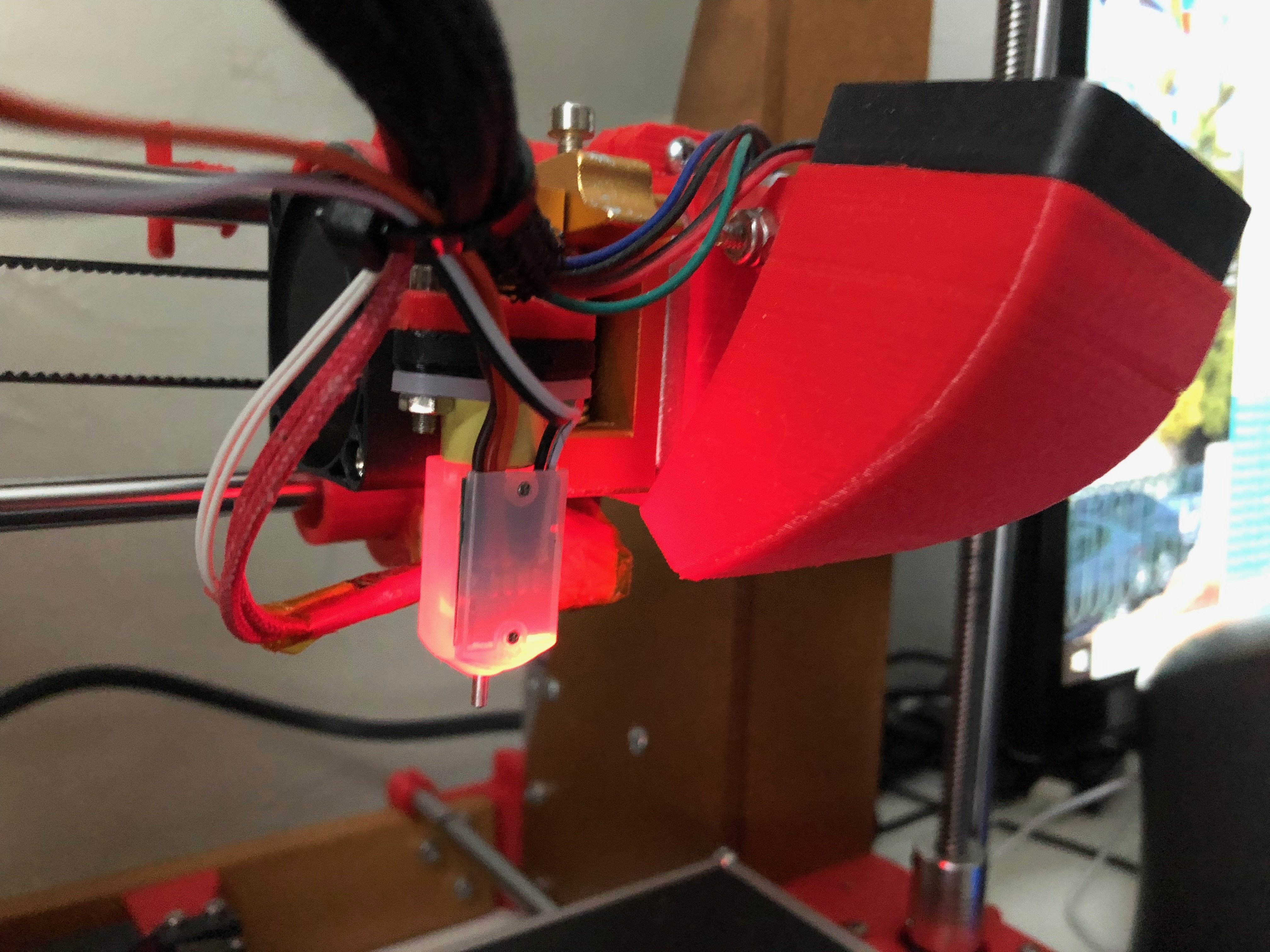

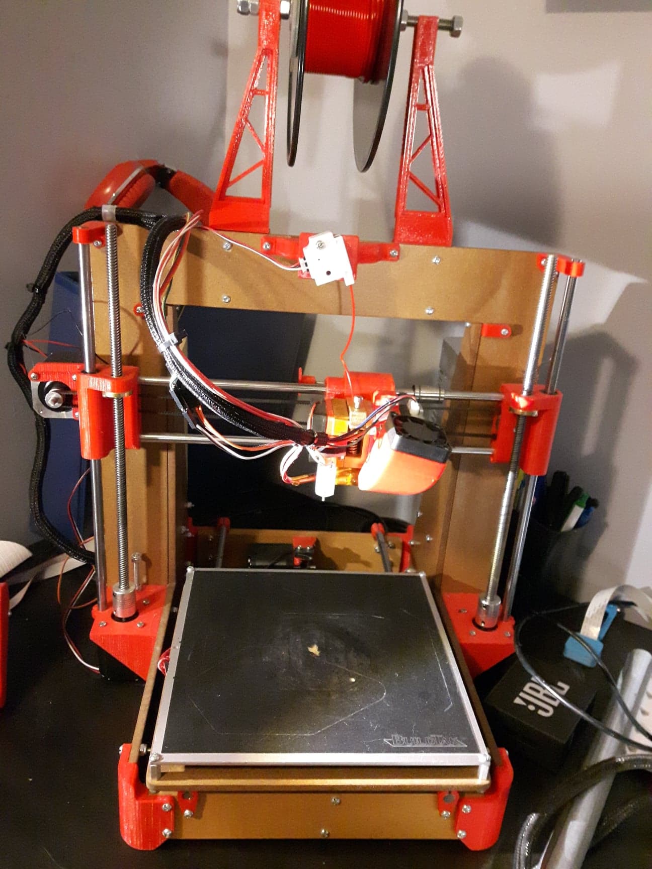

Here’s a first picture, will have more tomorrow :slight_smile:

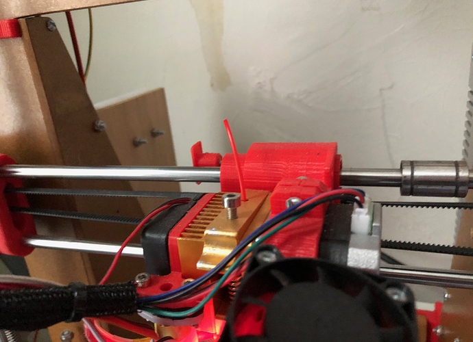

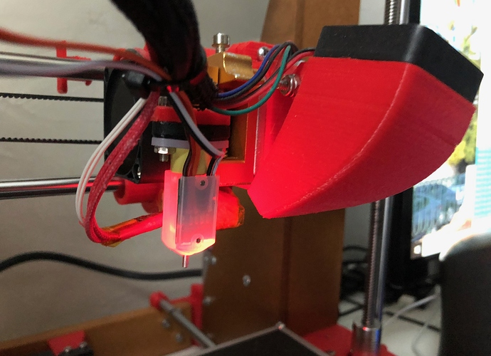

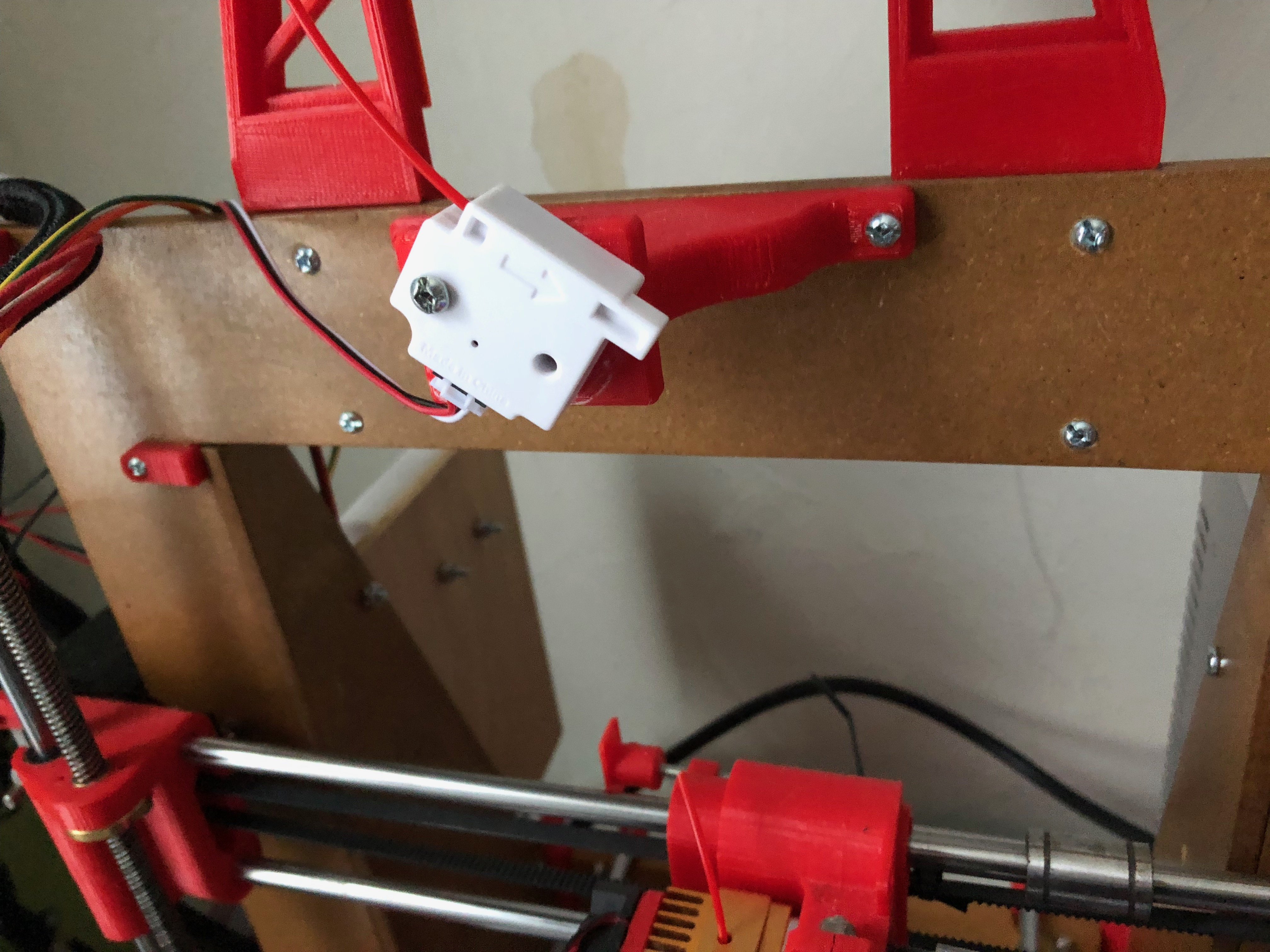

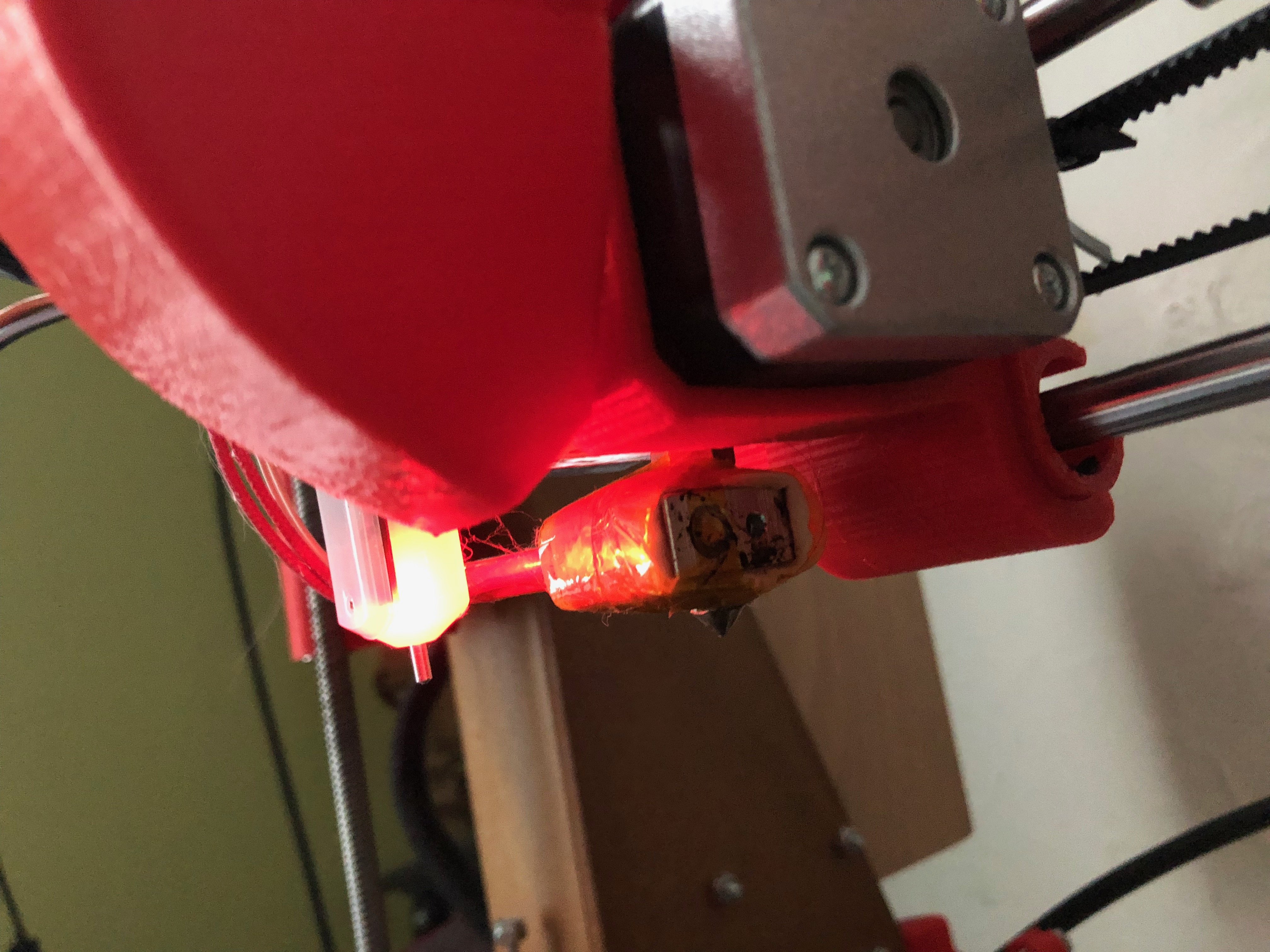

That is a nice printer. Bltouch, filament runout sensor, Mk8 extruder, custom bracket for the filament.

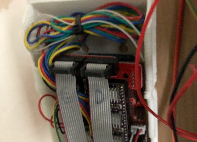

It’s a version 1 of the mp3dp. Please also take a photo of the controller. You’ll also want to know what filament you have, or just order something of known quantity.
This is going to be a challenge, to give you the info you need. But it will be fun. I hope you’re ready on your side, because information is going to come like a firehose.
I agree that is a nice machine. I also noticed the Build TAK on the bed. Nice.

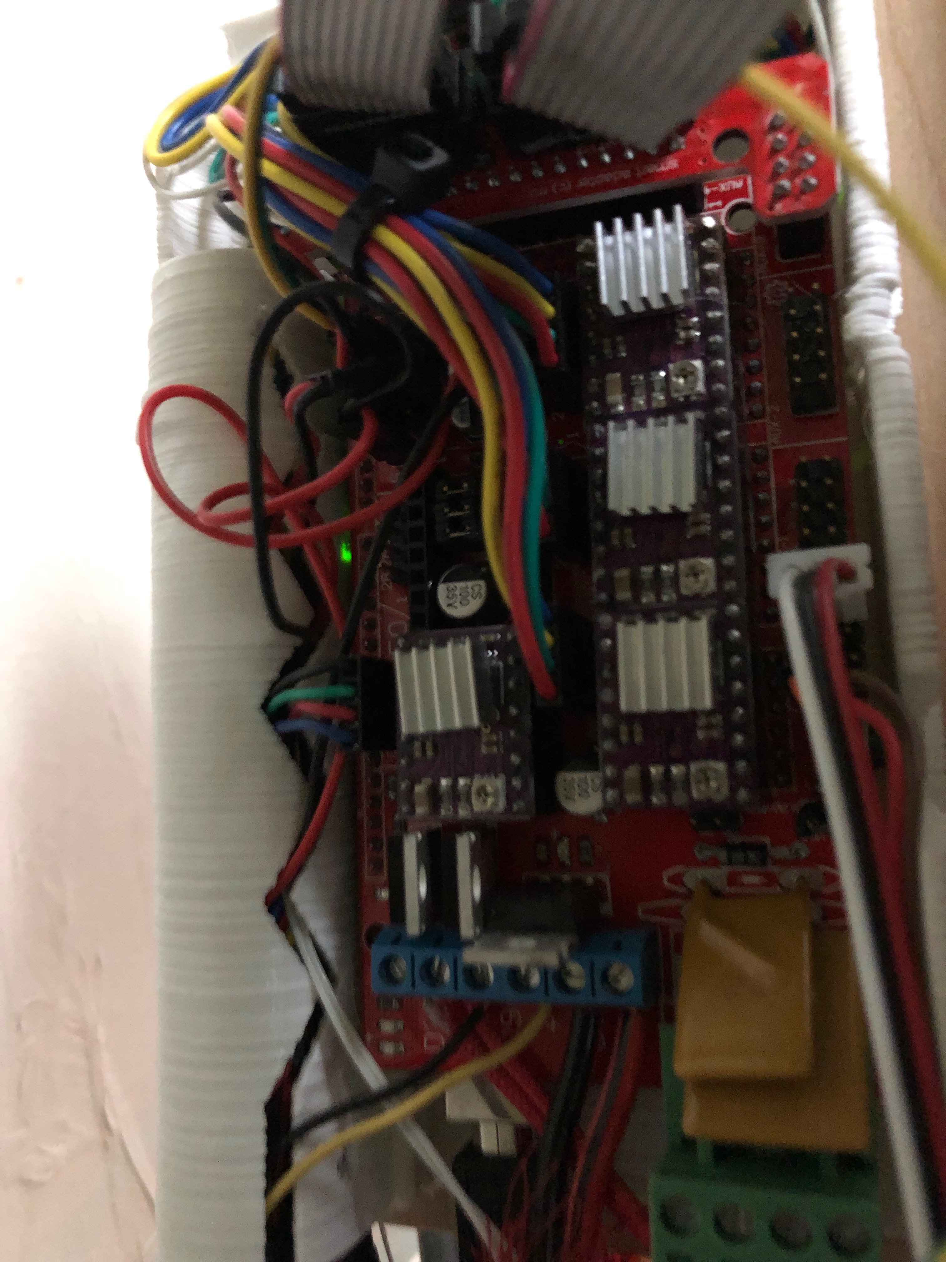

The controller Jeffeb3 mentioned is the large circuit board that all the wires plug into. We want to know what Brand, type, version you have so we can give useful advice and instructions.

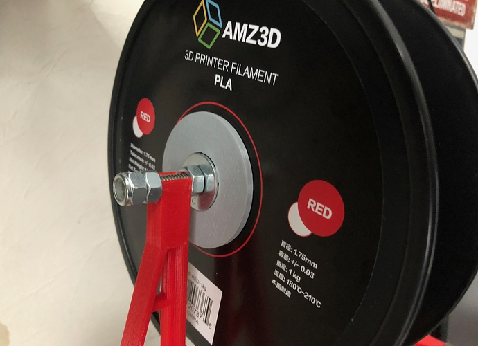

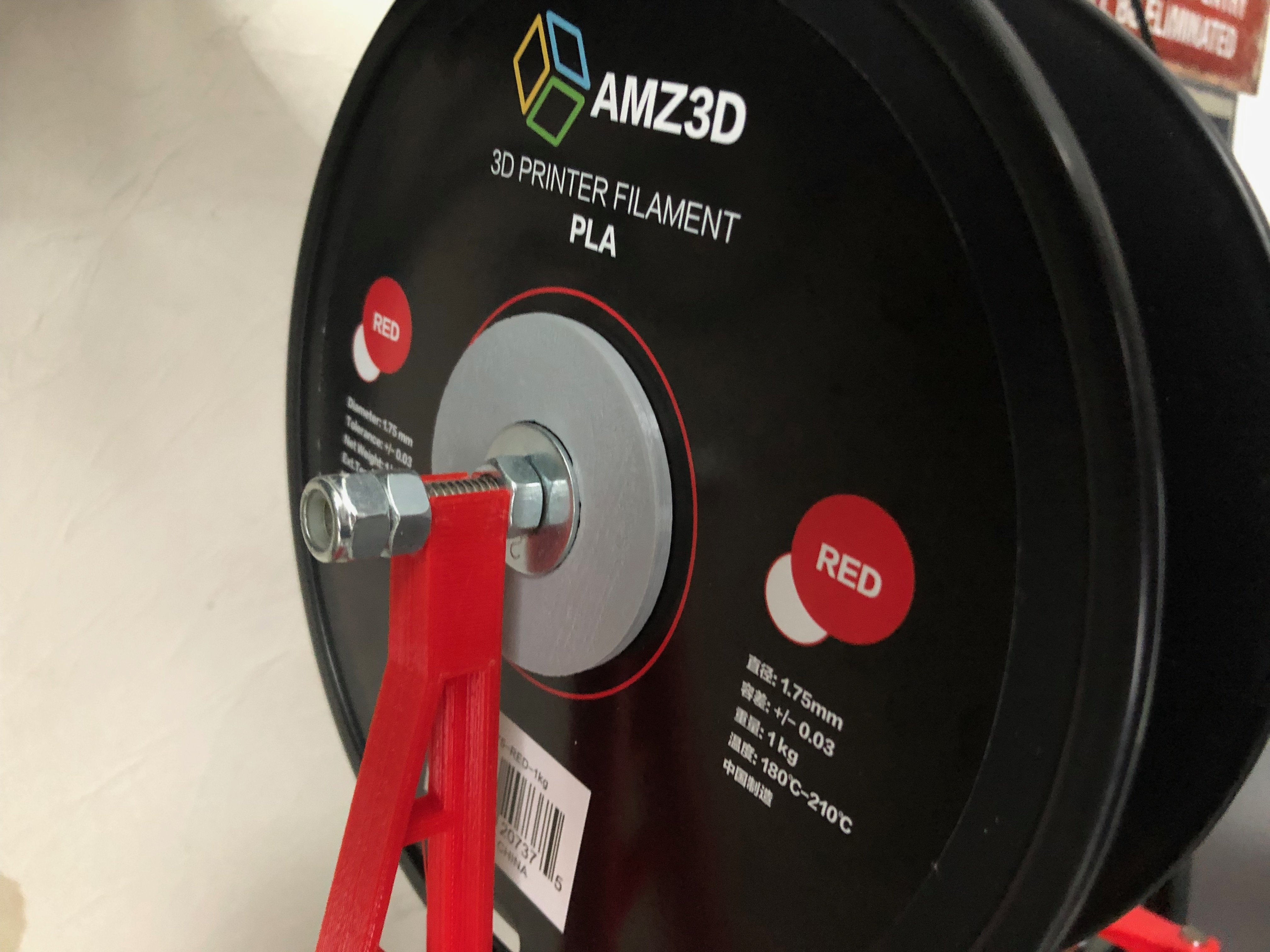

The filament you have there looks like PLA to me. Normally you can’t tell from looks but PLA is the only filament that I know of that gets brittle and snaps when it is left to sit for a period of time. If that filament is easy to break with your fingers then you will want to just throw it away and buy some new filament like Jeffeb3 said. Word of advice. Pay attention to brands. It makes a big difference. The cheapest filament you can buy will usually give you the worst results and make for a bad experience. I have been slowly switching my filaments to Prusament where possible. They are usually About $25 a spool and they aim for top quality and consistent diameter. There are a lot of good brands though. Just read user reviews.
Fun note for anyone interested. If you are not sure if a filament is PLA or ABS you can light it on fire. ABS will burn dirty, smokey and drip black molten fire balls. PLA will burn cleaner and smell like something organic almost like a corn smell. I have no idea what PETG burns like. Hmmmmm. If you read about a residential fire in Colorado that might be me. :slight_smile:

Here all the pictures I have taken and some info I found.

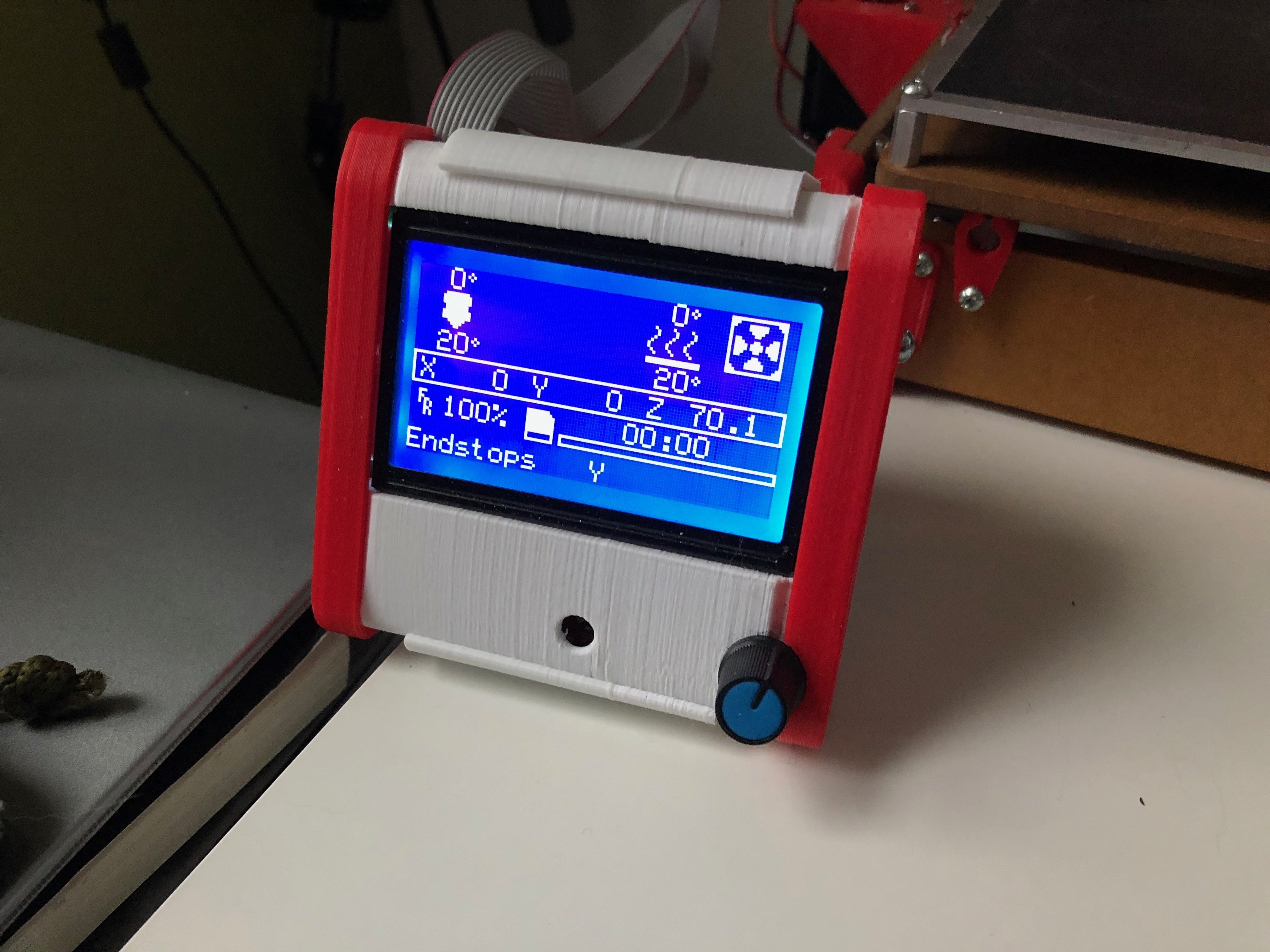

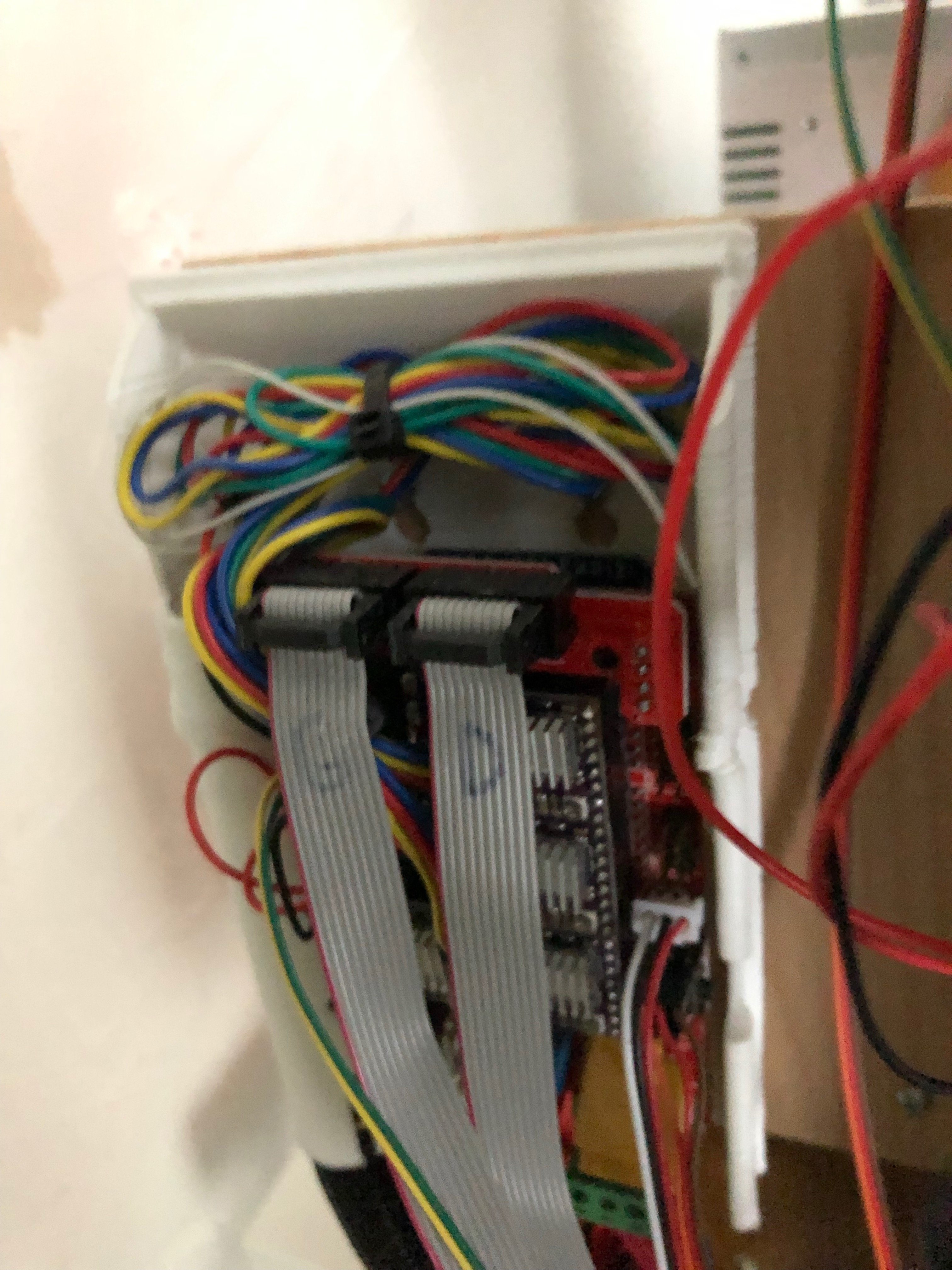

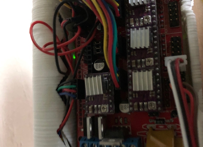

I think the board is a Rambo something, not sure… The small display is a Marlin something…
I saw that my dad was using Repetier to drive the printer. He had a config for Slic3r and Cura, not sure which one he used. I know that he had a tool or a sensor that could check at multiple position on the bed if it was leveled and adapt the Gcode to make it work.

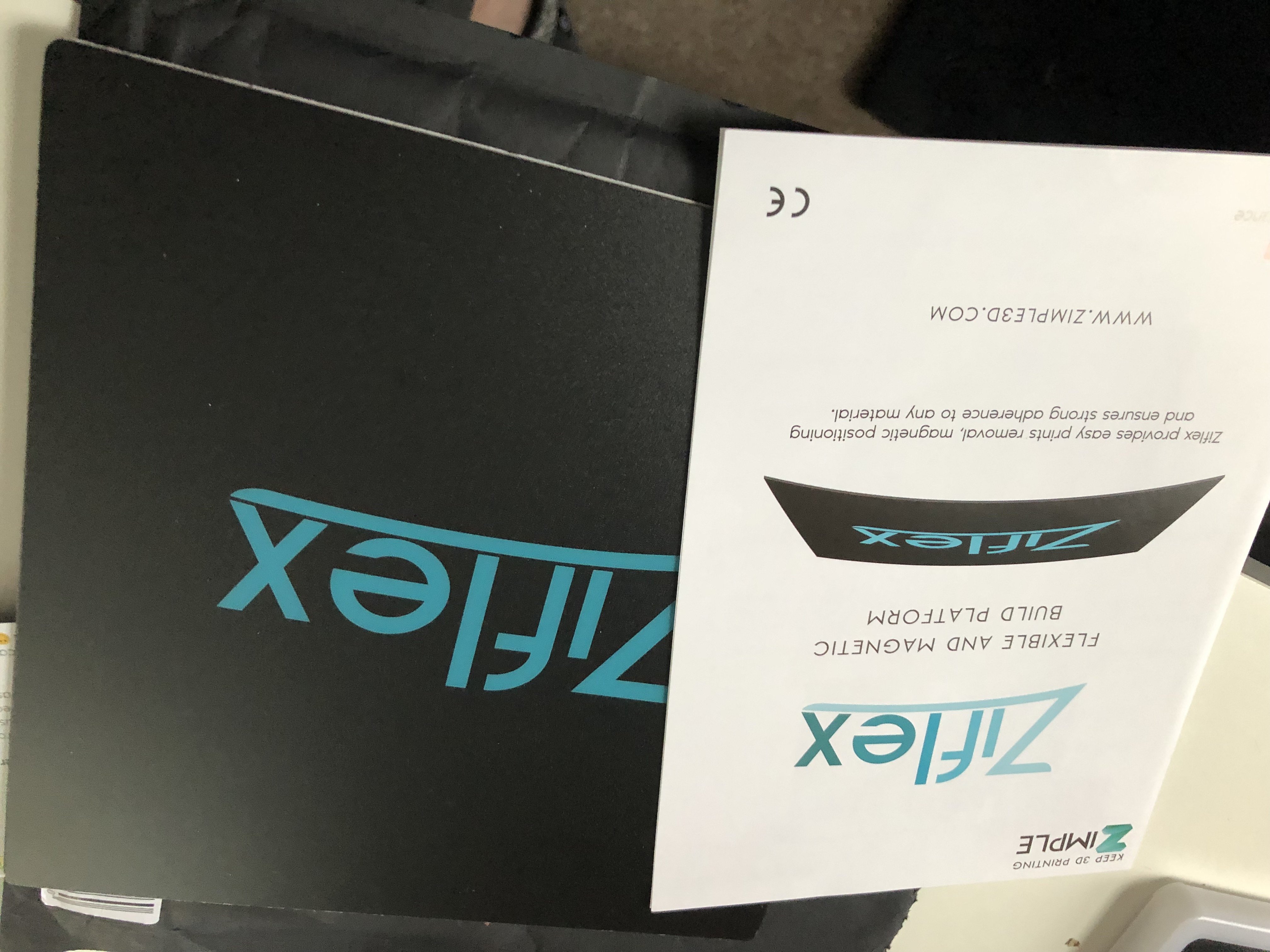

Also, he received that Ziflex thing, I think it goes on the bed to make it easier to remove printed pieces. Don’t know if it work with the heated bed though.

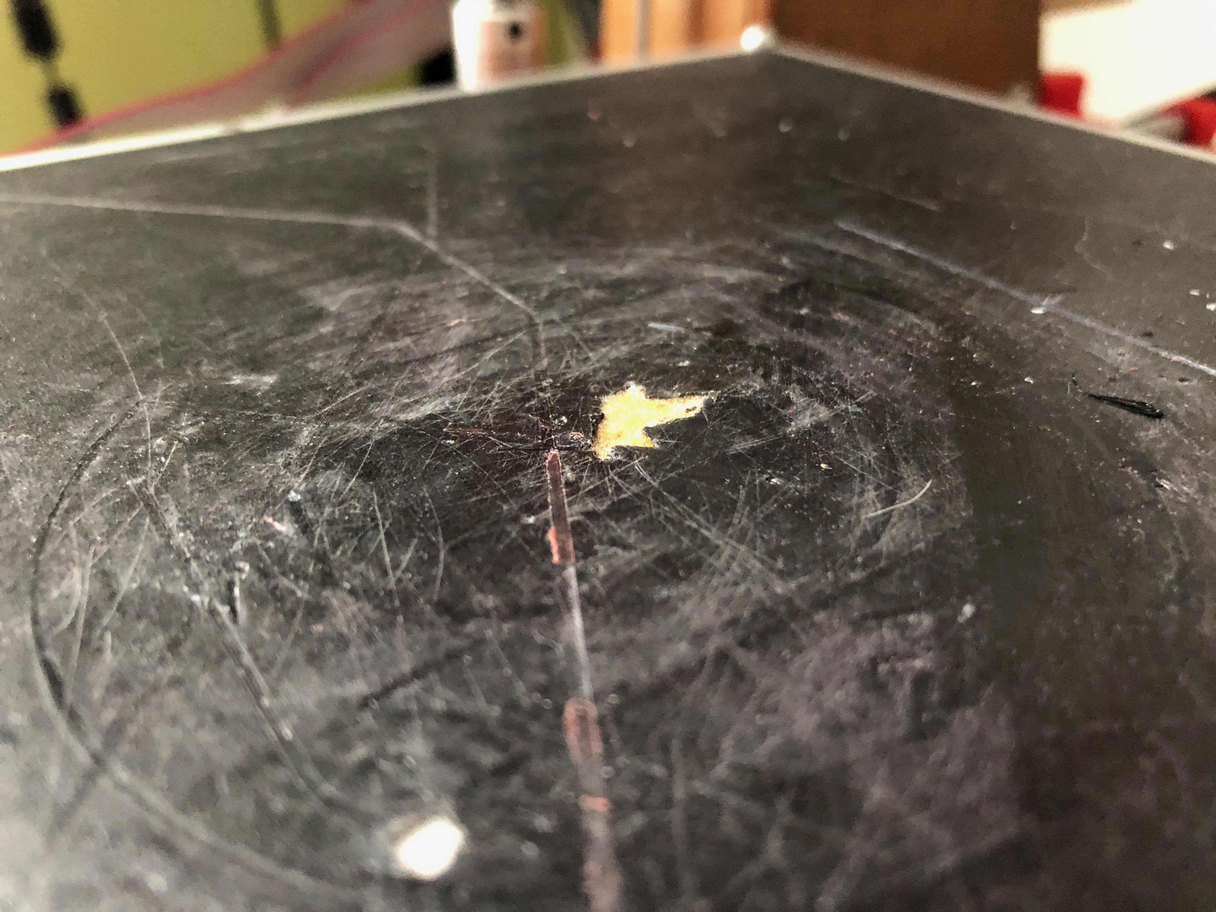

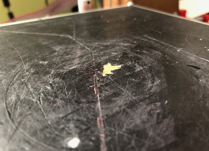

In one of the pictures, I took the bed pretty up close to show that the bed is damaged there… I don’t know if that can cause any trouble and how to fix it.

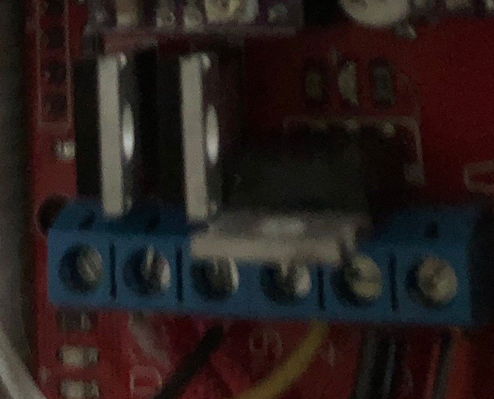

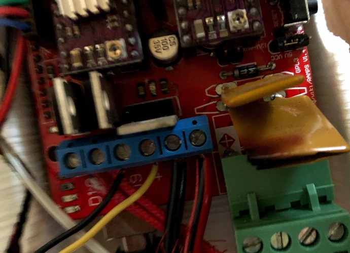

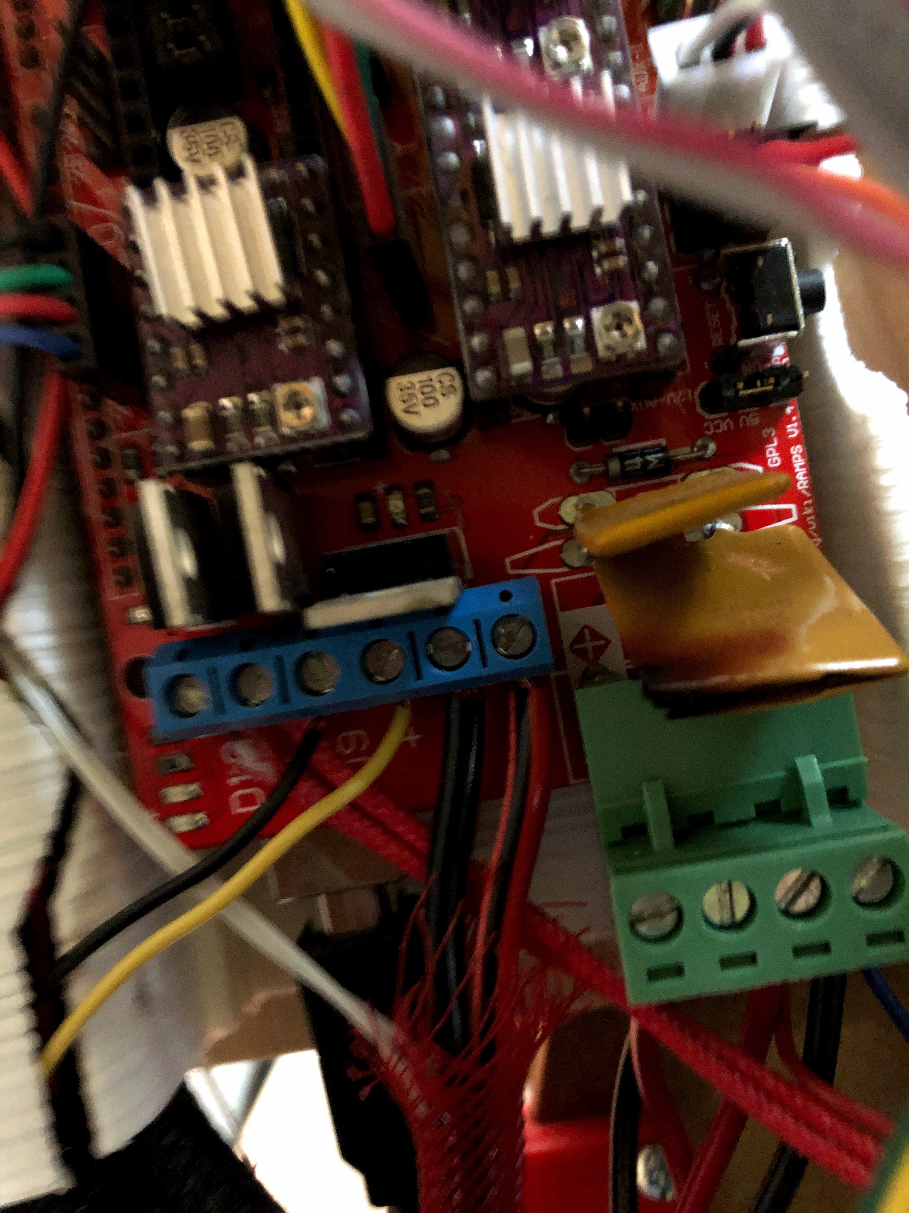

Make sure your mosfets do not touch on your ramps board, they look awfully close together!
What are mosfets?
Thanks
[attachment file=84705]
These guys. If the silver back parts touch, something will smoke. I thought the same thing.
Ok so I moved them apart so they would touch, but one of the two brown things began to smoke anyway… Is it just dead? :frowning:
Yup, that one is toast, and not the tasty kind. :frowning:
Looks like you dad put a fair amount of efort in to get the best printer he could out of this design. The level sensor is either a BLTouch or a clone. If the black stuff on the bed is magnetic then you just put the nice clean surface on and print there. Verify first none of the bad stuff sticks up at all. If the magnetic surface is actually two pieces, the magnet and the print surface, you’ll want to peel the other stuff off before installing. You don’t want to try printing directly on the current surface, those rips will just be a headache.
Oh, bummer. Those are fuses. So something must have shorted. It would be nice to know what shorted to cause that. I think touching mosfets would do that, but did it smoke after you separated them?
You’ve got a few options. You could buy a ramps 1.4 board, which would be the easiest. You can keep the wiring the same and the software on the arduino will stay.
You could also try a mini rambo, which is more tolerant to things like this. But you’d need to flash the right software for things like thw bltouch and filament sensor. More complicated, but you’ll learn a lot and you’ll end up with a good sense of the printer. Definitely more work though.
This I a quick video that shows how that Ziflex should be used.
That layer on your print bed right now could be part of this Ziflex or it could be the old build tak that got damaged so he was going to replace it with the Ziflex.

So I ordered another ramps 1.4 board, will replace this tonight and I will make sure nothing touches !
It started smoking when it was heating up the bed so I didn’t have the chance to print anything. I’m pretty excited!
Will update you on how it goes!
